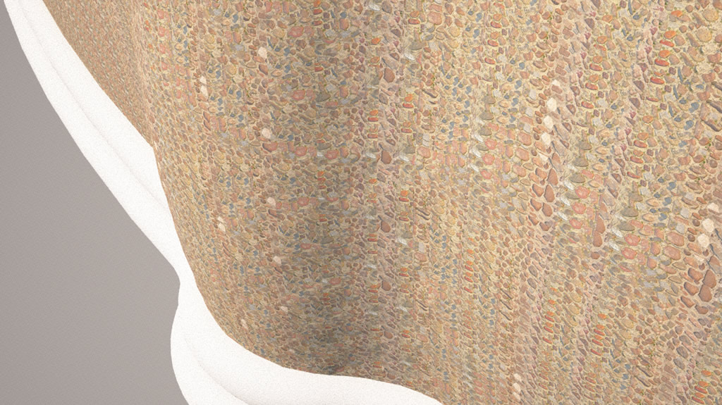

Does Indigo RT support Bump maps and Displacement?
Post by Coen Naninck » Tue Apr 03, 2012 2:33 am
Attached is an image rendered with Indigo RT with a material loaded from the Material Library from this site but I don't see any bump or displacement in the image. When I preview the material in the Material Editor render view in SketchUp I do see these features work, but not in my render. Does RT not support these features?

Coen Naninck wrote:Attached is an image rendered with Indigo RT with a material loaded from the Material Library from this site but I don't see any bump or displacement in the image. When I preview the material in the Material Editor render view in SketchUp I do see these features work, but not in my render. Does RT not support these features?
This issue is simply related to your scene (export) size, double check it to have real world values!
If your object is 5km big a bump & displacement of 1cm will not be visible ;)

Hi, thanks for replying. The curve you see in the image is approx. 80 cm wide and 180 cm high.

does your mesh have enogh polys to be displaced? Displacement shifts existing polys, but don't create any!
You need to subdiv your mesh by hand, or use Indigos subdiv feature to do so.
Otherwise simply raise the displacement / bump value for the material until you have a propper result :)

Zom-B wrote:does your mesh have enogh polys to be displaced? Displacement shifts existing polys, but don't create any!
How many do I need? I've tried this on a 6 sides (12 polygons or 6 SketchUp Faces) cube, subdivided it also a number of times, in both cases no luck. I have also created a curved surface of thousands of polygons and same result.

Never mind, I figured it out. Cranked up the value in the SkIndigo Material Editor from 0.01 to 0.15 for Bump and 0.05 for Displacement. That had an effect.

Your lighting setup also doesn't really lend itself to showing off the surface texture of your object. If you had more directional lighting, you would probably pick up the bump mapping a bit better.
