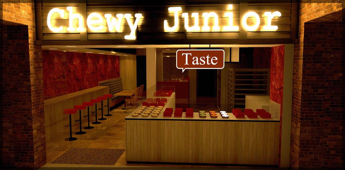

I am half way through rendering internal shots for a dougnut shop but cannot seem to work out how to create actual 'light streak paths' coming out of ceiling lights! Yes, light comes out but how can I actually see some kind of faded light cone...... it would really add to the drawing I'm producing!
I've tried all kinds of techniques including adding ies profiles but it hasn't done the trick! Any ideas? Or is this not possible in indigo yet?
Many thanks in advance!
PS. I'd also be grateful for any other ideas to improve the image!
Noel
