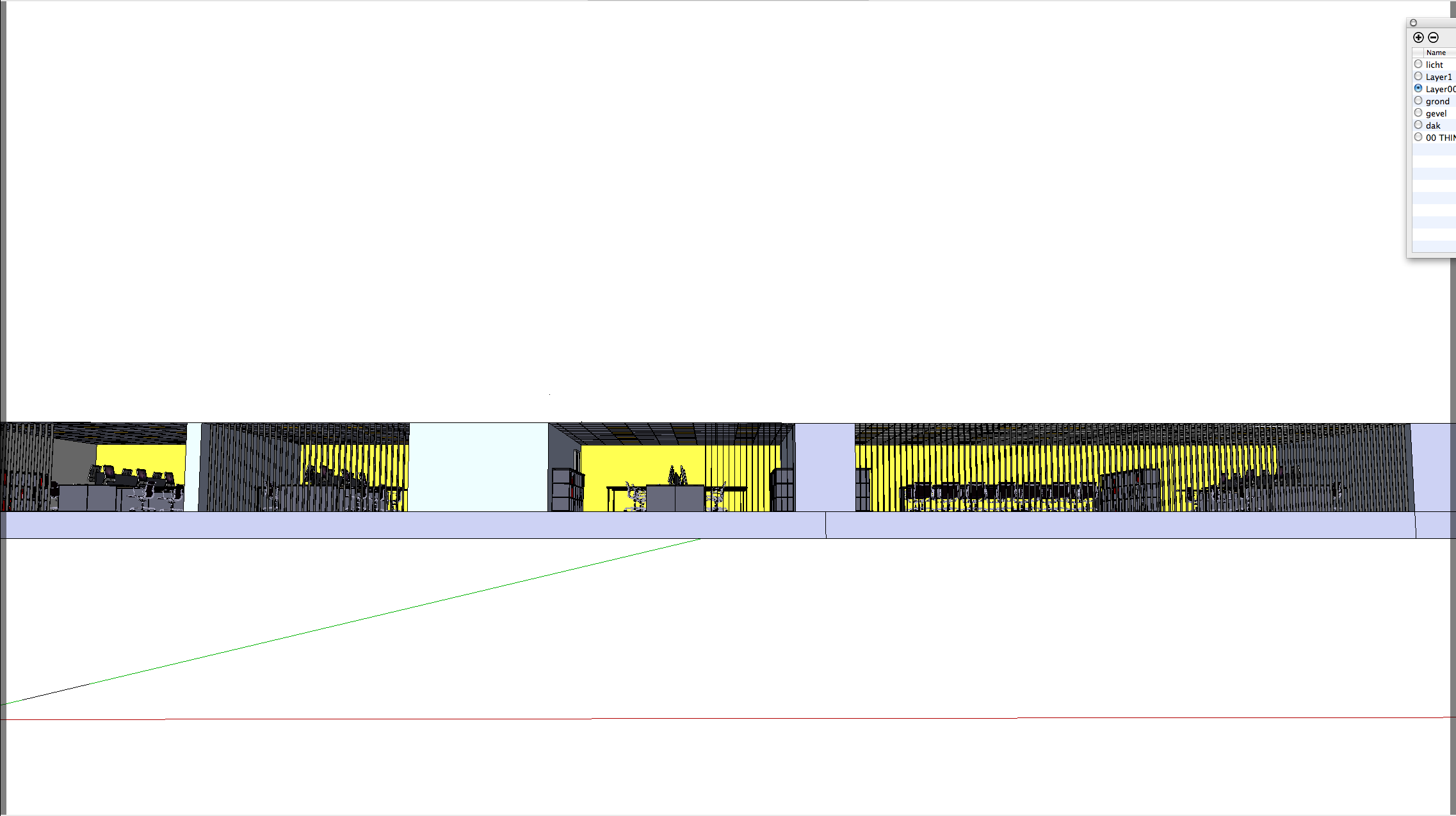

Thanks for the help guys but to be fair kind of got another big issue now, i mean my boss has just bought a new power p.c today so the rendering ain't a problem anymore, setting the scene is starting to cause me some trouble, i use sketchup to model it as its a fairly simple scene so didn't need too much work, dosn't have all too much detail in either, but anyway the angle has to be perfect and i literally can't get anything to work to set the scene up, with the image being so long. yet the hieght only needing to be 2333.9mm (lenght is 41700) when i try to set it up i either have to completly distort the angle or loose crazy amount of resolution because of the excess space in the scene ( both of these are not an option ), I tryed the render region button, as soon as i got to put in the desired res, it seems to work fine but then never produces a render, just constantly says "updating image" in the top corner. I've also tryed to highlight the model, and render section only and as soon as i change the resoultion i get the same problem, any advice would litterly save my life!
(also attached an early shot of the model just to show the angle i need and the dead space.)
Should i post this in skindigo section? :S
Thanks - john
Thanks - john

If you need a more "orthographic" view, you can make the photographic objective of indigo's virtual camera longer by changing the "lens_sensor_dist" value in the .igs-file. Not sure if the name is 100% correct as I am at work right now, without indigo. A value of about 0.7 is already pretty orthographic, depending on your scale probably. Just open the .igs-file in a text editor, search for the value and change it, then start indigo and open the file with it.
Not sure if that solves your problem, but the image should be less distorted perspectively.
Good luck!
Good luck!

When you use Region Render, make sure to zoom out in Indigo so you can see your whole image. It could be that you're just seeing black because you're zoomed in on a region that's not being rendered...
As far as your composition issue, that just sounds like making your model fill up the aspect ratio of the image. The size in mm doesn't matter, just the ratio between the two lengths. Similar to what Polinalkrimizei suggested, back up the camera by a LOT and zoom in with the lens for a more orthographic shot.

I don't know if this is part of your problem, but you can change the angle of view in Sketchup with the zoom tool and pressing the shift button (this influences the perspective of the displayed model).
