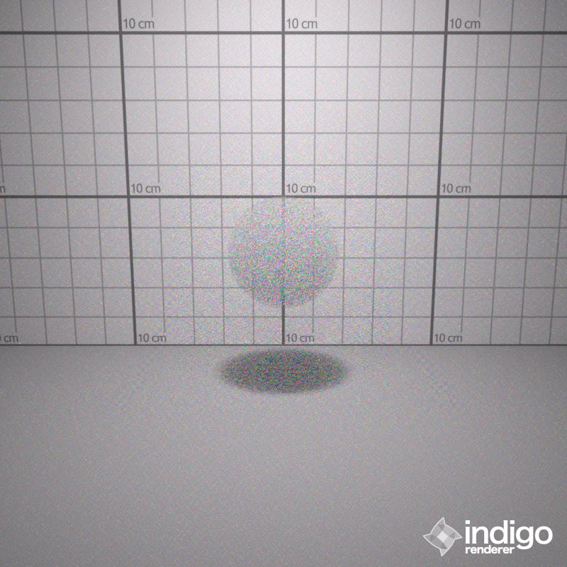

Iv tried everything but I cannot reproduce this material:
This images were taken from this thread: http://www.indigorenderer.com/forum/vie ... 8&start=17, posted by OnoSendai.
As I said in this threads:
http://www.indigorenderer.com/forum/vie ... =5&t=10280
http://www.indigorenderer.com/forum/vie ... 11&t=10286
When specular SSS material is outside light mesh, you have to use MLT and it takes a lot of time to render.
But it doesn't seem to be the case with those images.
Seems that it only works with ISL that defines SSS values for positions inside larger mesh object.
But I don't know ISL and didn't find a manual to learn, is there any reference for ISL?
It doesn't work with objects? It is not the same to have a sphere defined by a mesh, or a sphere defined by ISL inside an object?
Conclusion: you cannot yet make cloud or smoke material from a mesh and a simple specular material?
How to make cloud material?
