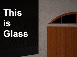

Can anyone explain to me why the glazing in my internal renders is coming out black?
I'm exporting to indigo from sketch up... I have tried reversing the faces and applying the glass texture to the front face.

I am using the material "Tinted Green Glass" from the database so that can't be a problem. I don't know how to check the thickness of my glass. It looks like its nothing because I have drawn it using the rectangle tool and have not given it any thickness. What do you mean by a fully closed volume. If you mean that it is an enclosed fully drawn shape then yes it is. I have colored both side using the entity info option in sketchup.
Thanks.
Thats my problem.

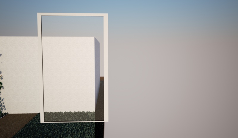

Thanks everyone. Sorted it out. :) I needed to add thickness to the glass.
It worked!

For most of the architectural visualizations (read: the simplest ones) you can speed up rendering using thin glass (one of the SkIndigo mat presets), which can be applied to a simple surface, not a volume. You won't generate caustics, but normal windows hardly do that, usually. When using Thin Glass the SU mat slider will tell indigo How REFLECTIVE is you glass: values near to 0 will render as slightly reflective glass, vales near 100 will render with more reflective glass. Try 40 for a "common" glass. :wink:
