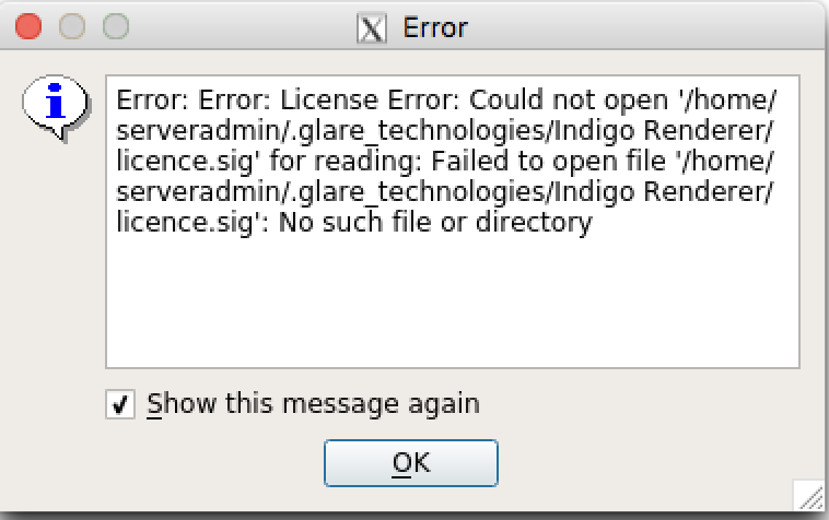

License Error: Could not open '/home/serveradmin/.glare_technologies/Indigo Renderer/licence.sig' for reading: Failed to open file '/home/serveradmin/.glare_technologies/Indigo Renderer/licence.sig': No such file or directoryIndigo Renderer v4.2.15, Linux 64-bit build.
Licence not verified, running in free mode.
Scene file path: '/home/serveradmin/.glare_technologies/Indigo Renderer/cache/client_network_cache/4494168381935407516.igs'
env illuminance lookup tables took 0.03949999809265137 s
As I mentioned, I'm also getting the same message in the indigo GUI when I start the network slave, however its continues to work.

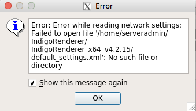

Also note, that I'm getting an error message when opening Indigo GUI
However, the indigo works and it even remembers the network settings (e.g. network manager IP).
