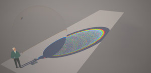

Yes it's what I tried, 4967967 spherical water droplets on aproximately 0 to 50m height, cauchy b coeff 0.003, but I get no rainbow. And a box of sss to do some fog, I tried uniform and RGB. I'm using path tracing with MLT I don't know if it's correct to have a rainbow effect

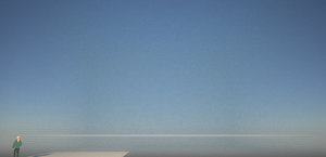

For now I made several tests, with various settings such as cauchy b coeff between 0.0013 to 0.003 even some to0.1,0.5, or 1; and IOR 1.3, with and without scattering with water spheres approximately 1mm diameter, in spaces from 5m cubic to 200m cubic, seen from far, seen from near, or seen from inside; with FOV from 20° to 88°, the sun respecting the limit of not above 42° up the ground and coming from the back. I tried with SS box fog englobing the scene, uniform and RGB, and I tried without; I tried Reinhard, I tried camera; I used, path tracing with MLT, Bidirectional path tracing with MLT, Bidirectionnal Path tracing. Nothing concluding, I must do something wrong, or maybe it's just not possible to do a rainbow;

The artefacts in the bottom of the images show that you have reached floating point precision limit. In that case, the rays cannot be calculated accurately inside the spheres. This will clearly be a limitation

In the first image it is not artefacts, it is just that I scattered the spheres on many planes since we can not scatter objects into a volume in Indigo (yet ? ) , the spheres having a water material, and the planes a null material to be invisible. So the lignes and spaces on the bottom of the image are just the spaces between scattered planes were there is no sphere
