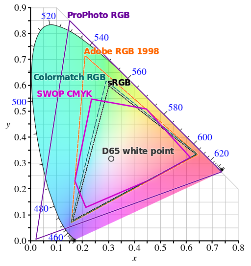

Something that I also wonder about is that White Point calibration is done before tonemapping is applied resulting in tinted images for certain profiles...
Maybe that could be controled by a ceckbox or so.

Hey, so much time are passed since this original question but it is always still open for me.
About white point it seems that it's done on the color (LAB?) share in the IGI before any tone mapping. and placed on the X and Z of the picture.
In that such a case it is clever because it is a method that can avoïd any tone mapping modifications.
It could be very interesting to have a better visualisation of the color space like this kind of :
