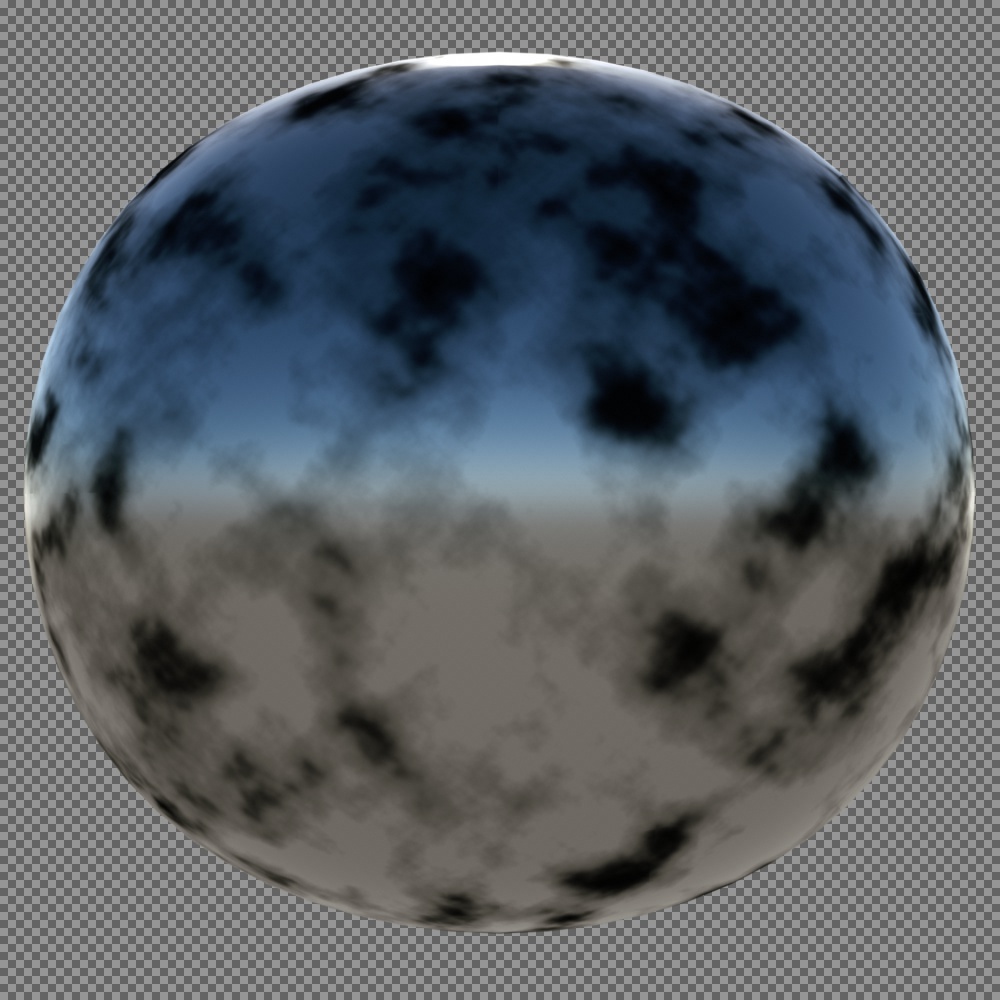

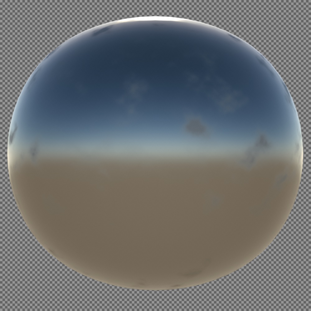

Exponent is a measure of the sharpness/glossiness of the reflection, with white being unaffected and black being totally 'blurred' (for want of a better word)
Fresnel is a reflect - Yes /No - question with white being 'yes' and black 'no'

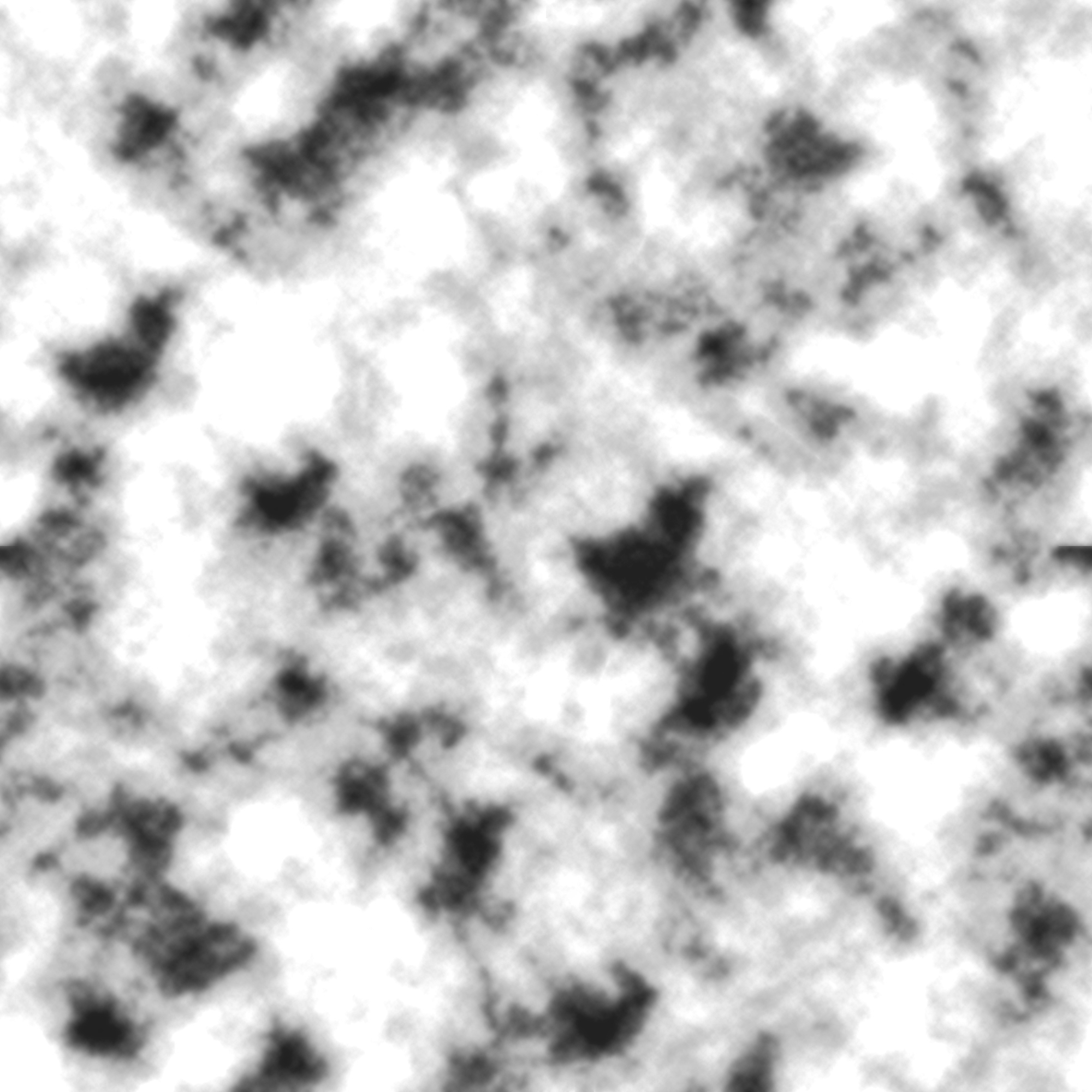

I've attached examples below of the same glossy sphere in a simple environment with all the same setting, but with the 'map' in the Exponent slot in one and in Fresnel slot in the other.
