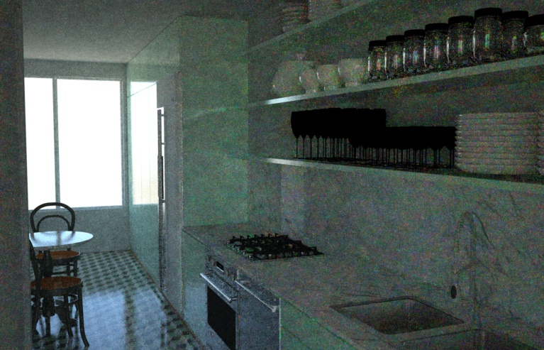

Hi, I'm having an issue with an image. all the glass objects on my scene render black.
anyone may know how to fix this?
I already checked that my objects are solids and not just faces.
Ps. Image is 767x493,TM method is linear, and using Bidirectional with MLT and glass aceleration.
Best.

I solved the problem by re-building the wine glasses and making them thicker. I guess there was something wrong on the way they were built.

this is bug
you need correct spline into Lathe - reverse sequence
http://clip2net.com/s/646UDr
http://clip2net.com/s/646OBw
Re: glass objects render black - Skindigo
Post by lycium » Fri Nov 01, 2013 6:27 am
Hi, I think this is to do with media having to be a proper volume / having thickness as DJ AntOn suggests.
Please see this page in the manual for more information: http://www.indigorenderer.com/documenta ... ling-glass

And make sure that the front of all faces are pointing outwards.
