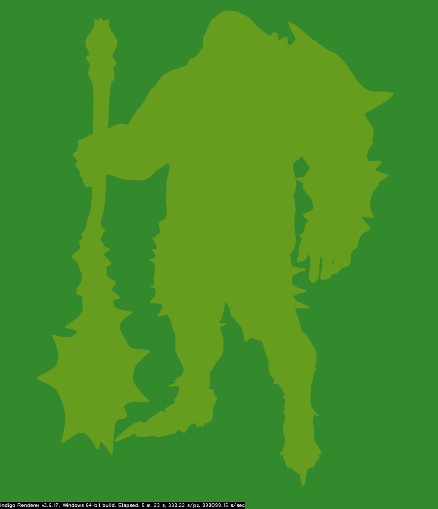

the automated color choice of Indigo is sometimes suboptimal, like in this example:
Atm Alpha renderings in Indigo always ends up with some degree of transparency in the image, the higher the SuperSampling the harder it gets to "fill up", radial sampling also helps a tiny bit here... I hope for some fix for that issue, maybe with more Render channels sometime in Indigo 4.x
