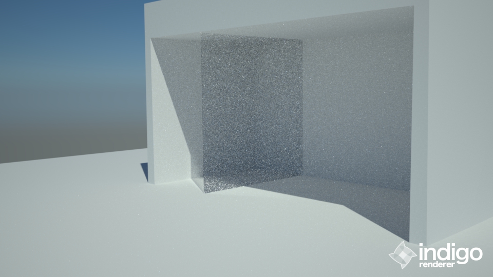

hi,

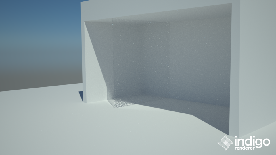

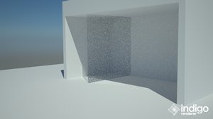

i need some help with semi-transparent panels in my render.
Below is about 1k spp sample.
As You can see, the render is still loooong way to be clear.
Material is "frosted glass" from material database, panels are 6 mm thick. I did some test with glossy-transparent and specular materials too.
Architectural glass acceleration is on. Indigo is 2.6.1 version.
Is there any way to speed things up?
In this case render performance is much more important to me than physical accuracy so some cheating tricks are also welcome.
thanks.

Do you have bidirectional on?

Post by wojtek-w » Thu Dec 20, 2012 8:00 pm
yes.
skp exporter reminds it when glass acceleration is on...

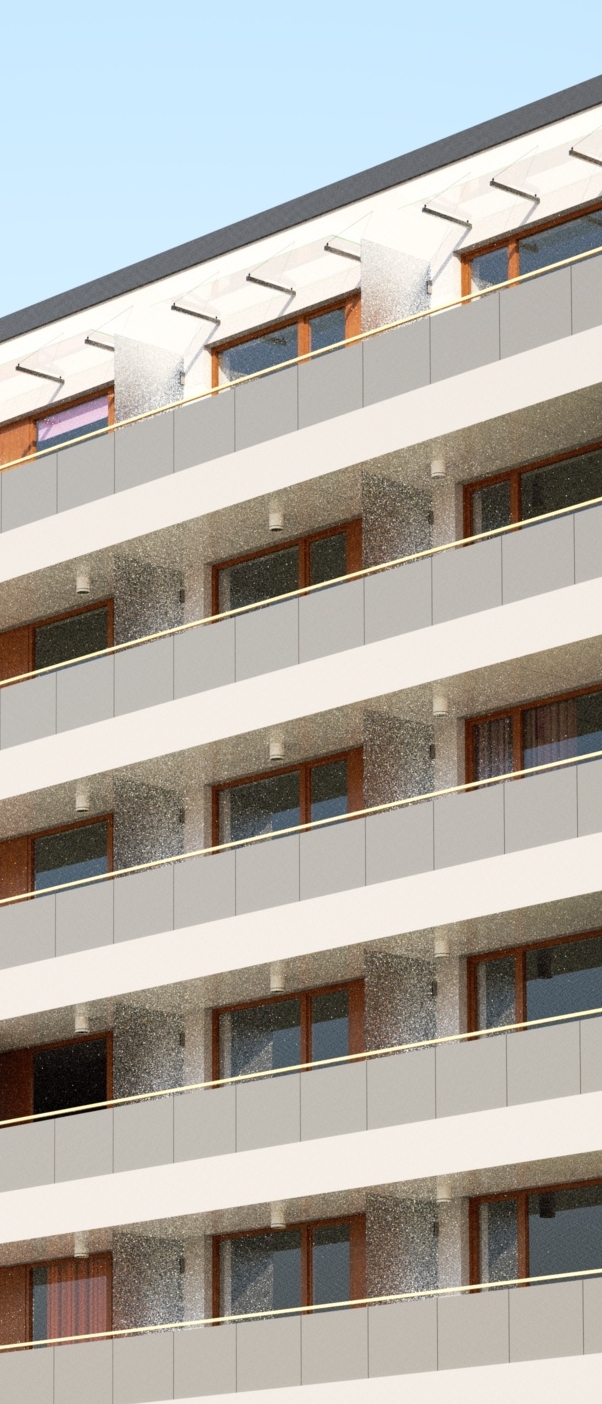

Glass accel doesn't work well at all for frosted glass. Maybe it should be "ignored" if possible for glossy glass materials.

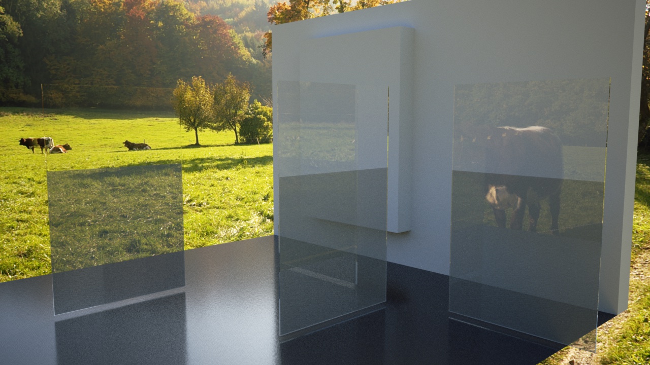

accell on (10min 40s 1000spp):
accell off (10min 0s 1000spp):

Post by zeitmeister » Thu Dec 27, 2012 11:32 pm
Getting fireflies after a long render time here too...
Even blending a simple glass material with phong results in fireflies.

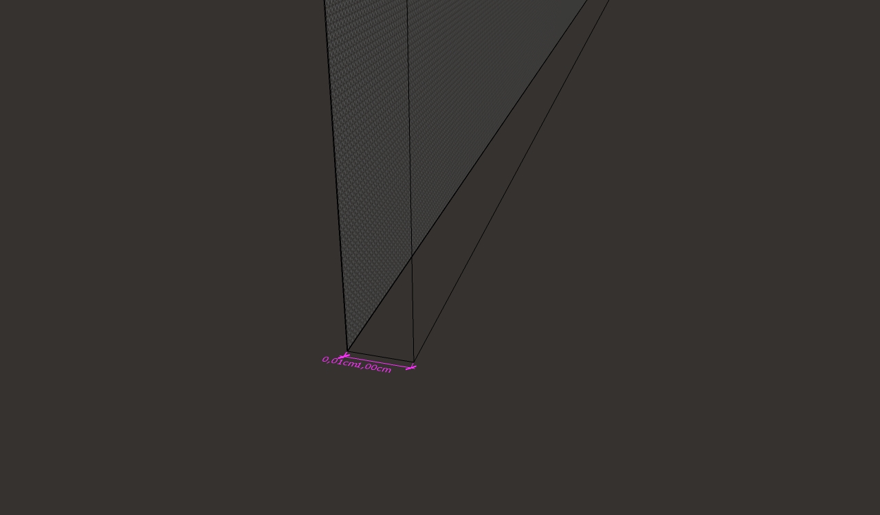

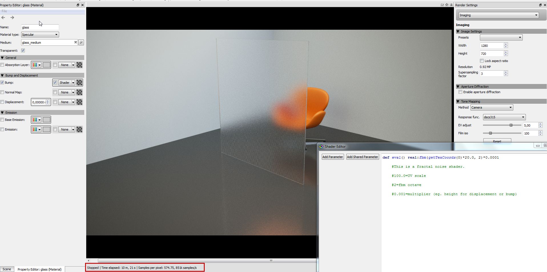

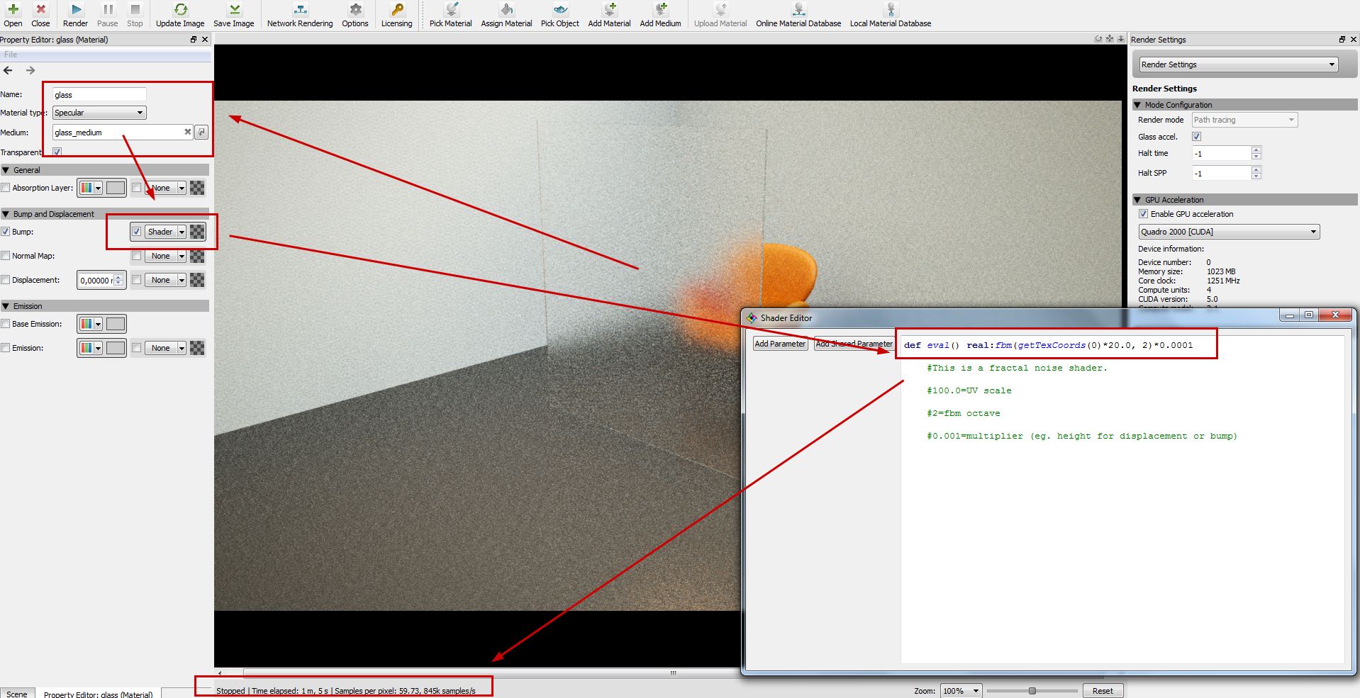

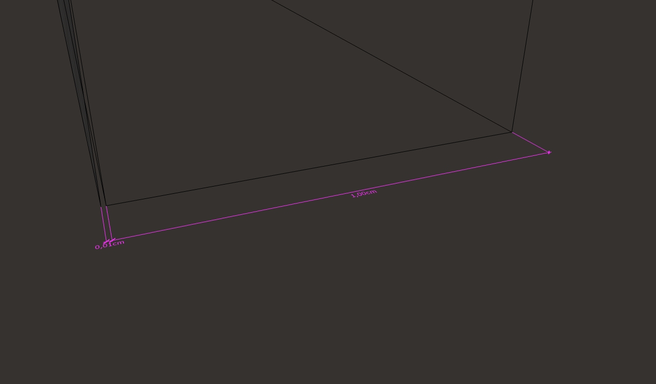

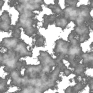

Try it this way. Behind the glass plate at a distance of 0.1 mm a surface texture with a transparent PNG. Texture size 0.1 mm so that the pattern is not visible. Cheap frosted glass panels are manufactured so similar.
texture

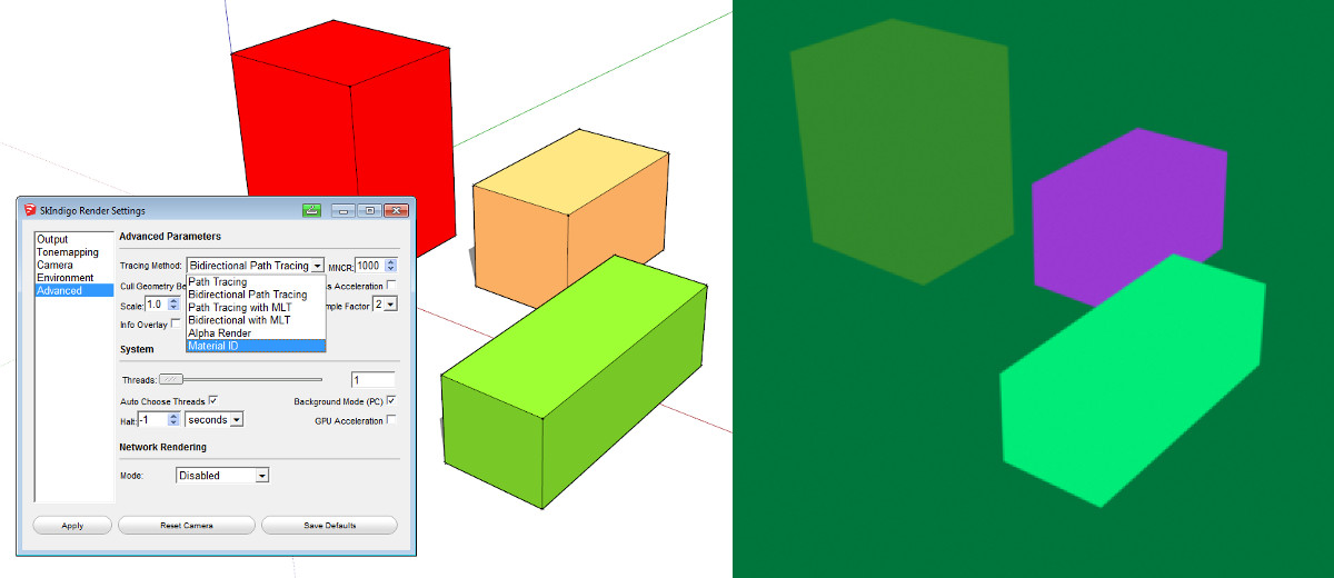

Or, because I don't see a good way to fake glossy glass, I would render a material ID pass and use it to create a selection to be blurred in a 2d application. Assign all objects one material and keep the glossy where it is, the mask should pop out.

Good method, which I had forgotten this one is.
The first image was rendered too short.

tremo wrote:Good method, which I had forgotten this one is.
Agreed. Reportedly this method is slower than using the Glossy Transparent material but it's a good option if it prevents fireflies to happen this much.

CTZn wrote:I would render a material ID pass and use it to create a selection to be blurred in a 2d application.
How can i do that with skindigo?

I'm using skindigo 2.6.1 and I don't see this option
I belive "ID pass" it's a feature I can't use without 3.x version :(
