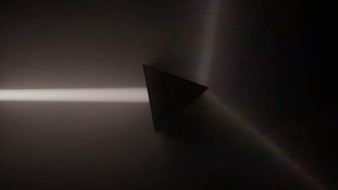

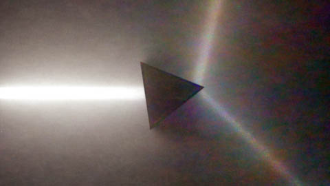

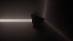

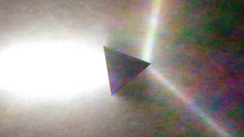

Hi. I tried to create what should have been a fairly straightforward animation of a light shining through a rotating prism, but I got very severe variations in exposure from frame to frame resulting in a pronounced flicker in the animation. I've attached images of three adjacent frames for reference. Each frame is rendered at 10,000 spp, but I rendered at up to 50,000 spp with the same results. Any idea what's causing this? Thanks in advance.

Make sure you use camera or linear tone mapping. Reinhard will automatically adjust the exposure per frame and will give flickering.

Enslaver, I used camera tone mapping.

Please double check, since such a results is very unlikely for a constant tonemapper (or do you animate your emission power too?!).
Use MLT+BiDir for faster caustic rendering with "Large Mutation prob." = 0.5 and "Max Change" = 0.005 in the advanced settings. You camera should be inside the foggy material box btw. for faster rendering.

MLT is quite a lot less uniform than without, so that could cause a lot of the problem. Maybe you can get away with not using MLT, just straight bidir; I'm pretty sure that will result in a much more stable rendered image frame-to-frame.

Zom-B, I made sure that camera tonemapping is used. I also had similar results with Reinhard tonemapping, which makes even less sense to me. I'll try rendering again with the settings you recommend to see if I get better results. I've also uploaded the Blender file if you'd like to take a look.

Incidentally, I did get much better results when I placed the camera inside the foggy material (or, rather, when I expanded the foggy area to include the camera). Also, when I tried rendering the original scene without MLT (Bidir or path), I got nothing but darkness.
