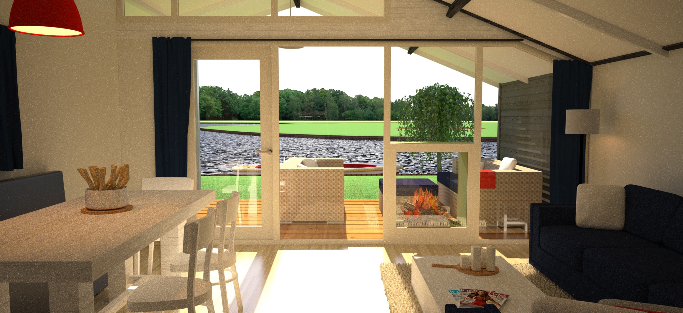

Hello,
I have a question, I'm working on a project but I'm not satisfied with the quality of my render.
Probably I'm doing something wrong, but I can't find out what.
I posted my render, and her is some more info:
render time: 162h,9m
sample per pixel: 38806,07
147k sample/s
Render mode: Bidirectional path tracing
Glass Accel.: on
Tone mapping : Reinhard
resolution: 2.22 MP
Supersampling factor: 3
MNCR: 10
(maybe a little bit overkill of information) :P
Im using Indigo Renderer v3.2.14 windows 64-bit build.
For what it's worth, Indigo is the only active program on that PC for those 162 hours.
As you can see on my posted render, there are a lot of dots, first I thought: in time it will go away, but 162 hours later it's still there.
I hope some of you can help me,
thanks in advance
Frank

Post by Zom-B » Sat Nov 10, 2012 11:30 pm
Hey Franky,
first of all use the latest Indigo 3.4 since it should be faster!
I would suggest that your Noisy image is mostly because of some low power lightsources inside the house!
Using Reinhard Tonemapping is quite hard to see that problem, but with Linear tonemapping for example you should notice that these lightsources nearly don't add any light to your scene.
Since these Lightsources are so weak and not much contributing to th eoverall image, Indigo give s just very little CPU power to these, so they are noisy if bumped in brightness by Reinhard tonemapping.
in short some advise:
1) don't use Reinhard tonemapping in development of your scene, so you see such problems very early!
2) use LightLayers for each light source during scene development to see if certain layers are very noisy or maybe even don't add anything to the scene.
3) Keep your "white colors" at RGB 204 MAXIMUM (!) otherwise these full white materials bounce light same as a mirror and cause noise also reducing renderspeed (your chairs for example look like that!)
I hope that helped for the start :)
Btw: how much of the area behind the balcony is 3D and how much is just a image?

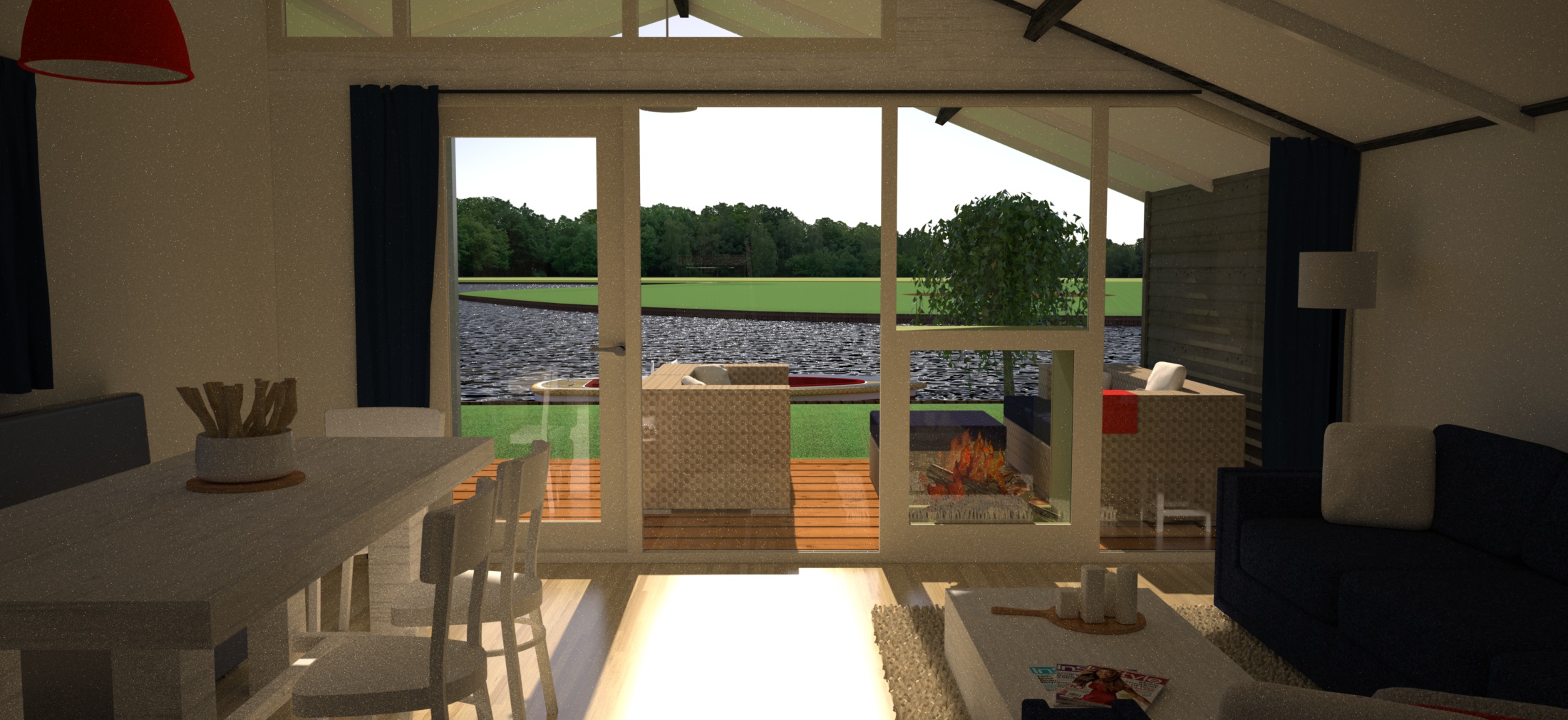

He Zom-B,
Tanks for the info, I changed to linear and set the lights off.
but still there are dots everywhere, the color of the chairs is RGB 255. If i set this to 204 I get a grey color. But the color of the kitchen (behind the camera) is white with PHONG (in the assign preset I picked 'car paint') maybe that's the problem.
I also set the sun on a other light-layer, if i make the sun disappearance, than there are way less dots, but there are still some. I think this could mean that the kitchen is the problem!??
The tree line is a picture, the rest is 3D, I think that I know what you wanna say with that, on the left and right side are lots of the same houses, but those are dummy's, is that a big problem?? also has every house a dummy tree.

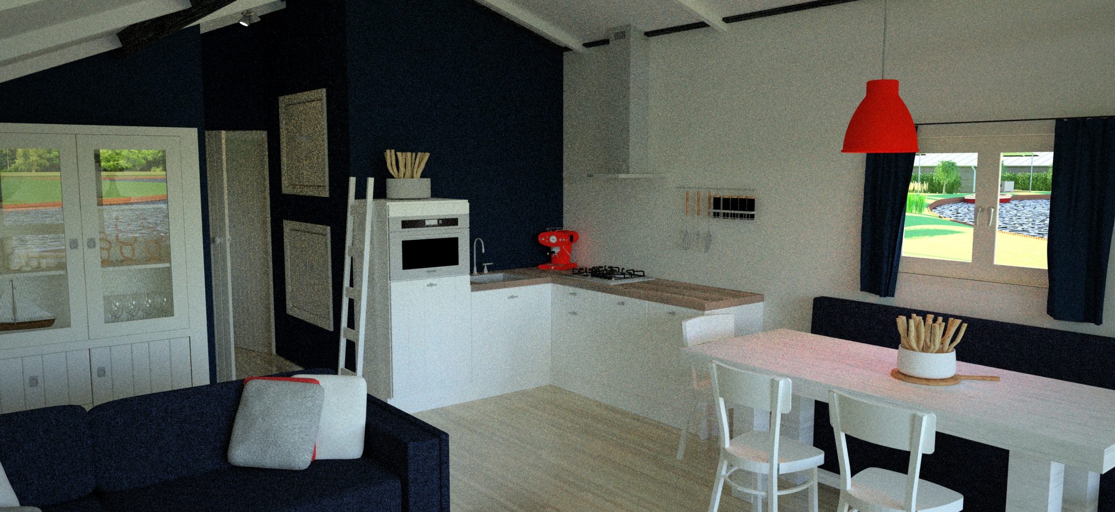

I added the render with lights out en linear, and the quick (7hour) render of the kitchen so you can see how big/small this is.
thanks in advance
Frank
test render of the kitchen
set to linear with the lights off
