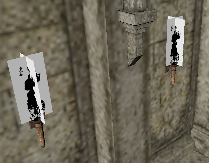

Hey Foxar,
I did some Fire in my last project: http://www.indigorenderer.com/forum/vie ... =4&t=11946
its a simple 2D setup as you see in the image attached, but the emitter material was set to be doublesided in the igs via:
<backface_emit>true</backface_emit>

CTZn wrote:
Zom-B wrote:the emitter material was set to be doublesided in the igs via:
Never heard about that one, could we please know more ? I'm sure there are a couple more things I missed.
You use it like that:
<material>
    <diffuse>
    </diffuse>
</material>
plane single sided emitters emit in both normal directions with that command, great for some fake torch fires etc.
Its an addition to Indigo that was somehow forgotten, after I asked for a such feature for the dragon scene, I get the info that its already in.
I'm also allowed to speak about it, so I do :)
