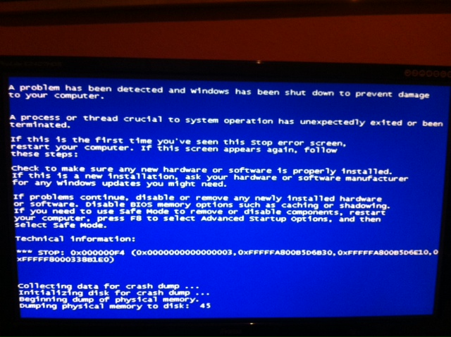

Is there any *.dll name reported down the blue screen ? Could also be a hardware or software driver issue I suppose.
Does this happen indiscriminately with or w/o using the GPU ?

Below is a screen shot of the blue screen that comes up as soon as the computer crashes. I haven't added any new software recently - as the image asks so that cannot be the issue.
I am just trying to get to the bottom of this as this is only starting to happen in the last two weeks.

37° is not a realistic CPU temperature at workload, that's more of the case temperature. Knowing the temperature at the surface of the CPU would help.
For instance my I7 is at about 62°C when rendering with Indigo. Opening the case helps a little, little bit (2-3°C).

http://www.alcpu.com/CoreTemp/CTZn wrote:37° is not a realistic CPU temperature at workload, that's more of the case temperature. Knowing the temperature at the surface of the CPU would help.
Core temp will read the sensors on the CPU. It also has a logging option (Tools -> Logging), so when your system shuts down (or bluescreens) you can look at the log and see if the CPU was overheating.
