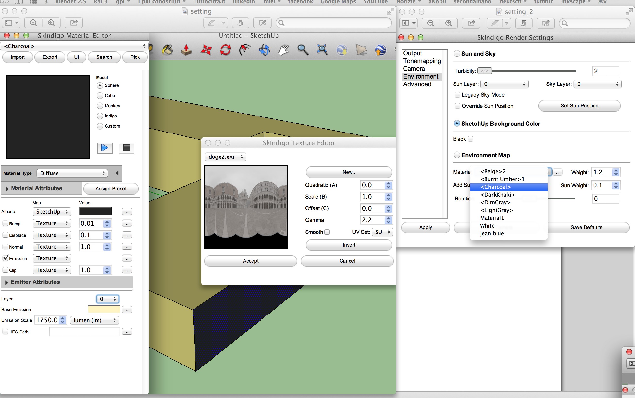

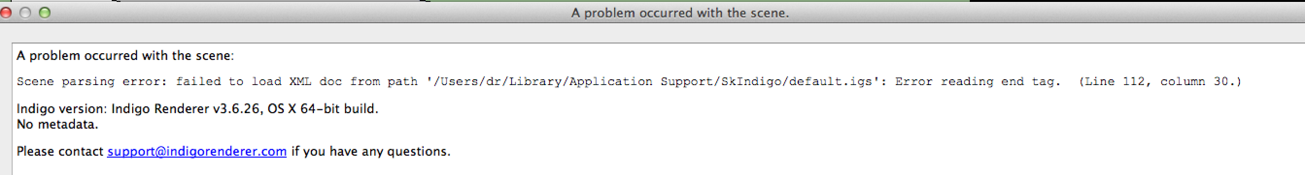

Re: hello and help with HDRI
hi CTZ,
I did try many times to find out how it works.
It seems too me that if you put the object too far from he background it makes everything white..
but alpha transparency works.
The hard part is to mix/blend environment lighting and sun.
The sun "cover" everything, independently of the setting I use (in my version).
see screenshot. (skindigo_sun_mix). It does not work even if I edit in the Indigo interface.
So i did try this "workaround" : I want to have sun AND Environment illumination together.
Like here:
http://www.indigorenderer.com/forum/dow ... &mode=view
But it does not work in my version... (v3.6.26, OS X 64-bit build)
Like here:

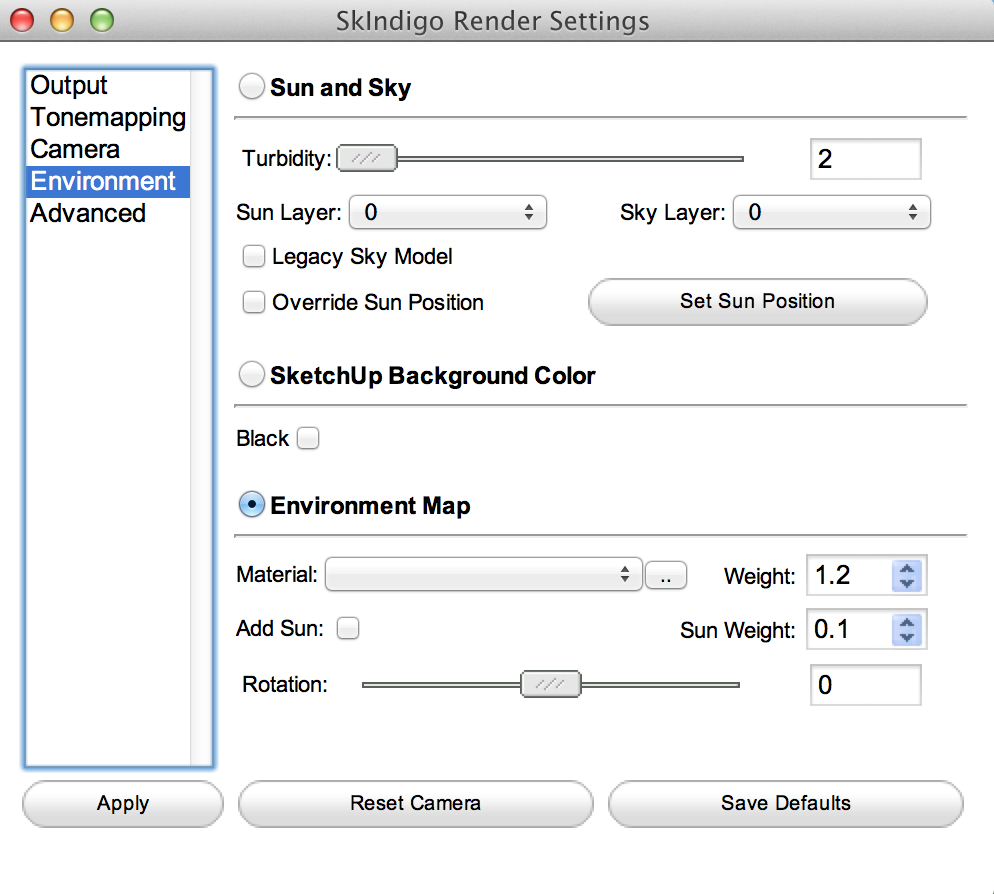

This is how I use the HDRI and sun lighting with Skindigo:
- In the Skindigo environment settings choose your HDRI, I prefer exr-files.
- "Add sun" should be selected
- Set the environment weight to about 100000 (depends on your exr, in most cases this works for me)
- Set the sun weight to about 0.0001 (just as an an approximate value, need to play with it)
- Render and save file as tif, this gives you an alpha channel.
- Use the alpha channel on your backplate picture in your photo editor.
Still don't understand why the values for exr and sun need to be set like this, but it works.
Hope this helps.
Lars
Hope this helps.
Lars
