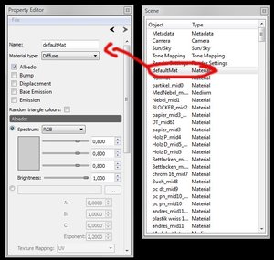

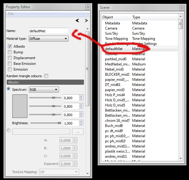

Post by Zom-B » Wed Sep 07, 2011 8:53 pm
PowerMax wrote:and I found there just two small windows left, which means that I can not change matirals right now. I click the pick material, but there is nothing happened...
The stuff you tell doesn't make much sense for me, so here is a screenshot :)
changing material:
Here you now can change the type, color and all the stuff about your material and it gets updated directly in der render window.

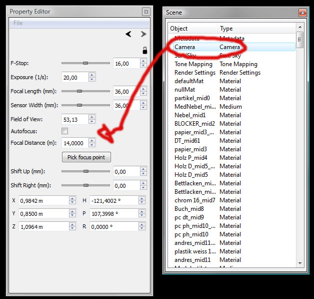

PowerMax wrote:is there any way that I can change fcous point during the rendering running? Thanks!
How about checking out the camera entry in the Scene window?! :wink:
