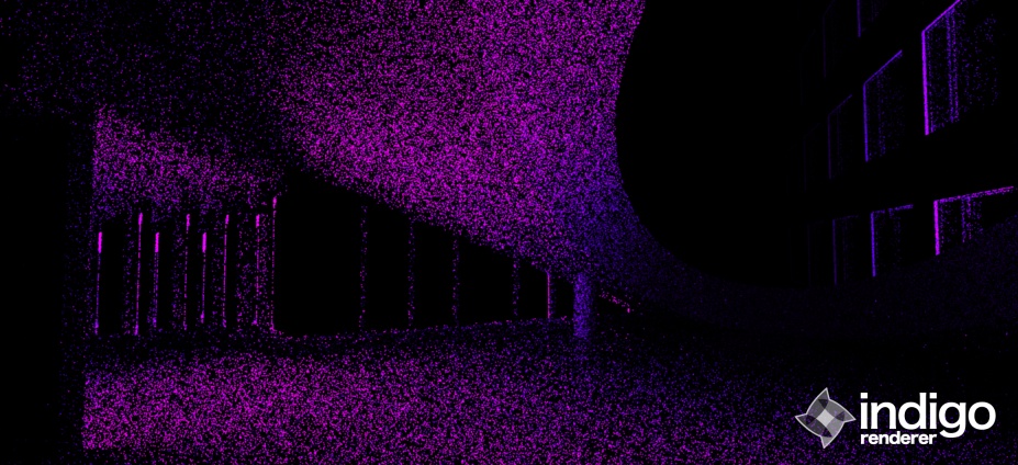

hello for some reason all my images are coming purple (see example) its an exterior view so its not like light is going through any material, and i was making other view form same model and it came perfect, any help would be much apreciated.
purple!

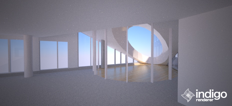

same model another view

Post by PureSpider » Tue Feb 22, 2011 7:55 am
The first image looks like you set the sun's position below horizon.
When you do that, your renders come out with "purple light" for unknown reasons.

Re: help! images come purple
Post by elDiego » Tue Feb 22, 2011 9:03 am
its actually at noon, summer time

Weird, lol, check your geometry, no big objects accidently scaled up to block the normal light? Are the sun and sun target in positions that would make it daytime?

Post by CTZn » Tue Feb 22, 2011 2:04 pm
Still, that's too early !
The trivial reason that I know of is the model used. It doesn't allow the sun to be below the horizon (ground). If you need that time of the day, either get a suiting environment map, or model the Earth globe and sun and atmosphere. Heh :)

Er, noon summer time is about as far away from the horizon as you can get :lol:
Perhaps a crazy white-point setting? Checked the light layers? If it persists, pack the scene (Indigo > File > Save as > .pigs) and post it and we'll have a look

elDiego wrote:its actually at noon, summer time
Check your global position and time zone. That could throw everything off.

Make sure your camera isn't inside a wall.
