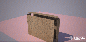

sorry!! another probably really obvious question! :oops: thought id put it in here instead of annoying people with a new thread :D when i try to put a displacement map onto a wood texture this happens.. (see image) does this mean i dont have a displacement map? and if so how do i create one?

The faces are displaced, so obviously you do have a displacement map.
The problem you're having is that the faces of your cube are not connected to each other. That causes indigo to displace each face individually instead of doing it nicely around the corners. Also you should check the offset value of your material, it should be 0 in normal cases. And scale is also important, the displacement seems to be quite heavy for simple wood material.

hi! i have set the scale of displacement to a little bigger than needed just so it was clear on the screenshot what was happening.. you couldnt see it that well before.. but whats an offset value? :? is it something altered in sketchup or skindigo? and how would i go about joining the faces together??? :oops:

Offset value is a constant value of displacement for Indigo materials. So it's altered either in the exporters (skindigo) material editor or in Indigo material editor.

Actually the C parameter can be negative, this would push the faces back, in the opposed direction of their normals.
The way to get faces stitched is a bit counter-intuitive: edges to be welded have to be smooth, or they'll be separated by all means. So, smooth all edges to be welded, enable subdivivisions but not shape smoothing so to keep the result within the desired aspect.

@CTZn - it okay! ive smoothed the edges in sketchup and that seems to have worked.. thanks! :D but whats a C Perameter? :oops:

It's also called offset, as mentionned by Silmä. Sorry for I'm sticking with technical definitions :twisted:
