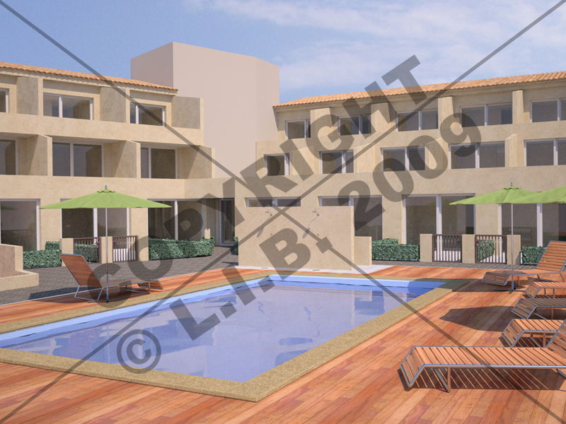

Hi guys!
Been away for a while :D - I had to work on a potentially first "real" (i.e maybe commercial) project.
I was tied to a tight deadline (3 days, which is very short for a beginner like me), so I couldn't do as much or as nicely as I wanted...
Anyway, I thought I would display it here and ask for some advice on how I could improve the view.
What bugs me most is that i just can't get a "photorealistic feel" to the materials, although I tried to apply bump/displace/spec maps.
So the question is...
==> how do you get a very realistic effect?
I tend NOT to click the "subdivide" button in Blendigo, but maybe I should?
Many thanks in advance!
:wink:
Note: I'm awfully sorry, but the potential client insisted that I had to protect the render... :evil:
Render time : 23hrs 30mns

Hi! What about bevel modifier? Tiny bevels help a lot. Plus there is no plants and/or trees. :) Camera position doesn't seem to be advantageous. You can add the water ripples + the texture inside the pool. And more details in the modeling :D

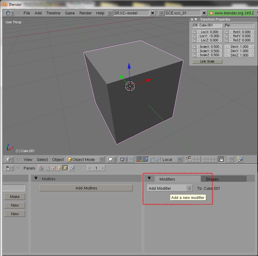

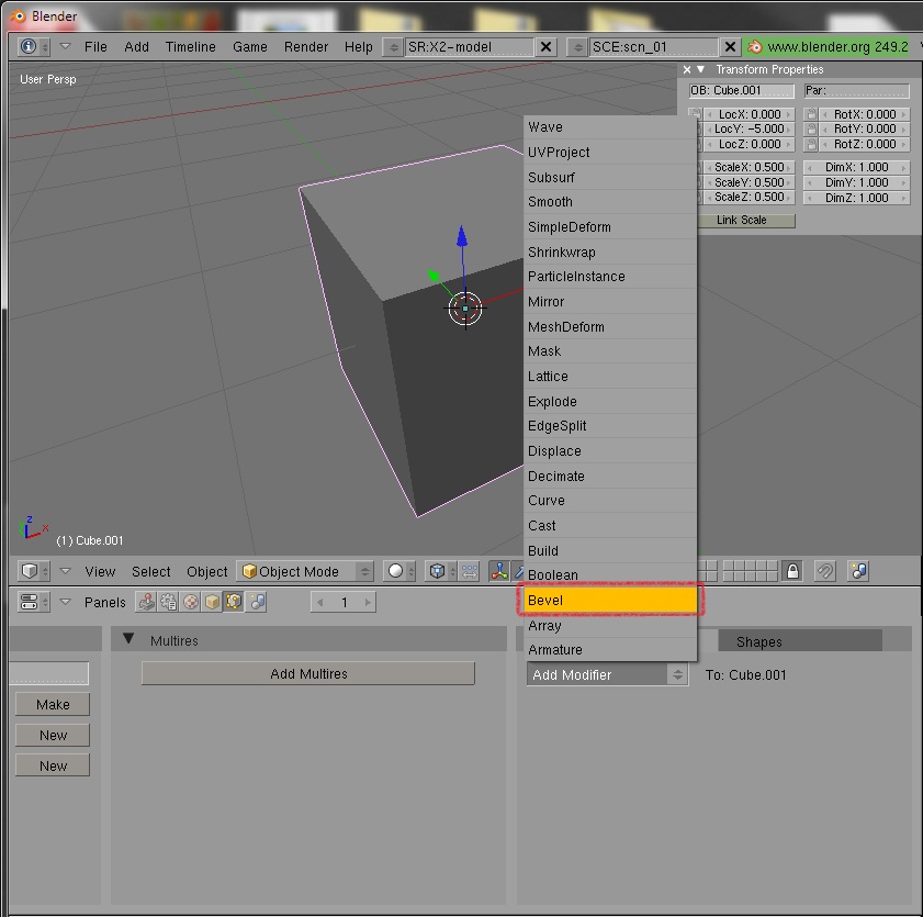

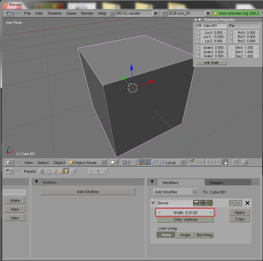

No no no! Don't select manually! You can select an object and use bevel modifier
Here is the cube 1x1x1x Blender Unit. Select the cube and click F9. Find the Modifier tab.
Find "Bevel" in the menu
...and input the value. Here it's 0.01 Blender Unit (1cm for Indigo). Don't forget to apply scale (Ctrl+A, 3) before tweaking the bevel value. Like I did not on the last screenshot, scale is 0.5, so if I apply it the bevel goes twice as bigger.
In case you need different bevels on the same object, you can do it with the bevel weights and this modifier. Check this for more info. :)

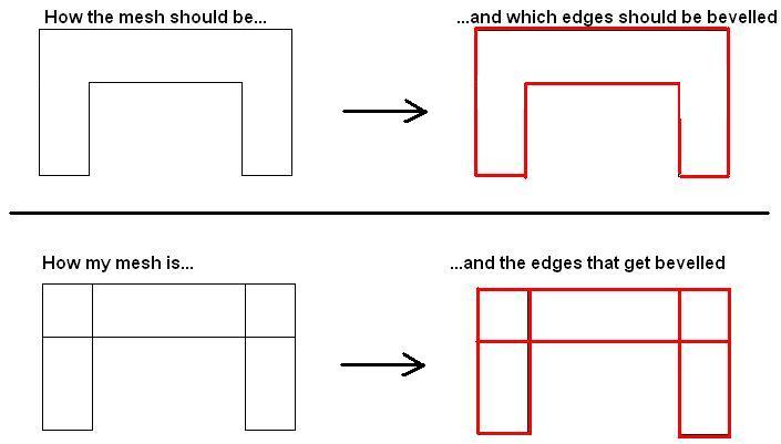

Many thanks, I knew how to bevel objects, but the problem here is that my meshes aren't "clean" enough.
Here's my problem, and why I'll have to select manually the edges:
(sorry I'm at work, I had to use Paint to show you... I hope this will be clear enough)

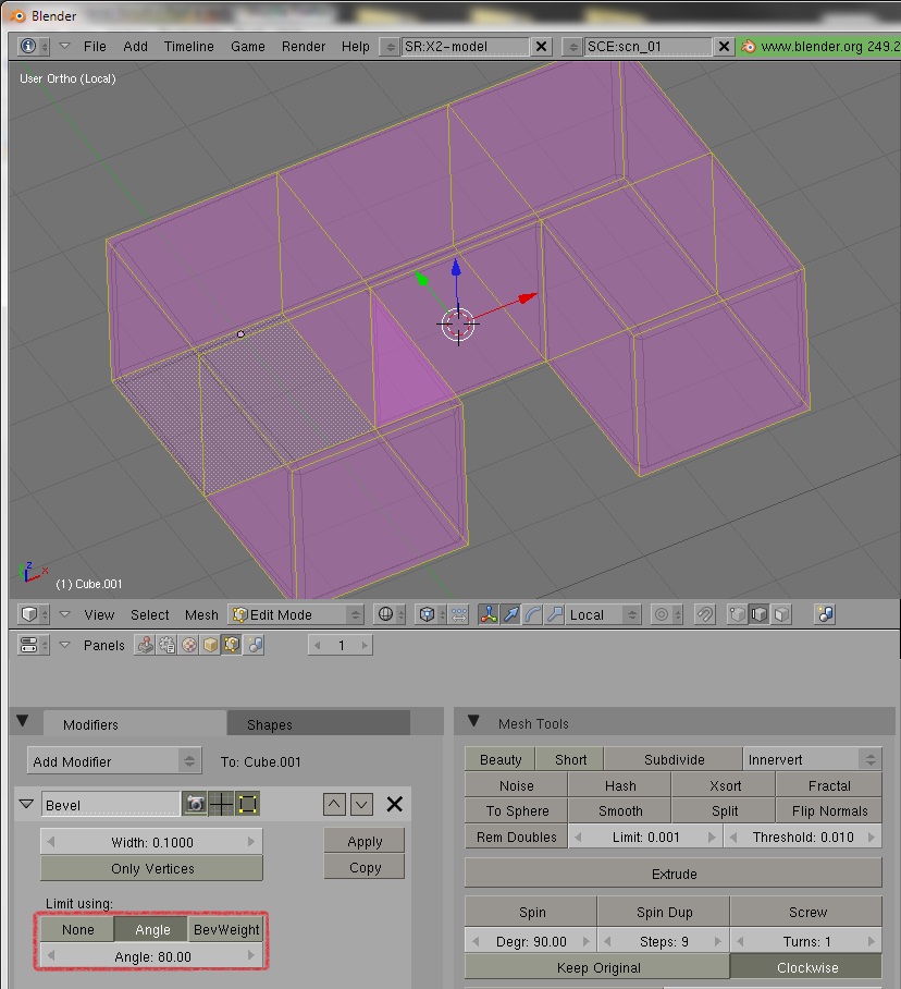

Re: First "real" project
Post by dakiru » Mon Oct 26, 2009 9:26 pm
Now I see. You can play with angle limit, like on the screenshot.

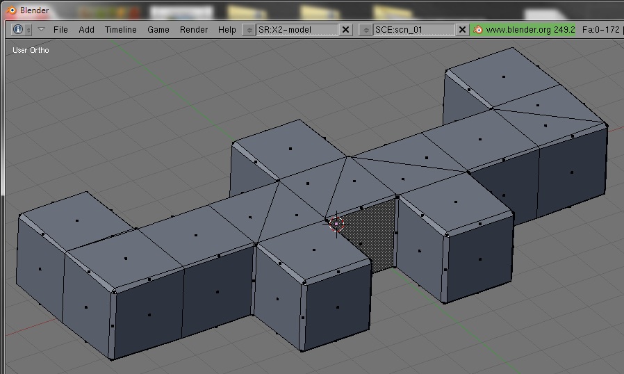

Post by dakiru » Mon Oct 26, 2009 10:07 pm
Sure :) With the modifier applied (I used big bevel to have the result visible, when a smaller used, the difference in width is not so visible):
