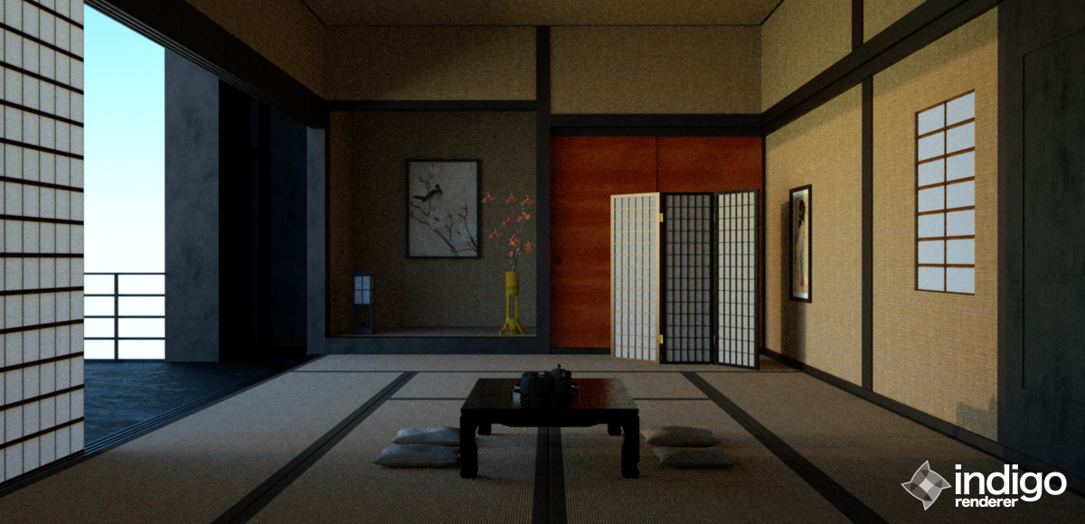

hi
here is a new scene i tryed with indigo. scene is not complicated, it is just a reprocuction of a japanese living room, for the tea ceremony. hope i forgot nothing. the light though is in the early morning...
C&C are welcome.
for the moment, i think i have to develop the model in the visible part of the exit on the left, because the transition to the exterior photoshoped picture is too hard.
also gonna change the floor tatami texture because it is too low res to show the bumps
others suggestions welcome too.
i think i ll render it by night with lights it could be great too.

Re: japanese scene
That is really really good
Although, I think that door material (the "paper" like part of it) should be more transparent. Not completely of course but seeing as it's so thin, it should let at least a bit of light through.
Re: japanese scene
I think it is good too.
I'd check a couple of things, though:
1. the black points are too black IMO: I can't see the objects over the table, and the wood (?) stripes on the floor and walls actually "eat" too much light. Maybe it's only my screen's gamma that's low, but if it's not the case you could make the mats less dark, or change the shader type, I don't know..make it a low IOR phong or something..
2. the overall saturation is a little exaggerated. Try to desaturate a little your textures!
Re: japanese scene
hi
thanks for comments, i will post a new version soon
yeah i have a problem with saturation in general, my TFT screen is always too bright and in general i plug a CRT for graphical works then i have the colors exactly like on paper, but at the moment i only have my bright TFT
yeah i also think the stipes (it is some textile sewed around the tatami) and the stuff on the table are too dark. there was a beveling on each tatami piece edges but since it is too dark we cant see it. for the next version
actually, the paper like material is a diffuse transmitter, but i am not sure i understood how to make it brighter/ let more light pass? gonna play with it a little. I would like, not specially for this scene, to learn to make materials like very transparent curtains. i read somewhere that if i wanted to do a transparent color with no refraction or stuff i have to blend it with a "null"?? does it mean i can blend a material with "nothing"?

Re: japanese scene
Exactlydjegoo wrote:i read somewhere that if i wanted to do a transparent color with no refraction or stuff i have to blend it with a "null"?? does it mean i can blend a material with "nothing"?
Re: japanese scene
hah!! worked!thanks! i m rendering it for one or two hours so that it is a minimum clear an i share it with you.
i won t change the transparency of the paper, but make it let more light go through. in real world, it is a paper made of rice (yes, quite weird but amazing) and iyou are right it should be more bright. but the transparency is quite this level.
Re: japanese scene
this is the new version. i renderd it with indigo 2.0.12 this time and... Oh My God it is soooo faster!!!!
2hours 45 and already this result i am so excited (and i just can't hid it.... i m about to lose control and i think i like it....**music**music)
i changed the wall material, and extended the entry, i ll toshop a background when it willhave renderrd more hours.
Comments still welcome

Re: japanese scene
I like the new version much more than the previous one! Bravo!!
The terrace on the right is a great intuition, materials seem to be better, and less saturated overall feeling. I think you're on the right way! Keep going!
Re: japanese scene
thanks
yes i prefer this on's colors too. but i still find the texture of the wall tiled on the right, although it is the same as on the floor but in another color. ah never satisfied
i ve juste been able to understand the light layers!, not difficult in fact, if we copare light layers to photoshop layers... this is soooo amazing! damn who s the man who created this software i must give him a hug!
gonna be able to render the night and the day render at the same moments now!!
if anyone has suggestions though? because i m starting to be satisfied, but i m sure there s still a little subtility mising...
