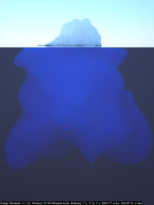

Here is where I'm at at the moment. I know, the iceberg model is crapy and not smoothed. I will do a better one later, for the moment I try to get convincing materials. I have only two materials, but it's hard.
Any hint about materials is greatly welcome.

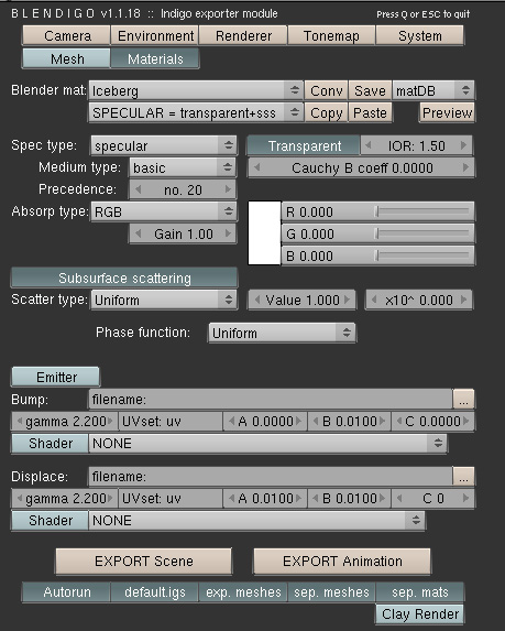

Ice.

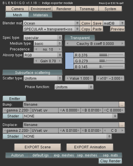

Material for water
Raw render, no postpro atm. I realize that I did it with Indigo 1.1.14, oops. I'll download 1.1.18 this evening.

It almost looks like some of the lighting from the surface is being transmitted through and emitted from the bottom..

Anyyhooww, it could be the water material too. Maybe try cutting back on the absorption..

I think the problem could be the varying thickness and scattering of the ice.
I don't have a clue how you could solve this with a simply on-surface geometry.
Maybe a 3D, volumetric noise could be the solution to vary the sss inside the iceberg?

The water IOR seems not to be in the UI, I suppose it's around 1.334 ?

Oh, indeed there seems to be a little bug in my screencap. Yes, water's IOR is 1.33.
