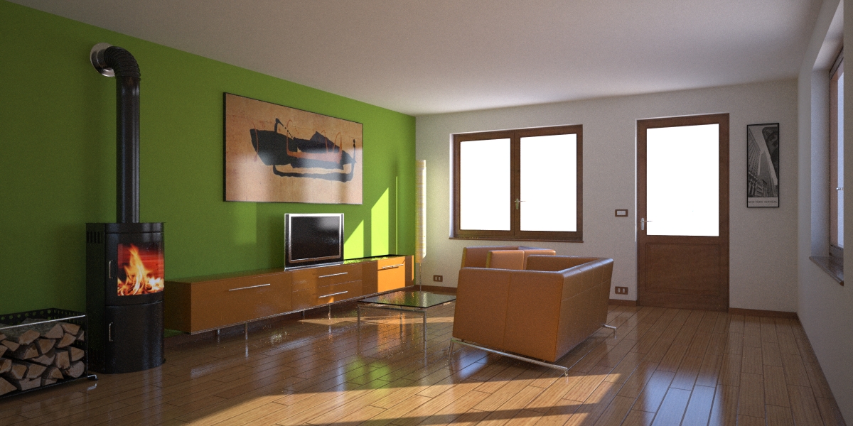

Another test of Indigo and Maxigo (Thanks to Suvakas).
Time render: 8h on AMD X2 4200 2 thread
i've put a plane outside with a panorama jpg but with exit portal don't works and render a classic sky.
I want to try a flesh lamp test, how can i make it?
Meshlight? Settings?
Thanks to all

Hey gradozero.... nice Picture!
Maybe the ground is a little to reflective and the bump mapped splits/grooves (?) on the ground shouldn't be that fat.... maybe!
For Exit portals every mesh behind it doesn't get rendered (like a plane with your panorama), only lightsources like sky or env maps are visible behind them...
for a fash light effekt you need a single very small light source, that faces only in "photo direction", to emit your room. tonemapping should do the rest. Check this thread for some more info

there's a trick to use exit portal and see a background image or the only solution is don't use exit?
About the flashlight i read the thread but how many watt i've to use?
thanks
Post by Zom-B » Wed Oct 10, 2007 10:04 pm
I totally forgot that option mark told about here sorry
