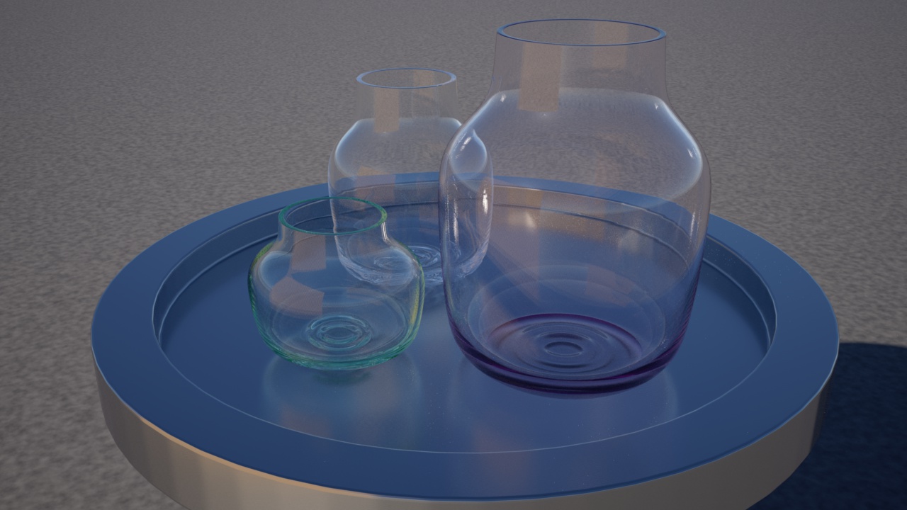

Hi
Glass is a material difficult to be rendered, usually creates a box in which you insert objects are illuminated with a map of the area with environmental or light, usually getting good results.
In the example, the scene is illuminated by sun + sky with a totally unexpected result.

What are your rendering settings? Also, what is the problem with the render?

Hi
Sun+Sky,
1 area light,
SS=5,
Agfapan apx 400cd,
Light layer default =1,
Pathtracing with BiDir,
4 Threads
Indigo Renderer v3.8.25.
Image width: 1280 px
Image height: 720 px
Internal image width: 6440 px
Internal image height: 3640 px
Sun+Sky,
1 area light,
SS=5,
Agfapan apx 400cd,
4 Threads

I still don't understand quite what's wrong with the image. There seems to be a lack of sunlight though - if you want to render realistic glass in sunlight (very intense, sharp light source) I would try rendering with BiDir + MLT.
Re: Glass outdoors!
Hi contegufo, there is imo nothing wrong with the render but the environment. Maybe the biggest jar is intersecting with the plate ? Some geometries could use more subdivisions.
Just add a couple trees for reflections and/or a fake cloud behind the camera, give your glass something to play with. A render is about how light is interacting with the camera surroundings. In that sense, glass is just one more lens adding to the camera.
Thinking of your exterior bike renders (well done btw), adding just one close-by palm tree would add a lot to the sunsky system. Anything that would partially block the incoming light. Cast shadows

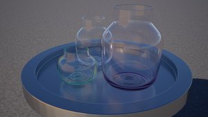

The image shown here was made by changing only the rendering algorithm = Bidir + MLT. Overall it is similar but there are some flaws.

You still haven't explained what exactly you think is wrong with the picture.
Re: Glass outdoors!
It's lacking shadows and caustics, as if there were no sun

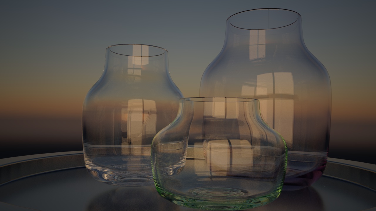

Hi
Example with sun + sky Bidir. the last is evident the contribution of the light and low sun at sunset.
@gallinette: shadows on the plate there are, the sun is behind.
