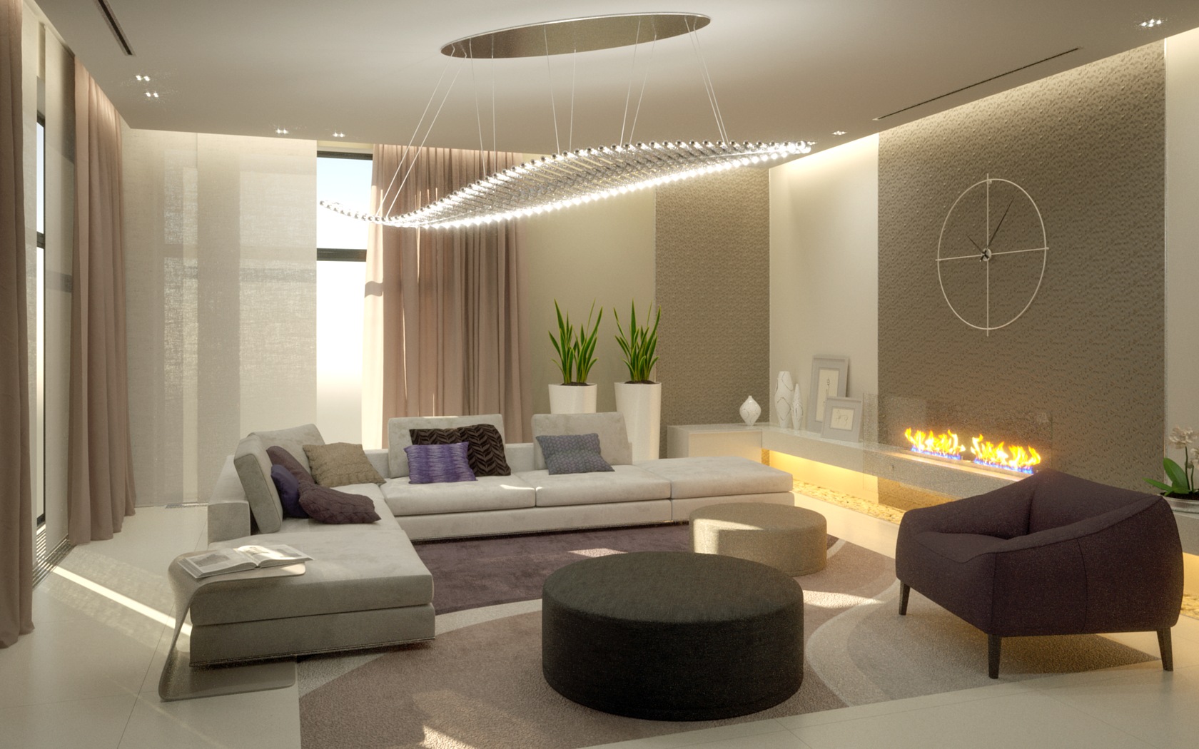

The second and more serious test render. Accumulated a lot of questions.
Rendering time (still is) 15 hours.
Questions are organized, and I will write later.
i7 x980 3.33GHz
Win7 x64
C4D r13+Indigo for Cinema 4D 3.4.18

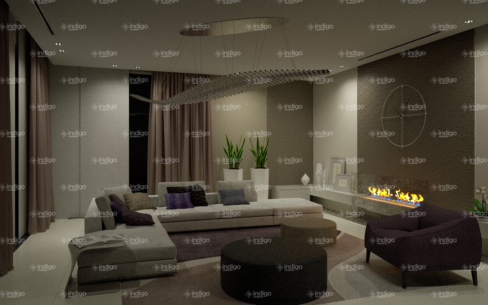

-through portals can not see anything (the sky) - how to solve?
-clipping plane visible from the other camera - how to solve?
-how to simplify the chandelier? (long believed) (disabled glass with a thickness for the rendering)
-how to simplify the lights in the ceiling? (light passes through the glass with a thickness)
-had more questions, but I forgot :)

You won't be able to see anything behind an exit portal. That's the nature of the beast. If you want to see the outside you'll have to postpro it in. I think you can do a "Foreground Alpha" ( in "render modes" in indigo interface) render to use as a mask.
On small objects where reflective and refractive effects of glass are not visible such as glass in front of small light sources or even windows, remove the glass to speed up the render process.
If you need to keep the glass in place and it is flat glass, then use Glass Acceleration.
Where are the light sources in that awesome chandelier ?
Perhaps post a wireframe. It looks like its made from glass cylinders. Use at least Birirectional Pathtracing. You may get quicker clearing of noise when using Bidir MLT.
Last, but not least. Beautiful renders and study of lighting!
That repetitive " noise" with the " indigo" label is really distracting ;-)
Renders like these deserve better.

Headroom wrote:You won't be able to see anything behind an exit portal. That's the nature of the beast. If you want to see the outside you'll have to postpro it in. I think you can do a "Foreground Alpha" ( in "render modes" in indigo interface) render to use as a mask.

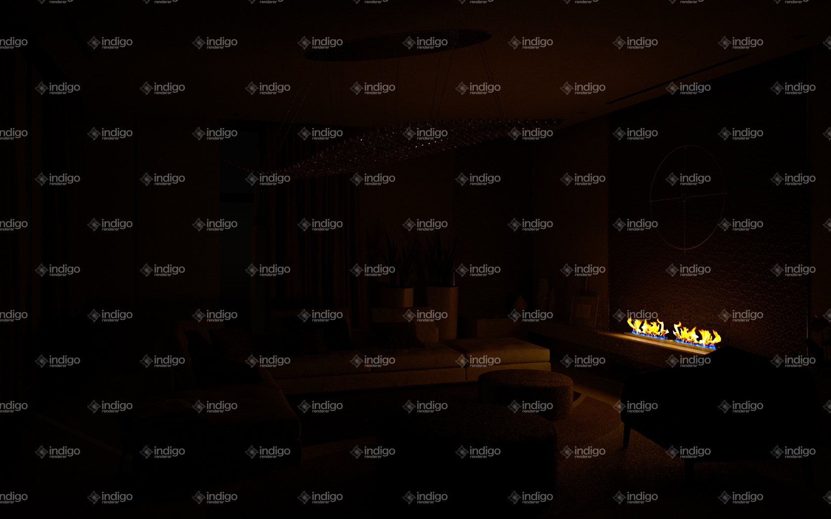

test in the dark interior (Render from a friend with the license)
Bidir+MLT
23 hours
used denoise
original

23 hours, depending on the computer hardware you use of course, sounds long. However, again you have created a complex lighting setup, with lots of specular materials. If you are considering getting a license keep in mind what I said earlier in respect to the two node licenses that are included in a full Indigo license. For scenes like this Indigo pretty much scales linearly. Buying a second identical computer will cut render time approximately in half.

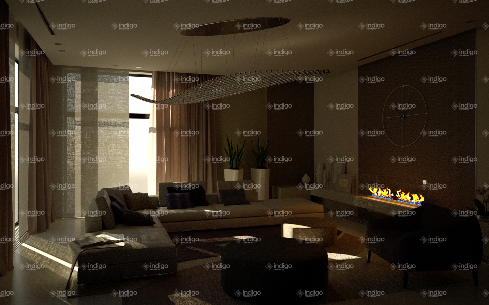

MLT+BiDir
36 hours
Xeon x5670 2.93 Ghz (2cpu), 48 Gb ram
scene by N.G.

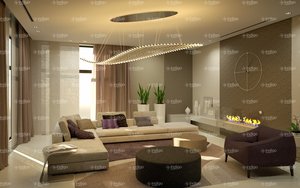

Done. Have to wait for an update Indigo on Cinema4D.
15 hours
