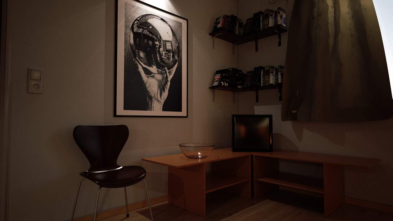

Hello and welcome to my WIP/Test Thread. Comments are appreciated 8)

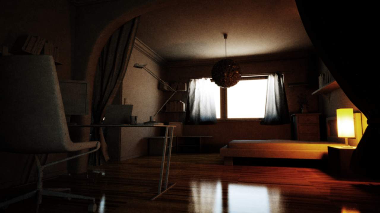

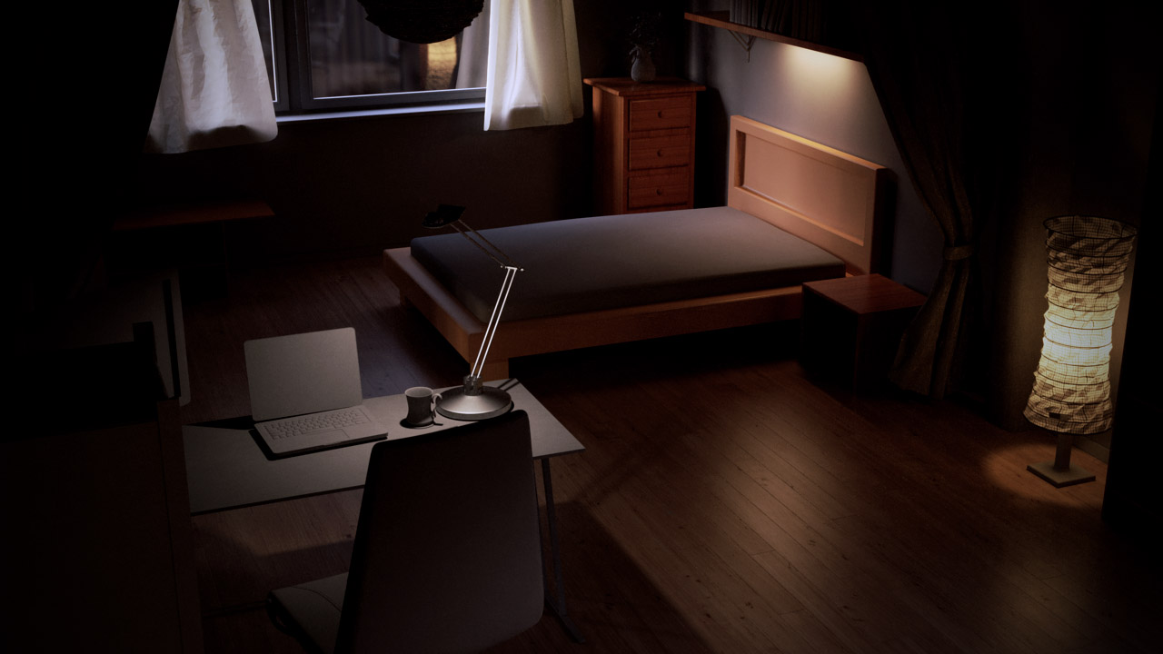

Re: Smashpapst (IV): Work in Progress / Testrender Thread
Some Updates. I am not satisfied with the look. Looks too artificial..
smashpapst
- Posts: 13
- Joined: Tue Sep 13, 2011 12:54 am
Hi, I like your approach with rendering; the results are dark on my CRT display, but that makes a difference in feeding the eye, renders cosier.
I think that the render that you are finding too artificial may be showing too much neutral and flat surfaces ?
Awesome renders. I like the contrast, specially the lamps reflections on the floor.
- Posts: 1828
Love the moods! Makes the images 10 times more effective, even if they're not completely modeled/detailed.
Keep detailing, round/bevel the corners of the plaster/drywall walls, texture more surfaces and this could be really great.
The images do seem underexposed, but I don't think that's a problem at all. Underexposure can be used very nicely to portray moods and especially well if you contrast it with moments or accents of brightness. Keep it going!

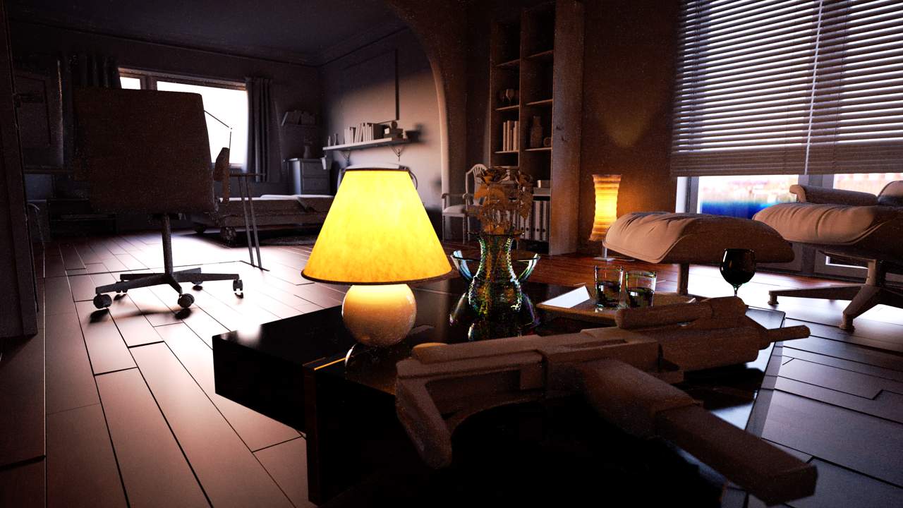

Hi,
back again with tests. How come that a >9Kspp image looks still that grainy? I am using Exitportals, HDR-Environment and two emitters behind DiffuseThinSSS. Do u have any hints on improving the performance of the scene?
Img attached,
greets
Img attached,
greets
You can add a large reflector behind the camera, or even make it an emitter put on a separate and dimmed layer.
The foreground is lit indirectly while other parts of the scene are directly lit hence the sampling discrepancies. This trick will allow you to control noise of indirectly lit areas.
Amazing work !
Amazing work !

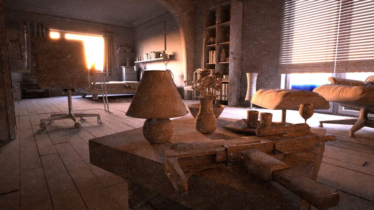

Thanks for your reply, highly honoured CTZn.
The reason I don't like that 'fill lights' is, that it reduced these unbiased 'dramatic shadows'. I'll give that a try, although I'd prefer an other solution.
Attached a five minute version, which I like more than the 10+h image.
Greets,
smash
Greets,
smash
Back-lit scenes will always be tricky to render.
I just posted a few hints regarding the lighting setup, the MLT speckles in your scene are hinting me toward important discrepancies in powers for lamps against the environment could it be ?
Best is to first address the sampling performance of each light source compared with the others without touching the layers. Then dim the later as required.
Thank you to keep us posted !
