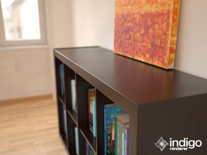

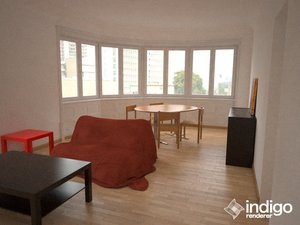

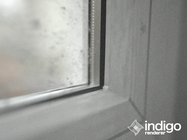

I really got into indigo recently and i am trying to get my first complete scene together, but recently i got to the point where i feel the renderings still look somewhat fake, but i don't have a simple explanation of what I'm missing... the closeups seem to work better, but the overview images just don't look right somehow - I know from other fields that after a working on the same project for a while, one tends to forget about the most trivial bits ;) So comments, criticism or hints on possible improvement would be highly appreciated!
p.s.: I using blender 2.49 as modeling tool and indigo 2.2.12 for rendering. By the way, the exterior a hdri map and not rendered.
clay render of overview
overview
close up of window
close up of book case

The depth of field suggests something weird about the scale of the object - its blurred in the foreground, and in the background, as if it's too small. Either have the focus a little further back, in the middle of the shelf, or have no foreground blurring
Maybe adjust the composition too so that an object becomes the focal point, rather than the top edge of the shelf.
Maybe some objects scattered about in the background, to give a feeling of a lived-in space - dosen't need to be anything detailed, or in focus, but just something no arranged so neatly
See if that helps :]

Thanks for the advise soup! I used blendigo to export the scene, so it might be that I messed up with the blender-unit/meters ratio... I'll check that. Also I'm thinking about adding a plant or something in the background - but that will probably take some time to create :)
By the way, soup's comment refers to the the close up of the book shelf, because I forgot to upload the other images in the initial post (and then had to wait until the post was accepted until I could add the other ones...) silly me :)

Your images are not totally noise-free, and the noise generated by Indigo often looks non-natural. Maybe a longer render would look better.
The white walls are maybe too uniform, and too white (which makes the corners not dark enough). Decreasing the albedo of the walls, and applying some subtle maps to make them less uniform, would help too.

What kind of lightning setup you have? Right now the room is almost completely uniformly lit, and the foreground (black table and sofa) doesn't have depth in it.
Block the light source behind the camera, and the result will be a lot more dramatic. When there's a huge light source visible in the picture, one naturally expects it to be the prominent one.

I would bet there is no other light than the outside envmap... But the white paint has a too high albedo and uniformizes the light.
On the window frame detail, I think the glass is lacking some absorption. Try this one : http://www.indigorenderer.com/materials/materials/250 , it was made with real glass spectral data (I'm working in glass R&D!)

I'm guessing there's another set of huge windows behind the camera. The clay render is also totally uniformly lit, and i don't think the clay material is 100% white.
If there's another set of windows, the alternative way to handle the lightning (instead of blocking the windows behind) is to change the envmap to a more sunny one. That way there would be a lot more light in the other end of the room, and more depth.

Thank you for your comments! I'm just rendering some of the shots again right now, this time with longer render-time, in order to get rid of the noise. I'll post the results as soon as possible.

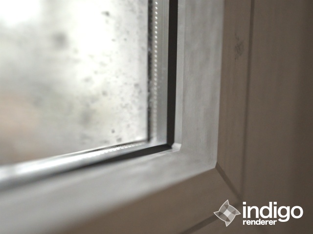

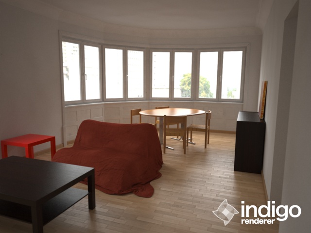

@All: Finally I found the time to implement some of the suggestions mentioned in the posts above. The most important things was that I turned down the albedo of the walls by about 5% and changed the gain of the hdri env map - that made a huge difference alone! There are some better defined shadows now, which I think enhances the realism quite a bit.
Also, I increased the B parameter for small- and large scale bump map on the wall material, trying to make them look less uniform. Additionally I added specular (dirt) maps to some of the wooden materials and replaced the glass material as suggested.
Finally I took more time to render the results (I also helps that I'm now owning a new computer with a i7-870 cpu, which speeds up the calculation by amazing 600% (weeeee !!!) in comparison to my old one (athlon 64 dual core 3800+) !
@CTZn: Thanks for suggestions! The possibly low dynamic of the hdri env map is interesting point which I haven't thought of until now... I made the map myself from multiple camera shots using PTGui, and never actually checked the histogram of the result. For the moment I just tried turning up the gain, but I'll take better look at this soon (or possible redo the whole thing from scratch).
The map is pretty low-res and has some ugly stitching errors anyway so I'm also considering using the method you described in your post (render an alpha version & do composite with LDR background). The only problem I'm facing there is that I'm using a transparent material (with some dust on it) for the windows and therefore appear solid in the alpha render ...or am I doing something wrong here (is there a way to make the alpha render take into account material transparency?) Concerning this, I haven't be able to spot a hint (about alpha rendering & composite) in the "appartment with terrace" thread, or is it possibly another, similar thread?
P.s: I tried the the using the linear tone mapping instead of reinhard in the latest renders, which I think also improved the renders.
window closeup with new glass material (and different lightning because of decreased wall albedo).
improved version of room overview

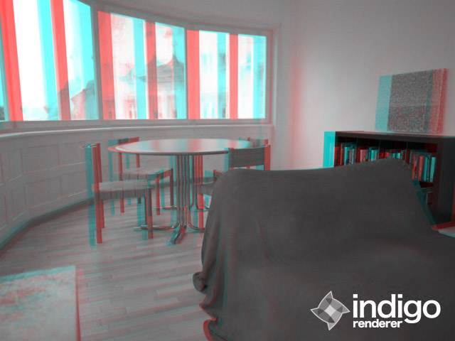

p.s: and for all of you 3D geeks out there - a anaglyph (3d red-green goggles) version :)
anaglyph

dechrigi wrote:The most important things was that I turned down the albedo of the walls by about 5% and changed the gain of the hdri env map.
What is your albedo now? Generally, you should not set it above 80%. Even white paint has an albedo which is far from 100%. Only very technical materials have high albedos (such as spectralon, with an albedo around 99% on a spectrum wider than visible...)
To high albedos on white rooms have two main effects : they wash out the shadows completely, and cause rendertimes to explode (as the rays can bounce many time and still have an important contribution to the lighting)
Nice improvements, though. The image looks under-exposed now, because the windows are much more bright than the room. You could:
- Increase tonemapping gain or exposure. This would expose the room correctly and overexpose the windows.
- If you want both exposed correctly, you need to use HDR tonemapping techniques. Export to EXR image and use an HDR tonemapper (such as photoshop "convert to 8bit", PTGui, or luminance HDR)
