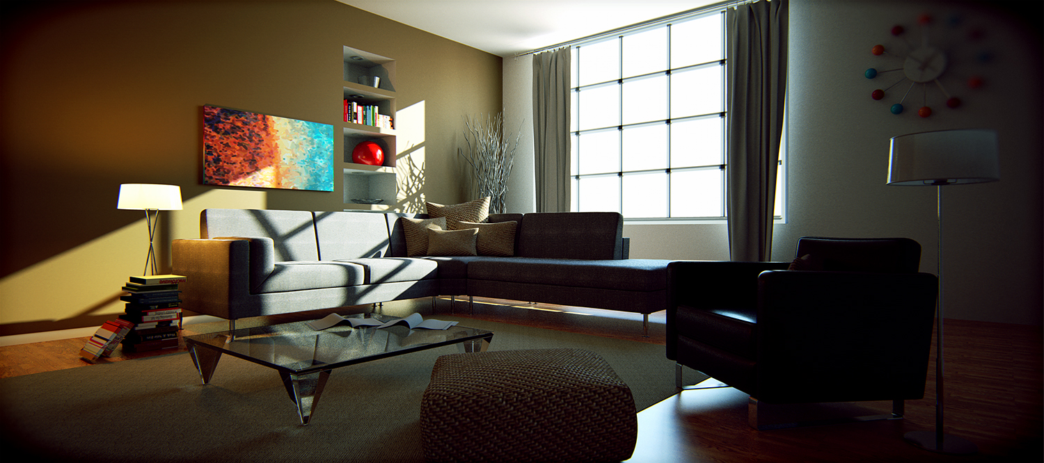

Hey guys,
First post! I come from a Mental Ray background and am now testing an Indigo release that a friend has been gracious enough to cook for me. Im very impressed with the overall 'feel' of the images coming out of Indigo, but im a bit perplexed by the noise issue.
Here is a test Im working on from an old Evermotion scene. This cooked for 15 hours on an Intel i7 920 2.7Ghz machine.
Settings: Splat, box (attempt to trade off sharpness with noise), Mitchell netra, Ring .6, Blur .3
MLT+bidir.
Im particularly interested in the noise around the coffee table glass (not arch glass, but glass with precedence 6, no dispersion) and under the sofa on the floor. Also, in the built-in wall shelves.
I understand the wall shelves would theoretically need a ton of ray lookups to smooth this out, but im curious if this thing should be cooking longer?
File is downsized from 2k res. I also took some 'creative' liberty in Post in Pshop. :mrgreen:
Any tips would be helpful!

Hey sculptera, welcome to Indigo :)
Regarding your questions, just a few notes:
Try Box Fastbox filter for faster convergance link1, link2
Your Scene also "begs" for usage of Exit Portals to speed up rendering a lot, did you used some?
Your MN Filter for SuberSampling Downsize Calculation @ R=.6, B=.3 is maybe not best choice. High R Values tend to preserves noise, what about the good old 0.333/0.333?!
Precedence In Indigo is only interesting if various Specular Materials overlap with each other (Glass+Wine for Example) higher Precedence "wins" and cuts off lower: You end up with perfect wine filled glass without any air between glass material & Wine material.
Regarding The Noise in the shelves & under the Sofa I would encourage you trying the Fastbox filter + A ExitPortal for the window.
Also try for the Curtain material to blend it with a Diffuse Transmitter Material (50/50) so some diffuse light passes throough and they don't look that solid ;-)

maybe change color mapping ? now in scene is too big contrast. Clock from Vitra I think is too big, turn on right lamp and maybe add some spot lights (IES)
