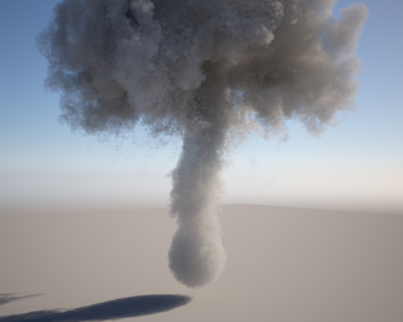

CTZn wrote:Well, since you like it here's frame 60 !
http://www.worldparallelftp.com/adam/me ... HR.60.pigs (9.56MB)
You may want to change or remove the spp limitation.
The simulation is a tweaked flame preset in Maya. Dealing with emission temperature may be more complex to implement for me, I'd take any hint, C&C's.
Nice. It renders pretty fast.

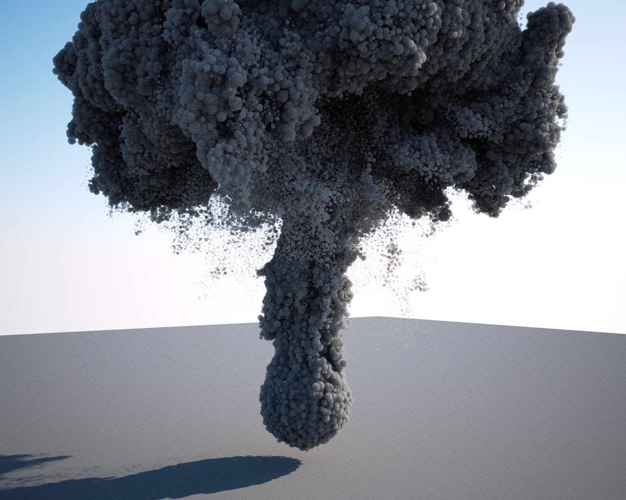

Hi CTZn,
You could try using a specular material, IOR 1, with some scattering and/or absorption.
This render was absorption coeff = 1m^-1, same for scattering coeff.
It renders a lot slower though :)
Re: WIPs: CTZn
Post by CTZn » Sat Sep 07, 2013 12:45 am
I did in earlier tests, and will further. It's good for thick smoke !
Because I also used a strong forward scattering (g spectrum of 0.85, clouds approximation) I was having an issue with fireflies. MLT was hardly helping in regard with my rig power. Looking forward for its announced enhancement ! I've been playing with ROND to avoid TIR on nearly parallel intersections since.
I'm still in an evaluation/dev process so I may be emphazing on previz for a little while (DT was fast) ! I wanted to try a DT/null mix based on ISL noise. Bump mapping does some trick too.
By the way Ono, should the IOR be 1.0 or 1.0029 ?

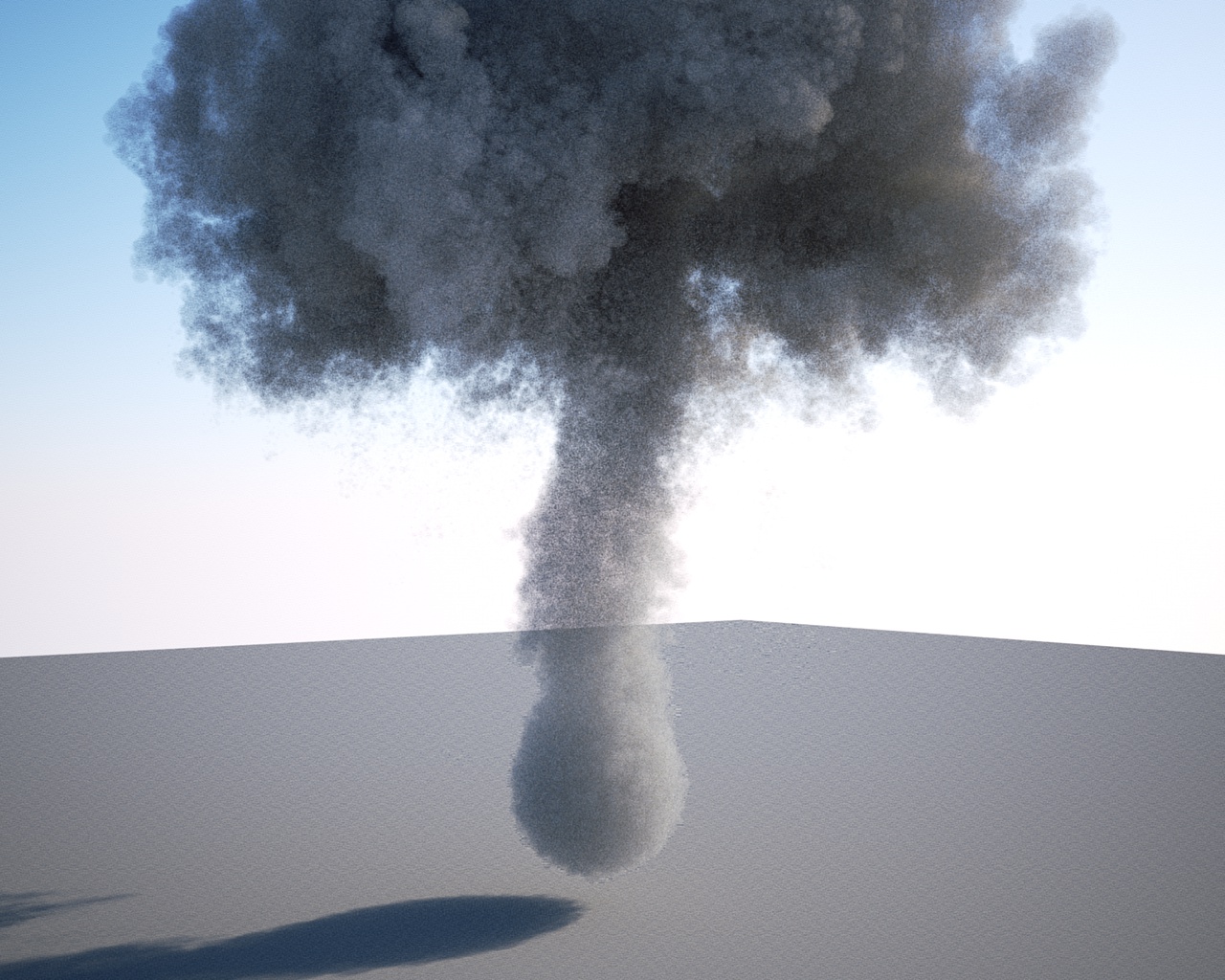

Re: WIPs: CTZn
Post by OnoSendai » Sat Sep 07, 2013 1:01 am
You want to use IOR 1.0 exactly. it's very important for fast rendering.
Here's another one, with scattering and absorption coeff 0.1:
Re: WIPs: CTZn
Post by CTZn » Sat Sep 07, 2013 1:42 am
OnoSendai wrote:You want to use IOR 1.0 exactly. it's very important for fast rendering.
Hence my concern with IOR, thanks for clarifying !
Subsurface scattering is definitely the way to go. I would expect clamping spheres to a diameter of 1.4x the voxel width (w/ jitter removal ?) to homogenize the medium setup somewhat, allowing for step size/ROND optimizations.
Though that should only be a concern with very large datasets I'd assume. Will resume works on this later, there is some more available data worth exploring !

Post by Zom-B » Sat Sep 07, 2013 3:04 am
OnoSendai wrote:Here's another one, with scattering and absorption coeff 0.1:
I let this one cook a little longer, used PT with new sky model and different tonemapping:

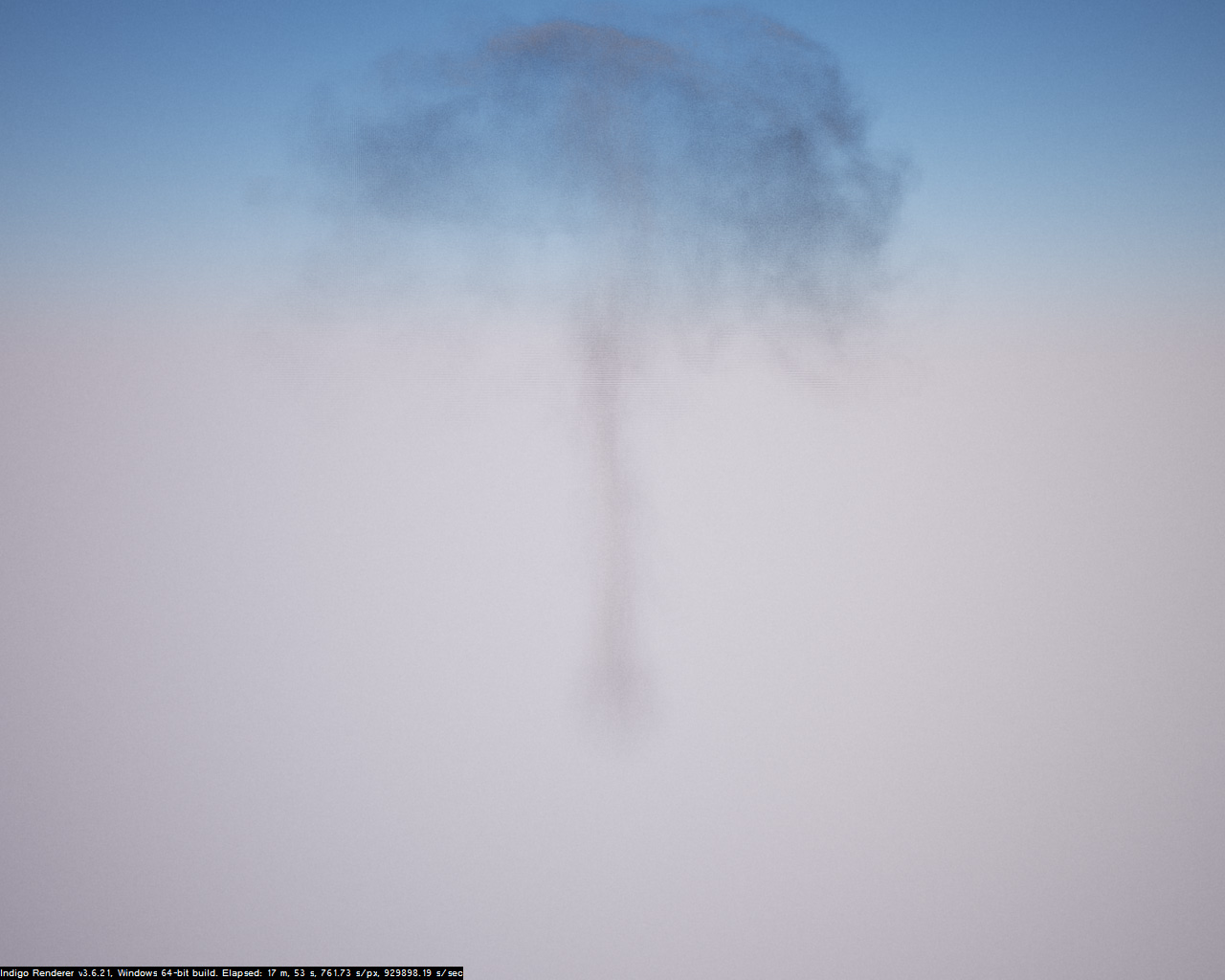

Post by CTZn » Sat Sep 14, 2013 12:31 pm
Hi, I have exported frame 59 from a new simulation run at 3x the previous resolution; however, the sole IGS weights 860MB (nearly 6 millions spheres !) and my pc does quite not have enough RAM to test-render the frame, it's swapping disks to death.
So if you have 12 or more GB available (my rig's got 8GB) and would like to render that frame, I can link you to the zipped version (141MB).
Please PM me for the matter.
for the record, the 120 IGS's for the anim I posted weight 10GB together :)
Re: WIPs: CTZn
Post by Zom-B » Sat Sep 14, 2013 11:27 pm
Here we go:
Loading and preparing scene took 72sec ^^
It seems you reduced the spere size a lot, and by that the smoke is way thiner as before.
You also can notice some "line artifacts" that seem to happen because of the simple box grid arangement of the speheres, so that gaps can be viewable...
