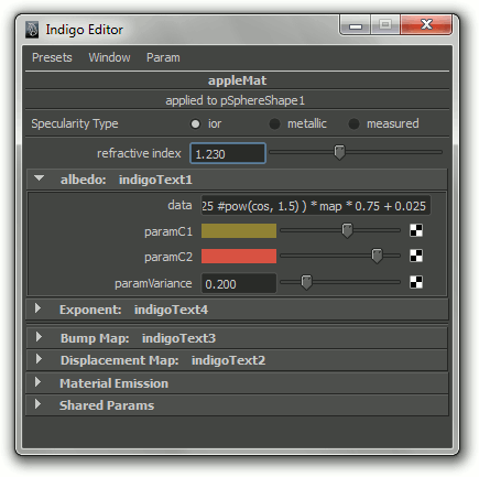

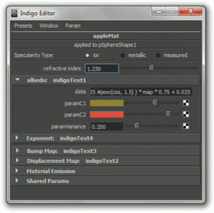

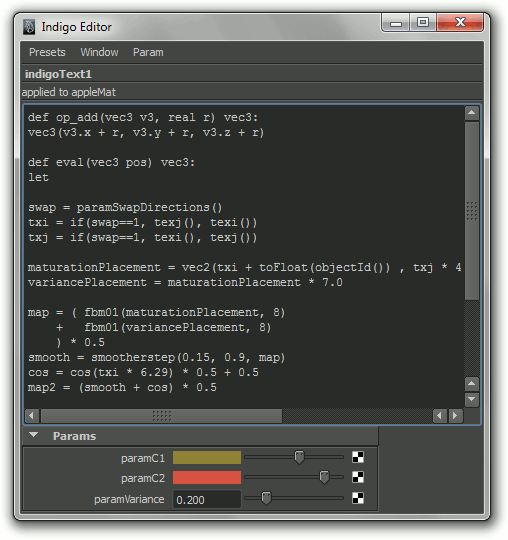

The apple shader is now a full Maya shading network.
I'll see to setup something better.

edit: attached the main material UI in Maya.
ps: the displacement strength has got no slider set, one must edit the last multiplier in the code. I mean to modulate that strength with each particle instance radius (MEL within ISL).

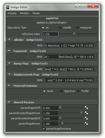

Re: WIPs: CTZn
params added to shader nodes (hence, non-shared params) are now showing up in the material editor.
Note that shared code and shared textures are to be assigned to a color param of a material.

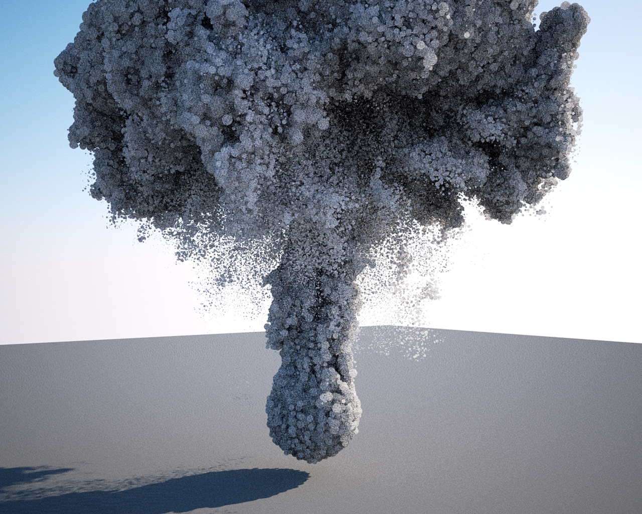

Some progresses made with exporting voxel data to Indigo with the Maya Embedded Language.
The simulation took 3h50 to run and export, that's 120 frames. The last frame took 6mn to export on one thread, and the corresponding IGS weights 332MB of tightly packed spheres:
Amusingly enough, the rendering time was similar 1280x1024 ss2 @20spp (3h40).
Attached frame #60, inb4 the video.

...Attached frame #60, inb4 the video.

I think the exporter is practicable for some really HD fluid simulation... in a still image
For the record I once waited 28h to export one frame (granted, something went wrong and I worked the code out since).
Added voxel space jitter and enough UI controls to tweak the final look. On shading, there's room for some ISL based on distance to the fluid emitter. that's plain diffuse_transmitter with no medium.
I should clamp the spheres radius again; though they add drama, big spheres are also reducing the shading accuracy.
Looking forward for fun ways to use point data in Indigo.

Well, since you like it here's frame 60 !
http://www.worldparallelftp.com/adam/me ... HR.60.pigs (9.56MB)
You may want to change or remove the spp limitation.
The simulation is a tweaked flame preset in Maya. Dealing with emission temperature may be more complex to implement for me, I'd take any hint, C&C's.
