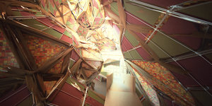

Finally here's a new render. There is tons of geometry and SSS going on and unfortunately I did not bother enough to optimize the scene, so it did not converge as good as I thought after 17h of rendering.

New favourite I think. SSS?

Thank you! By SSS I mean Subsurface Scattering.
Every object except for the metal frames and some wall parts has SSS applied. Could have/ should have used rough Oren Nayar for the red and green plates instead, but now it's too late : D

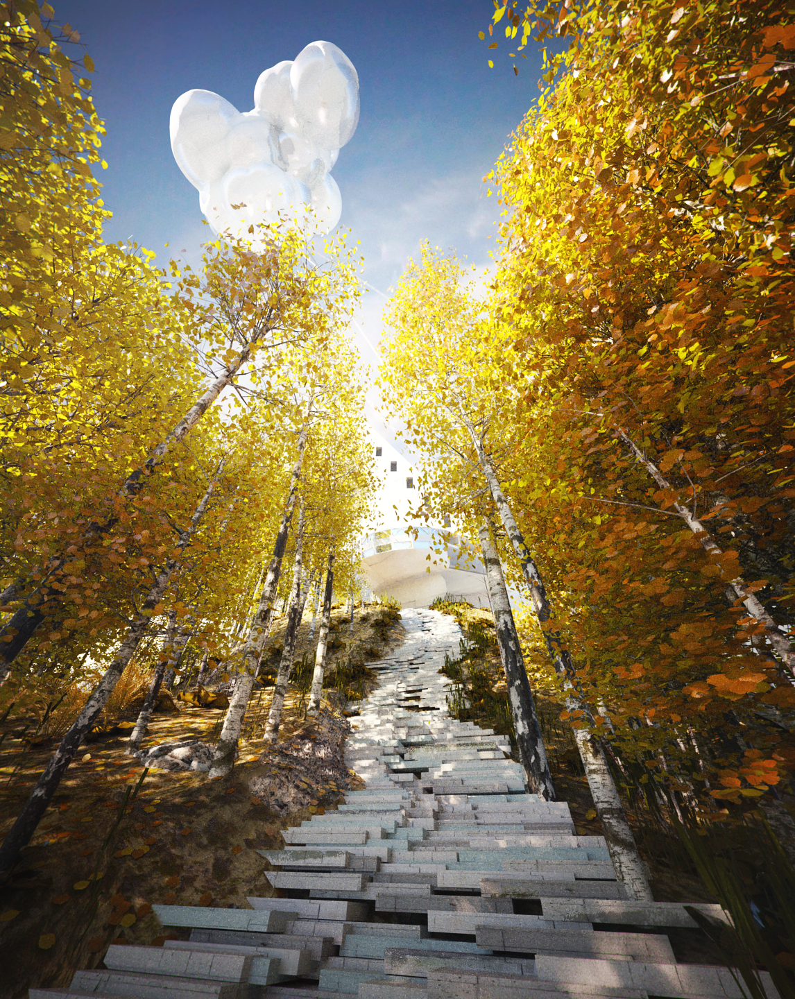

Post by CTZn » Fri Jul 26, 2013 5:05 am
last image: looks like my masterwork if I was to pretend I'm an architect :lol:
Each tile is geometry is it ?

@CTZn Hah thanks man! Pseudo architecture is awesome. The big tiles are all geometry indeed, the very small tiles are texture based if you mean those.
Finally made a render with double sided leaf materials :P

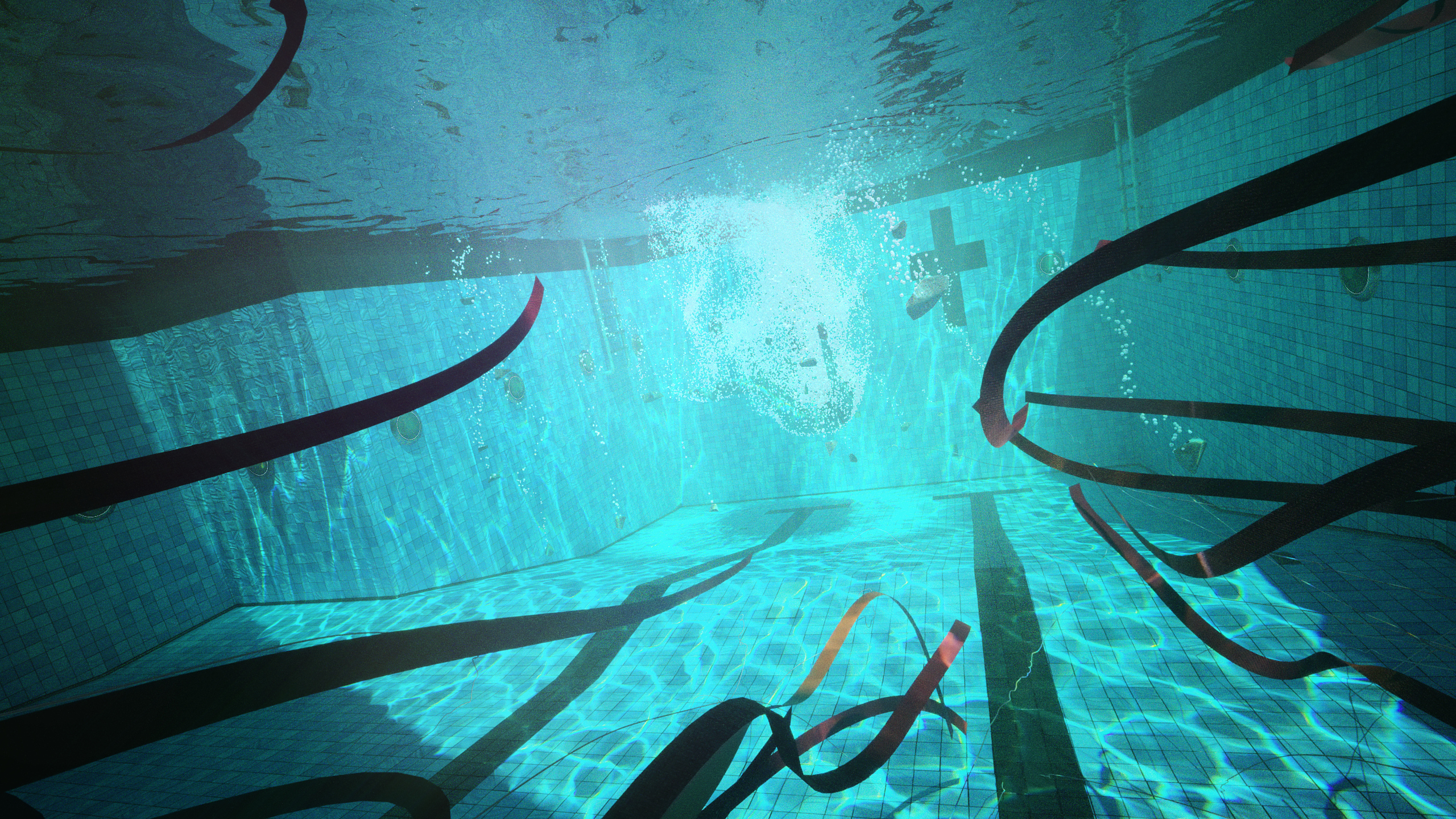

This one is inspired by Bosseye's pool renders. I also wanted to give SSS volumes a try without using MLT, which might not be the best setting for this particular scene in some ways. Rendered for 22h on my machine with SS5.

trip-hop ?
Well, it's disturbing but creative, good one kklors.
Hold on, that's SSS AND dispersion is it ?

I hope you don't mind me saying, but I think the ?ribbons? in the foreground complicate the image a bit - I think it could look good with just the pool and figure with bubbles.

Post by Oscar J » Tue Aug 20, 2013 5:38 pm
Whoa are those bubbles modelled?
I agree. Then again I almost wanted them to be tentacles instead of ribbons :)

@CTZn:
Listened to the Vintage Well EP by Deaf Center. Hard to define the genre, but it's ultra awesome moody.
And yeah the water's a SSS volume with cauchy. Using an exit portal helped a lot to get it not freak out without MLT.
@Ono and Voytech:
I understand what you mean and you're both right maybe. My very first concept idea was exactly having someone fall into a pool and have red cloth weaving from behind the camera framing the falling subject. Usually I let concepts go easily when they don't work out. In this particular case I wanted to have them in real bad : D
@OscarJ: Yeah haha! I emitted over a million low res spheres from the body. Was very tempting to fake them in in post, but decided against it in the end. Here's a wireframe to see the chaos better: http://abload.de/img/wireafba8.jpg
