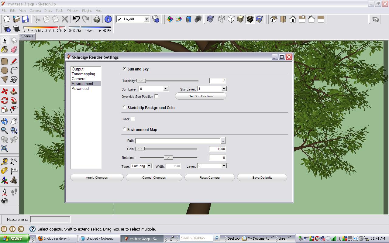

sorry, but since you use the skp I wonder if you use the hdr map, how can you change the sky light so smooth?

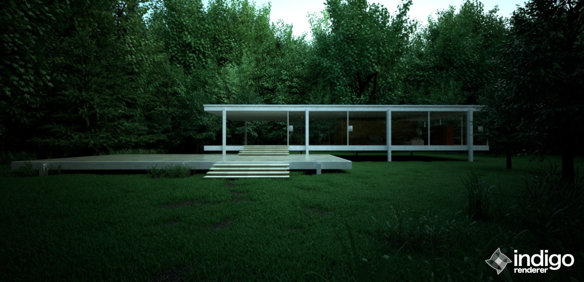

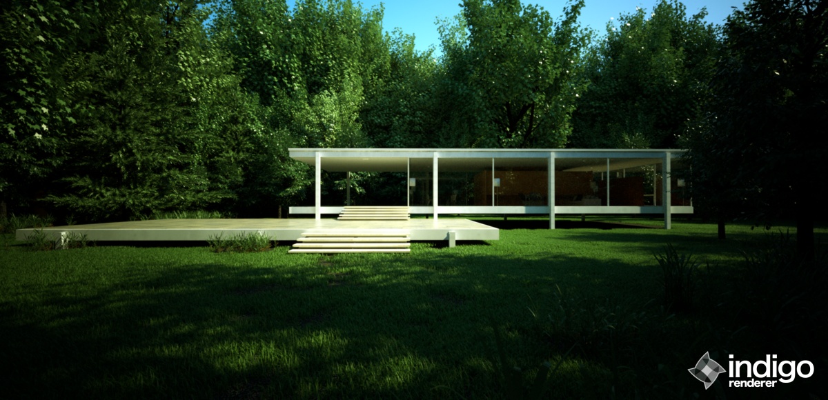

dakiru wrote:That's very impressive, Jeff! environment 2c and environment 1c almost look like a good photo. :shock:
Thanks dakiru. For those two images, I used the F250CD camera response function.

StompinTom wrote:Some things look a bit too shiny to me, but damn, that environment is looking good! Very natural-looking!
Thanks Tom. I already lowered the exponent value on that grass to 50 but it was still shiny. It must be lowered even further.

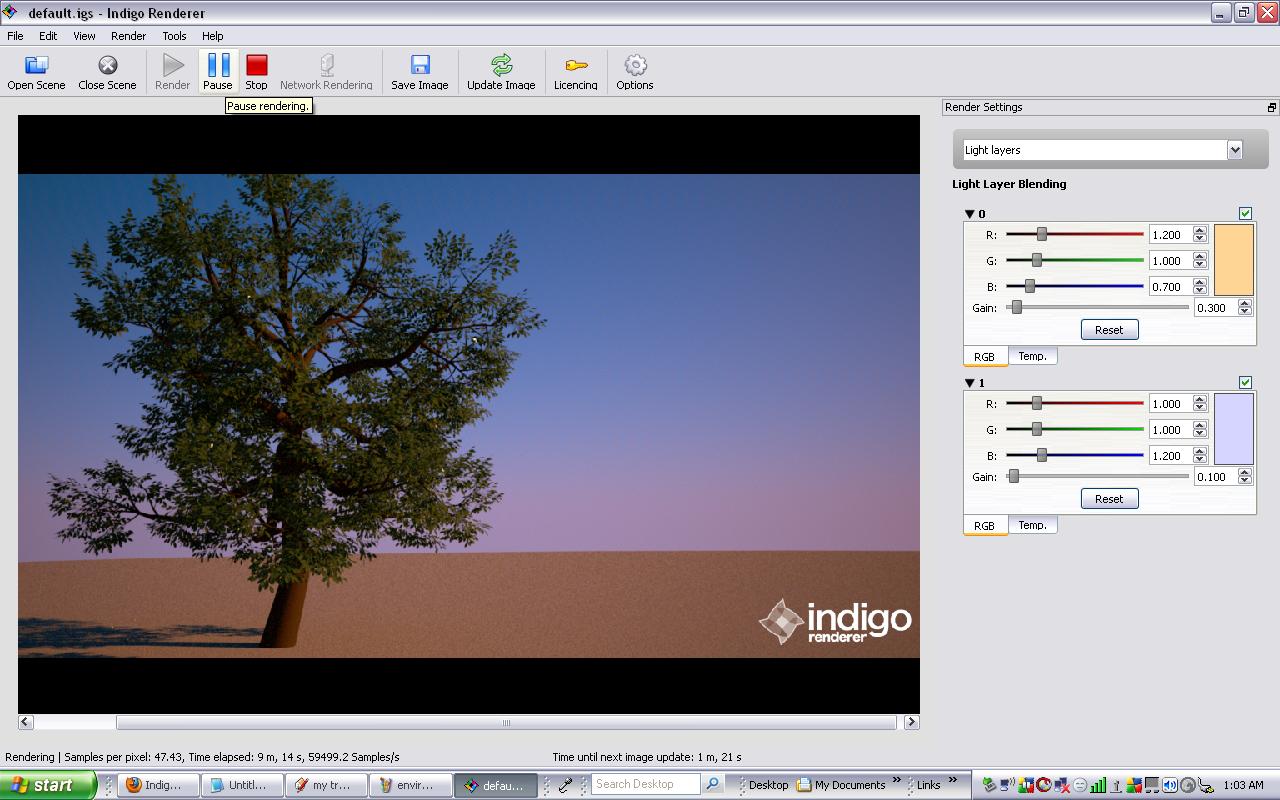

PowerMax wrote:sorry, but since you use the skp I wonder if you use the hdr map, how can you change the sky light so smooth?
I use the sketchup sun and sky for most of the renderings on this thread. The color of the sky can be changed under the light layers. To assign layers to the sun & sky, open render settings and choose the environment. Assign layers as shown. (see attachments) During rendering change the values on the sun or sky layer to get desired results.
Cheers!

Thank you very~~~~much to tell me how to set the enviriment. person like you to willing to share is rare these day.
Try exponent 20 with IOR or 1.6 or a bit lower. It's been working for me but see how it looks...

Posts: 112
Re: Architectural Visualization Study - The Farnsworth House
Post by Jeff » Mon Jun 21, 2010 1:13 pm

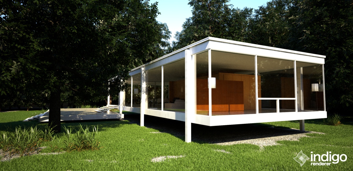

Some updates. Nothing special. Just fixed the grass. It is no longer shiny.
Post by Pibuz » Mon Jun 21, 2010 9:49 pm
Sorry Jeff to bother you.
Do you still achieve half-diffuse grass setting its SU opacity to values different from 100? Because it seems that here the feature is broken or something.
I'll post some tests but if I set a normal plastic and then I select an opacity value different from 100%, the material is rendered just the same.
Jeff
Posts: 112
Post by Jeff » Tue Jun 22, 2010 4:57 pm
Hi Pibuz!
Yes, it is still working. I am also using the 50% opacity & dull plastic material preset on the leaves and it is noticeable on some of the foliage on the first set of renders on page 4. I also used it on the grass for the GH house.
Jeff

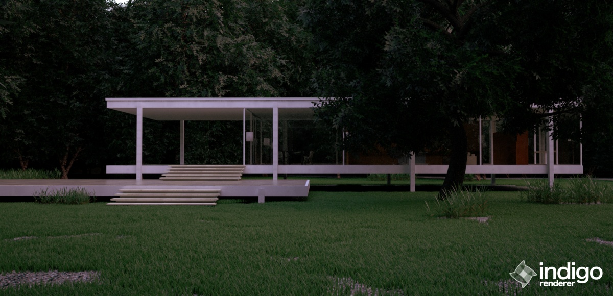

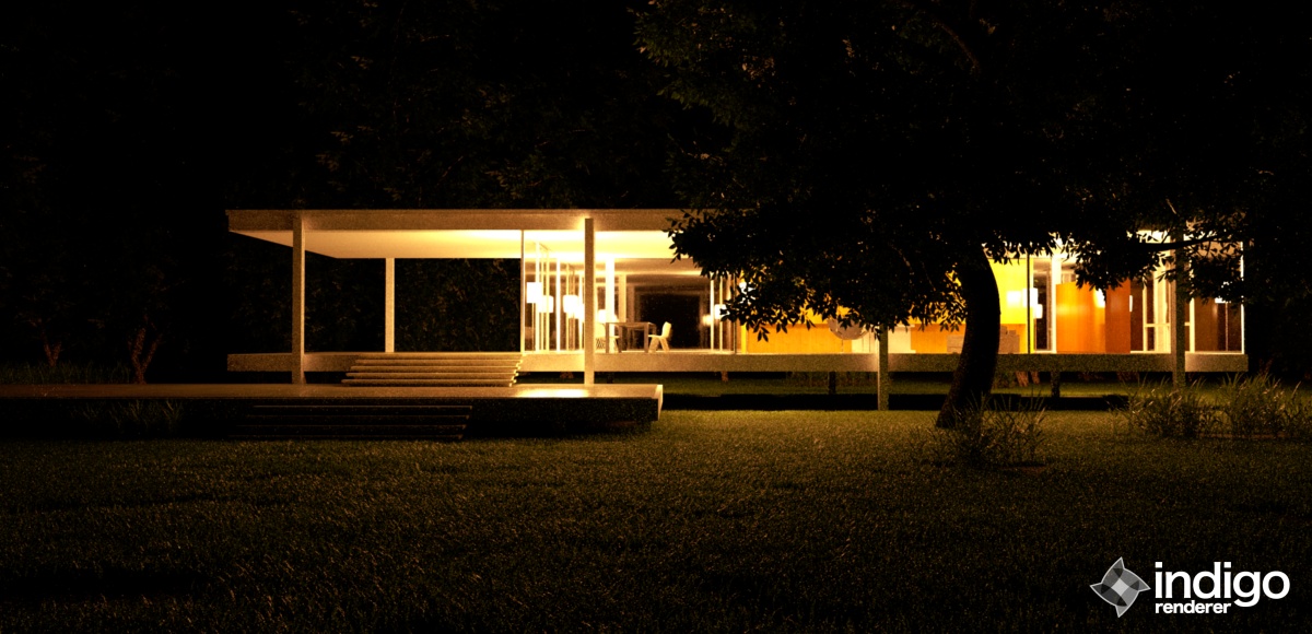

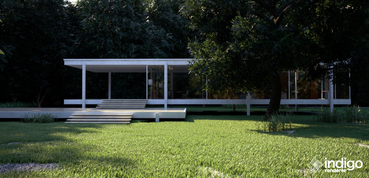

Post by Jeff » Tue Jun 22, 2010 5:18 pm
Just re-rendered some old scenes again. The only major change here was the elevation of the house. It is much lower now. The first step on the stair is now at the right height from the ground.
Post by Jeff » Thu Sep 23, 2010 5:16 pm

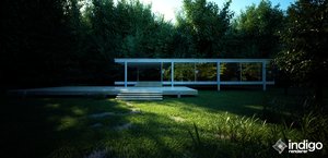

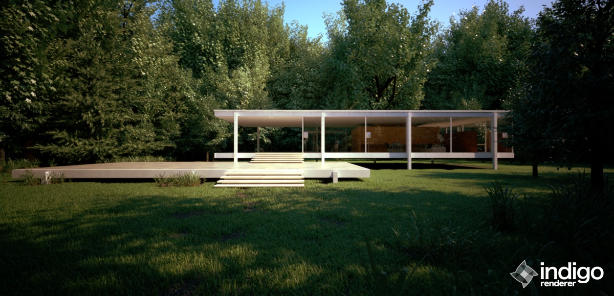

I finally had time to restart this WIP. On this update, some of the vegetation had been replaced.
