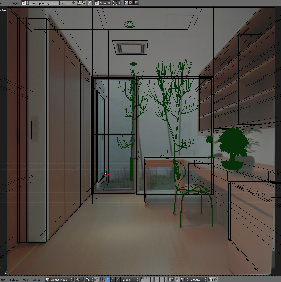

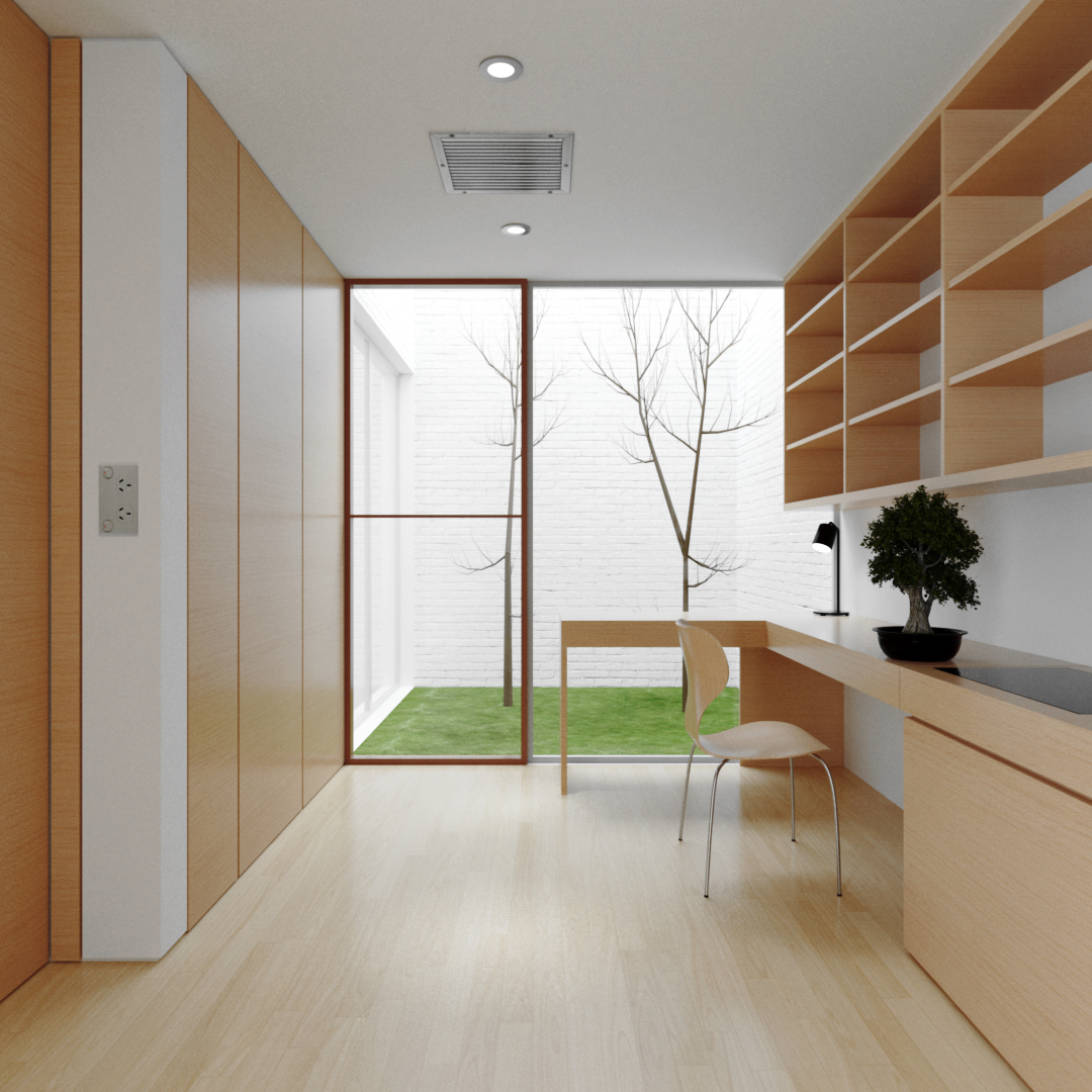

OK, here's some progress, but first I want to thank you all for all the tips and recommendations.
Changes:
-Added the ies lights (though the spots are barely visible on the floor)
-Added the desk lamp in the reference
-Added the bonsai in the reference
And I tried some color grading following Oscar's recommendations, but there's still a lot to learn
regards,
Alvaro
Changes:
regards,
Alvaro

Hi Alvaro (hope I remember your correct name
You're doing a great work here!
I just want to contribute with a couple small tips:
1. Try to work a little more on the door frame: though it's very light, it has lots of details and they should be reproduced to get a realistic image; also, I think the right vertical strut is thicker than the one you're guessing, although it's not clearly visible.
2. Beware that very rarely you can get the same wood type for furnishing and doors, so you should consider changing one with another texture (or at least the colour).
3. The door frame normally hits the gound (or so): leave just 1mm or 2 on the bottom, not to make the corners too flat, but simulate the contact.
4. Even if they seem perfect, the corners of wood tables are always bevelled, so try cutting the corners a little, say 0.5mm in order to achieve a better looking result (it's the kind of things the human eye notices but can't refer to specific faults)
5. I think the bottom of the hung library is wooden too; and I'm also quite sure that the vertical elements of the library show the wood seams in the vertical direction.
I think I'm done, hope I helped!

You sure did!
Yup, Alvaro is my name, you remembered it perfectly! Thanks a lot for the comments and all the feedback. I feel honored to get such criticism from someone with your experience. And yup, you're right in all of your observations, I shall put them into practice
About the wood texture, they're different but probably the tone is very similar. The one for the floor is like a parquet whereas the one for the furniture is a regular fine wood (pine). I'll try to vary the tones to get a better contrast.
A final version shall come, according to the prophecy of the wooden interior!
grazie mille!
grazie mille!

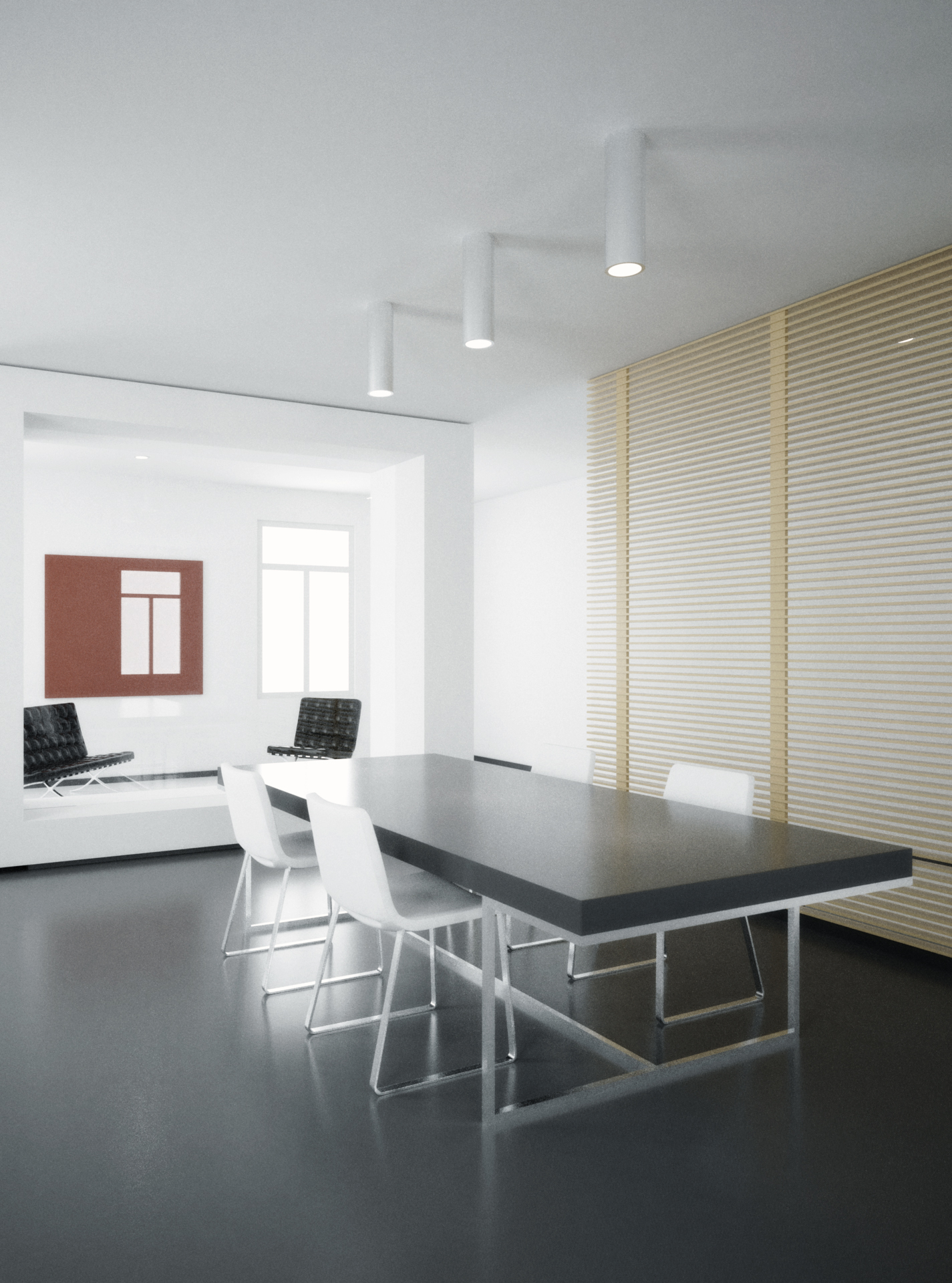

While I work on the "final touches" of the previous render, I started working on this new one. This version is a tonal study, before materials.
regards, and merry xmas to all!
Alvaro

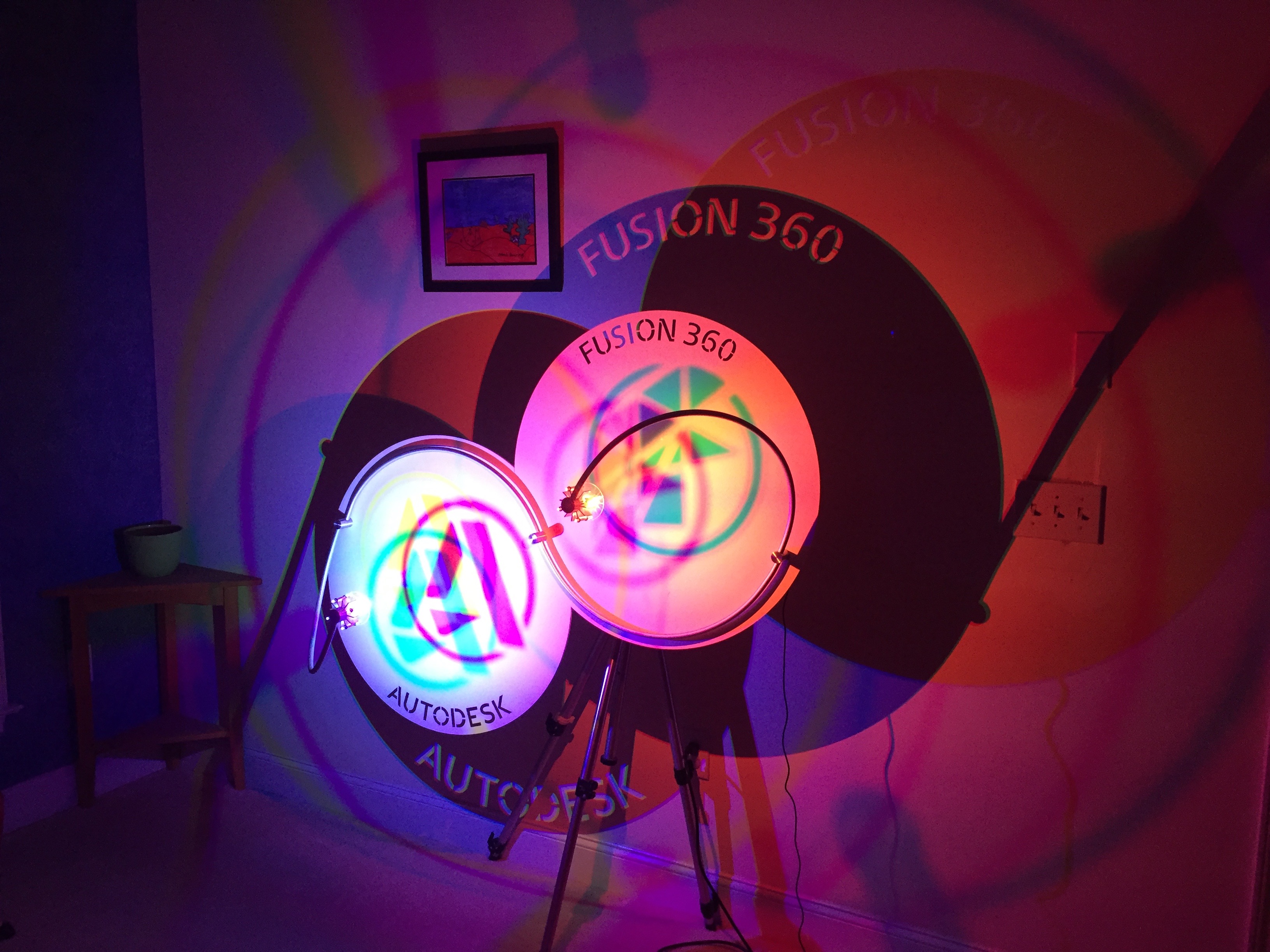

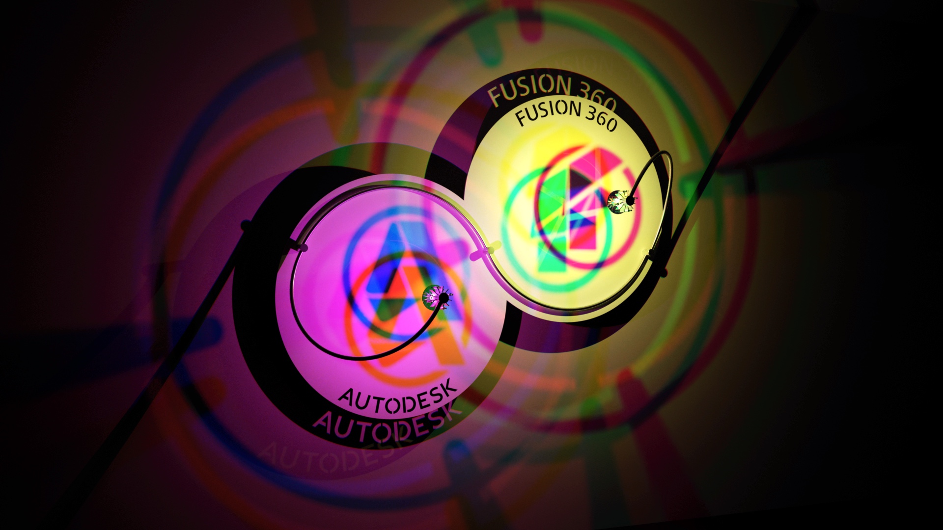

The images below are for a commissioned piece. One is an Indigo rendering used to develop these LED lamps, the other one is a pretty bad photo with an iPhone 6 camera. There is nothing calibrated in my workflow, the rendering is straight off Indigo (no post processing) and the photo also has not gone through any image processing other than what the iPhone camera does on it's own, which butchers the saturated colors of the LED quite a bit.
ATI Radeon HD 5750M 1024 MB
OS X 10.10.3 Yosemite
- Oscar J
- Posts: 2204
- 3D Software: Blender
Cool! Any reason for the Autodesk logo?
