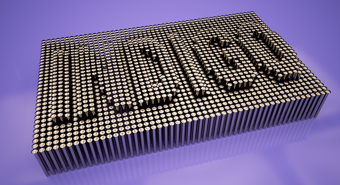

Voytech
Posts: 236
Post by Voytech » Wed Mar 21, 2012 3:01 am
OnoSendai wrote:Voytech:
Awesome, the block render is very realistic.
Means a lot coming from you :) Thanks. It took about 2h to model and texture. I went a touch too far with the bump on the wood but didn't feel like re-rendering. I'm on a 2006 iMac so EVERYTHING takes a long time.
Oh and this is Sketchup with Skindigo.
Post by lycium » Wed Mar 21, 2012 6:10 am
I'm guessing from the noise that it was rendered with MLT, I strongly suggest you render simple exteriors like this with non-MLT, non-bidir PT. It'll be about 4-5x faster to converge, if not more :)
Voytech
Posts: 236
Post by Voytech » Wed Mar 21, 2012 6:37 am
lycium wrote:
No MLT. This was either straight PT or bi-dir (can't remember) with super sampling factor of 3. If you're talking about the noise on the floor, that's a ISL shader for bump to make the surface less uniform.

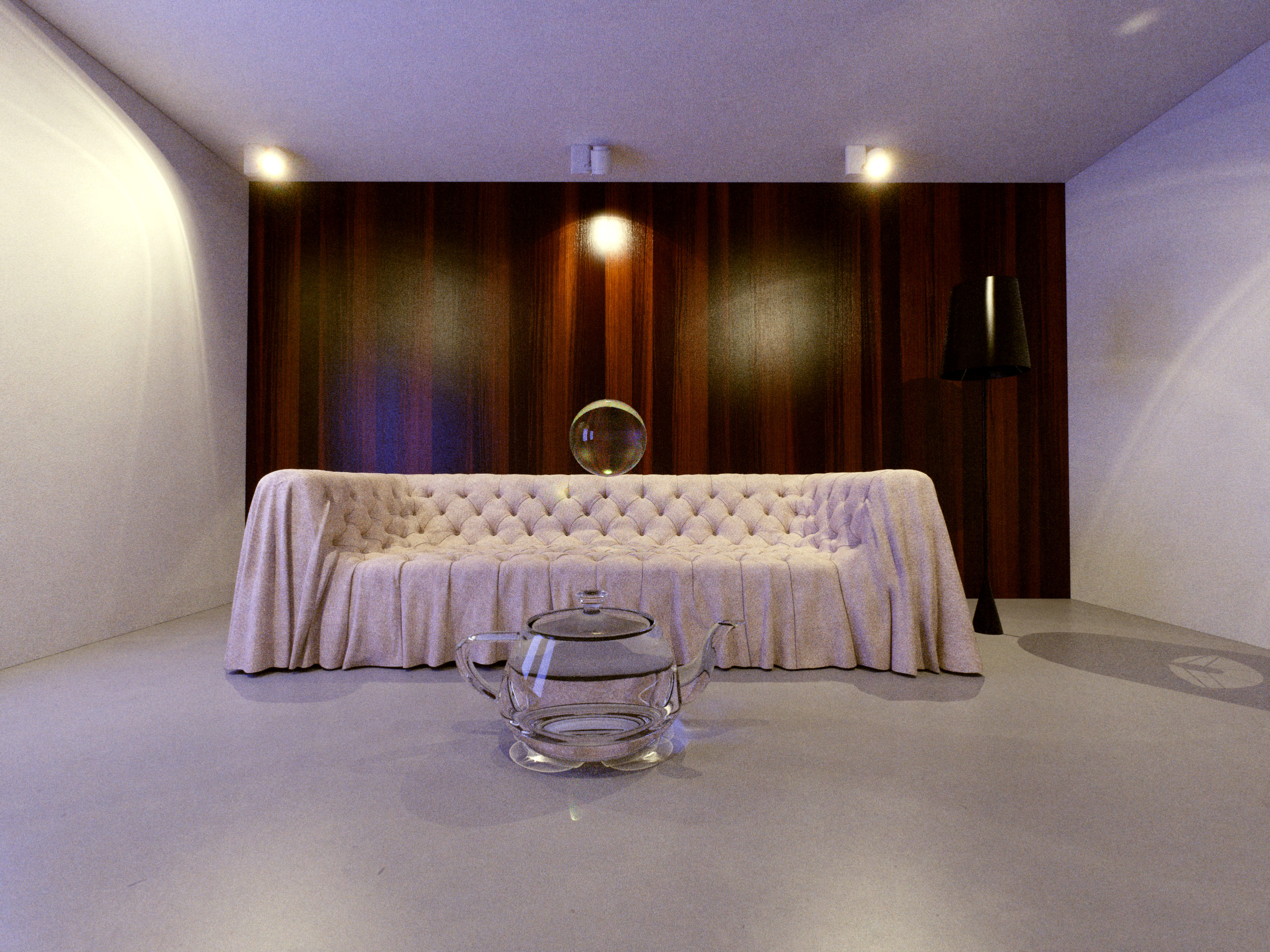

dcm
Posts: 663
Post by dcm » Thu Mar 22, 2012 11:43 am
i tested 5x5x2,65m box with walls,floor, 6x IES lights and one small window with environment color (pinkish)
quite impressive result for room lit by IES lights only, all IES are 35w and 3600k temperature.
aperture diffraciton : ON
Post by OnoSendai » Thu Mar 22, 2012 11:47 am
Dcm: Nice test!
IES lights don't have the most efficient sampling right now, I'll have to work on improving that soon :)
dcm
Posts: 663
Post by dcm » Thu Mar 22, 2012 11:50 am
ono : thanks.
would be great to have option to select shadow "shape". I prefer softer shadows from spotlights. As you can see, ies are generating quite sharp shadows tbh
i used AD because of nice light effect comming from spotlight`s reflector beams. Without AD, reflectors are empty because IES is not physically based light and its looking weird. I prefer using AD instead of placit emitters to reflector beams and doubling rendertimes having x2 emitters in scene.
Post by OnoSendai » Thu Mar 22, 2012 11:54 am
Yeah, there is an issue with IES lights that there is no light coming out 'sideways', hence they sometimes appear black. I think a solution to this that I could implement is to always emit a little bit of light in all directions, in addition to the profile described in the IES file.
dcm
Posts: 663
Post by dcm » Thu Mar 22, 2012 11:55 am
and something like "shadow smoothness" ? 1 - smooth shadows, 2-3-4-5 = very sharp shadows ?
possible ?
Post by OnoSendai » Thu Mar 22, 2012 11:56 am
Do you mean shadow smoothness as cast from IES lights? If you want smoother shadows, you can always make the light source bigger.
dcm
Posts: 663
Post by dcm » Thu Mar 22, 2012 12:08 pm
but making bigger IES which is built in spotlight = big aperture diffraction effect, no?

dcm wrote:but making bigger IES which is built in spotlight = big aperture diffraction effect, no?
Making the IES emitter bigger will change the A.D. effect a little, but will still look mostly the same.
