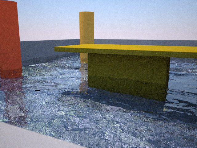

I am finding a max change value of 0.005 working much better for the caustics and general MLT stuff in V0.9 test 8. It clumps the MLT samples closer together so you get a smoother more dense look. Under water stuff converges faster.
With max change of 0.01 (default value) or higher, you get more patchy look and you don't get the caustics showing up in a curvy line in one pass
Only downside is the render has a more muddy look that takes at least 1000 samples to smooth out.
the same render from above using default values of Large mutation probablity 0.4, MNCR 1000 but with max change of 0.005
ignore the shading errors with smoothing on
You can see it looks much better than the render one above.
Although I had water smoothing turned off in the above render.
Still not fully converged, but you get the idea - caustics show in v0.9 test 8!

no water smoothing... looks a bit strange
nice to have the sun go through water!
The water in this scene rendered really fast compared to the one above.
I don't know why either
Maybe it's because the Sun is facing directly down, ie like in a Noon position. So most of the caustics reflections go straight up into the air

this one is up to 2700 samples, but yet it's still not converged yet caustics wise. The sunlight renders under the water really slowly compared to the above renders. I don't why either, as it's much lower poly count wise in the water and more uniform wave wise! 4000 polys vs some of the above where they are at least 66,000...
And I deliberately made the scene/objects smaller so it would render faster...
The wave do stick up more, but who knows...
I used default settings with max change of 0.005, perhaps my usual MNCR of 30000 might do it better...
just textures, all diffuse materials and no bump maps

did another pic, put the sun in the noon position which seems to help MLT pick up the sun better. More absorption in the water and jacked MNCR up to 30,000 with large mutation probability of 0.66 and max change of 0.01
2700 samples. It's probbaly only half done, but shows a lot more than the pic above with MNCR 1000
