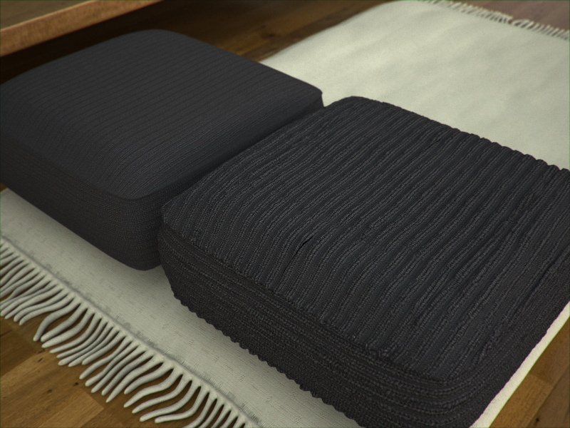

Post by drBouvierLeduc » Fri Feb 15, 2008 8:27 am
Cushion tests.
Left has a simple bump map, right is displaced (maybe too much).
I'm not happy with the carpet under, the ends look like flat spaghettis... Must find a way to add some fluf.

Post by BbB » Fri Feb 15, 2008 10:31 am
Very pleasant indeed. Your bump-mapped cushion suffers from the smoothing-breakdown-under-sharp-light-when-heavily-bumped problem. You're better off using the displaced pillow. But how many polys are you going to have in this scene? You might have to do some serious optimisation in order to push this through the exporter...

Post by drBouvierLeduc » Fri Feb 15, 2008 11:05 am
When lite whith hdri it looks much better.
For the moment the scene has 1,5millions polys, and is 2/3 finished.
The only way to export this is to split the big meshes is several parts (for instance the displaced cushion is split in 8 parts here).
Post by Kram1032 » Fri Feb 15, 2008 11:10 am
what's that strange black line on the displaced pillow?
Is it an error in displacement?

Post by drBouvierLeduc » Fri Feb 15, 2008 11:13 am
Yes it's a seam, where the mesh is split. That happens when you use several displace modifiers on the same mesh. It shouldn't be a problem on wider shots I guess.

Post by BbB » Fri Feb 15, 2008 8:05 pm
The smoothing errors, the split mesh, the mirrored UVs - none of this will be a problem in the wider shots so I wouldn't worry about these too much. You might even find that, from a distance, you don't get that big a difference between displacement and just bump.
Also, I know you said you're not too happy with the rug, but I think it will look good in the wider shots too.

Post by Big Fan » Fri Feb 15, 2008 8:31 pm
the rug is basically ok you know (perhaps with a bit more bump) its just the funny end bits - looks like an octopus was the victum of road rage
make 'em thinner, more of 'em and keep em the same width and length with squarish ends IMHO

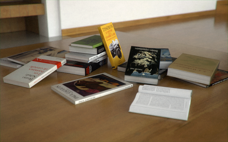

Post by drBouvierLeduc » Sun Feb 17, 2008 6:15 am
Well, I needed books for the library, so here they are, in random disposition.
Those things take much more time than I expected (scanning, uv-mapping...).
@BigFan : regarding the rug, I was planning to transform the dead octopus into fluffy bits, maybe with dupliverts.
books
