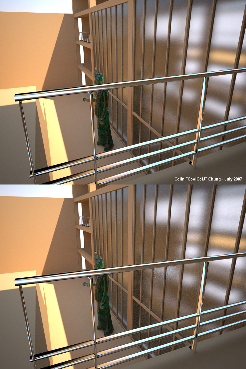

MLT vs PT
here are the pics
top is MLT and bottom is Path tracing - both rendered to 2000+ samples around 10 hours on my P4 3.2ghz system
you can see the MLT is much smoother in the glass area, PT was very slow here and didn't start to smooth out until after 1500 samples, but is still grainy. But the PT rendering is much more accurate in the glass statue, you can see more highlights in the hands etc
I think if I push the large Mutation probbility to 0.9, and the max change to 0.01 maybe it will be as accurate?

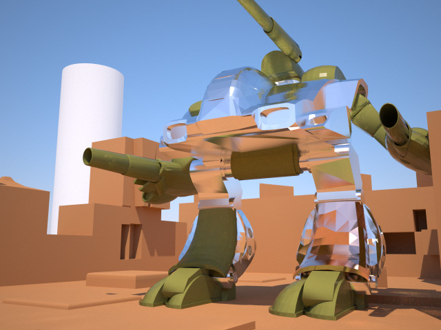

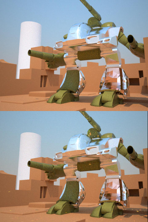

after 6 hours of render time - 4400 samples.
plenty of caustics in the scene - on the mech itself, especially the top part, on floor, side and back walls. Caustics are still being added into the render right now, so maybe another 6hours and there will be more and smoother etc
yeah there are smoothing normal issues....
added some bloom
doing another render with the small Mutation Change value of 0.002 and see how it compares
added some bloom

Well I tried the 0.002 setting, and while it looked smoother in caustics, it also had other problems like orange spots, whch I couldn't get rid of even resuming with other settings...
here is what it looks like after many hours and 15000 samples!
probbably over 24 hours now, but not much more
I used a ton of different settings on each render resume so not really a valid comaprison... anyway not a whole lot different looking, yeah caustics are more dense , smoother and more developed. Plus a little cleaner and more subtle shading in the darker areas, but not 10,000+ samples better

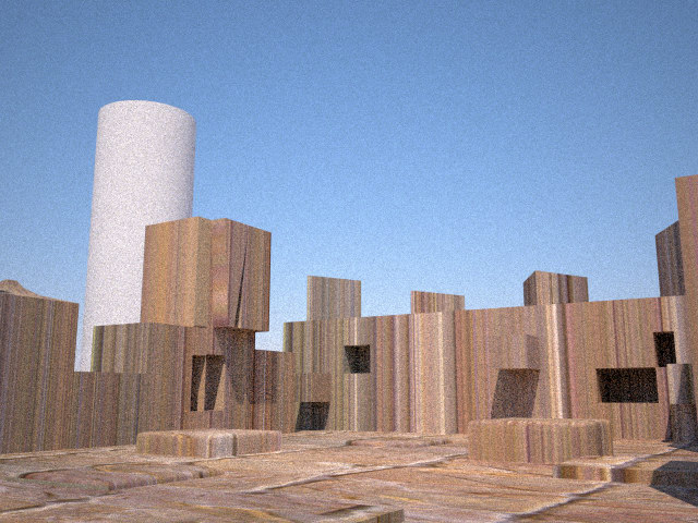

A texture test that went wrong, looks kinda cool
man if I only could get my textures settings as I use in Cinema 4D the same way in Indigo...this texture works fine Cubic mapped in C4D.
Trying to UV map this would take way too long and more complicated than it needs to be
right now I'm getting frustrated as hell with using textures in Indigo. It keeps telling 3 component jpegs not supported?! Jpegs are jpegs right?
So I convert them png files, ok renders it fine, and then next render I try, it will tell me the files are no longer png files and gives me an error!!!
So I convert them to BMP files, works fine for diffuse textues, and then I try it on bump map and it says 8 bit files not supported!!!!
arghhhh
arghhhh

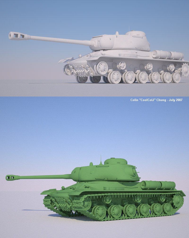

Did this yesterday, I love the quality of this render.
It's of a Russian IS-2 WW2 tank
One thing I like that it doesn't look like a "toy". You can sense the weight and size of the tank.
Usually in GI renderers it would look pretty toy like
I'd imagine, when full textured, bump and specular mapped it would look pretty photo realistic
But right now I am in no mood to export such a high poly model and test render when I have to sit through 10 mins worth of normal messages from Indigo with a Cindigo exported scene
Maybe I will try it in Sketchup if the exporter works with the free version, I can't get my head around blender right now...
top pic was rendered in Path Tracing, 2.5 hours, 1500 samples
bottom pic in MLT mode, just under 2 hours 1300 samples

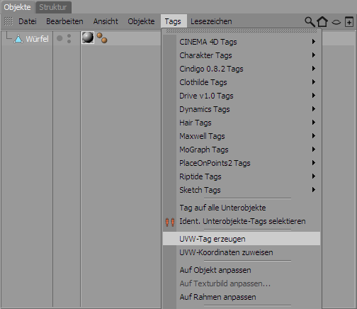

You know, if you ever need help getting your head around blender, there are loads of people (myself included) willing to help you get started. And there's the brilliant video tutorials (I mean BRILLIANT) on http://www.blenderunderground.com . You should have a look.
If you just don't like blender, ignore this post
Cindigo just exports UV mapped Textures correctly (as told in the Cindigo development Thread!)CoolColJ wrote:A texture test that went wrong, looks kinda cool![]()
To convert your cubic mapped texture to UVM, do it by hand (lol) or simply check the attached picture
To get your jpgs textures working in Indigo sinply use jpg's and save them in basline mode,
otherwise Indigo wont be happy!
Indigo doesn't like 8bit textures to (greyscale bumps for example)... and if Indigo tells you, it doesn't like 8bit, don't be sad, but convert it to a standard 24bit pictureCoolColJ wrote:So I convert them to BMP files, works fine for diffuse textues, and then I try it on bump map and it says 8 bit files not supported!!!!

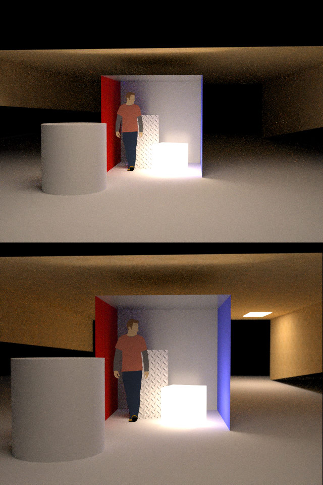

Sketchup is so easy to use, within minutes I got this scene up in Indigo 0.9 Test 3 - imported the Indigo test scene Cornell box, changed a few materials using the sketchup factory material/textures, fiddled with some exporter material settings, and wham bam thank you mam rendered a few images.
LOL you can even export out the default Sketchup figure
Good for scale purposes though
first one rendered for 1+ hour in MLT mode, 0.4 Mutation probability, 0.03 max change, 530+ samples.
2nd one in 1.5 hours, 700 samples
That box I used some metal textured material from Sketchup, and turned it into a phong material within the exporter with bump and specular mapping from the same texture. Although I should have used the aluminium NK data
I drew a square at the back and made it into a 100w light, a flat circle above as another 100w light and off course the cube acting as an 100w emitter.
I was able to workout most things. Except for some reason I could not get the material applied to the floor/cylinder to work
SO easy and fast - and if you have a quad core you could have 2 or more test renders going at once! I had 2 with my hyper threading single core P4
All this power and ease of use for free!!!!! I didn't even read the instructions
Man for quick visualisation of space and buildings/rooms you can't beat this. I can see why architects and such would love it
only problem is that is quite memory hungry, I couldn't import the tank into sketchup into it without killing all my memory at 40%, whereas Blender/C4D will have quite a bit of memory left. I have 1 gig. My new system will have 4 gigs though
Question Whatt how do I get the sky and sun up? I have it selected in the exporter, but I figure there must be something else I need to do?
now to work out how to save a camera position in Sketchup...
I finally have the setup I have longed for after mucking about in GI renderers all these years, gonna have some serious fun now
- Attachments
- CCJ_Sketchup_test.JPG (120.62 KiB) Viewed 10314 times
