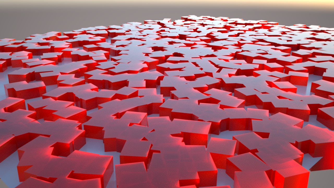

The first step of experiments with C4D + Surface SPREAD; 1000 cubes, material FSS.

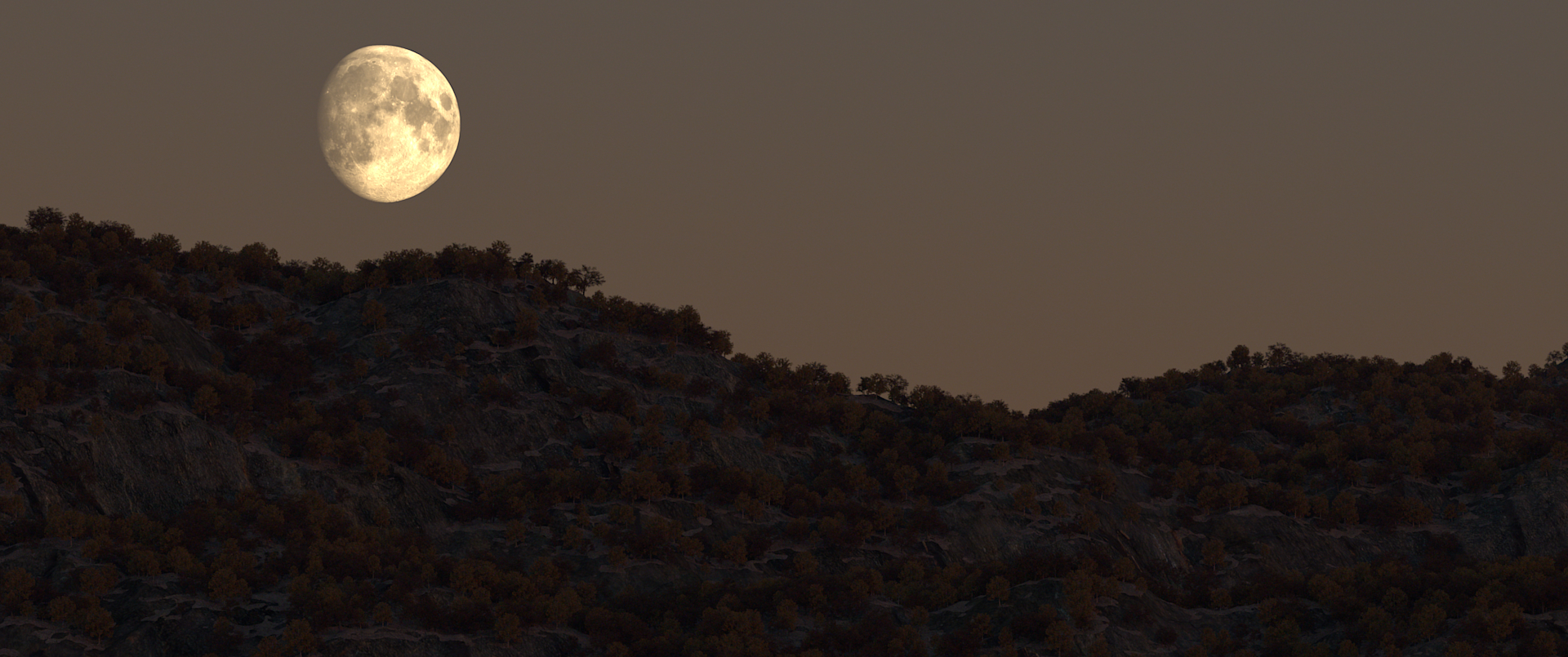

Thank you. The moon is at real scale trough atmosphere.
This is the procedure I follow more or less for the scatter. I´m waiting for some info on how to use the material slot. I´m not able to do it work. Also seems that the IGS or PIGS don´t save the info about this slot. The other day you post here an example that seems to work, but don´t worry, I´ll wait for some Ono´s example.

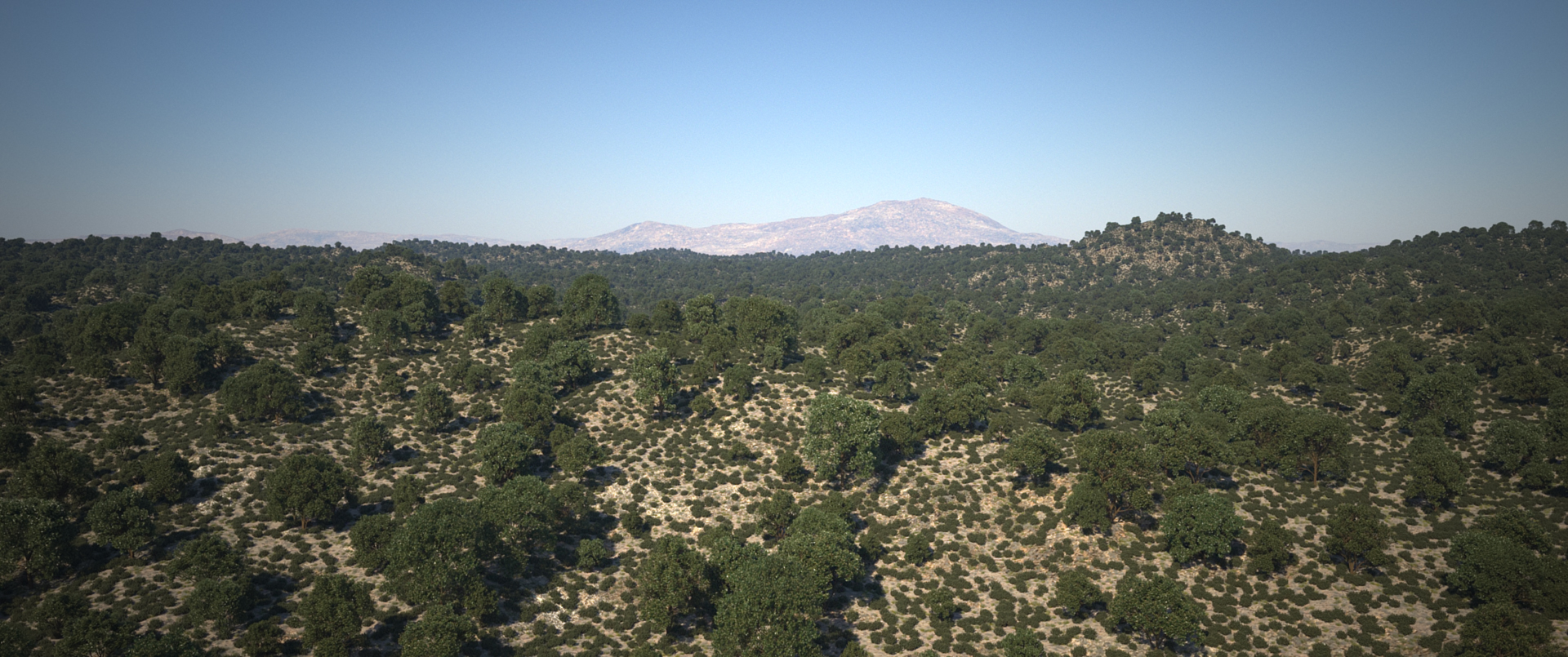

169 k samples/s, 2000 samples per pixel in 5 hours. 26 millions of instances. If I instanciated the back patch the igs file has over 2 gigas of space; in this case I can´t open the file to scatter the grass and the bushes.
Anybody knows about a XML editor capable of that?
