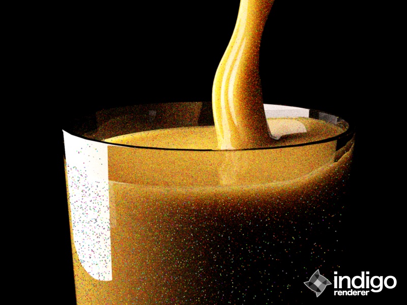

Purespider. There seams to be some common problems with sss.
CTZn: the glass material is a simple specular no sss on it.
Polinalkrimizei: Thats what i tought to....
Hope ono can shine some light on this ;)

Post by CTZn » Sat Jun 27, 2009 1:22 am
Okay, too bad :(
You are correct Polinalkrimizei, though, being different unbiased rendering techniques, each has its drawbacks, and bidir is only one step in the struggle of path tracing against nuked pixels (its very drawback I suppose).
Now, if that glass in the middle of nowhere then maybe the lighting is not "standard" enough, might be crucial for sss (sun is a small lightsource after all).

Post by Stromberg » Sat Jun 27, 2009 5:11 am
I did change the light source, to a bigger one...
Rendered with PT and BiDir for about 2 hours.

Post by dmn » Sat Jun 27, 2009 6:31 am
Motor oil mixed with caramel. Or maybe pecan pie filling? Either way, Mmmmmm :D

Post by Stromberg » Sat Jun 27, 2009 7:53 am
It looks more like motor oil right now then juice :lol:
Thats why i'm going to leave the juice rendering to suvakas the one who knows it :)

Post by CTZn » Sat Jun 27, 2009 11:52 am
Try MLT alone ? It will be weird for a moment, but with time... I seem to remember that suvakas affectionates simple MLT :) :?:
Ah blame me, I told you already. Am I noy getting old ?
At this stage if you are stuck with nuked pixels, you want to set supersampling to 2 or even 3 to disminuish their impact. They will always be of the size of one pixel so the higher the res the less annoyance.
There is perhaps something to fix here, this issue tend to appear with intersecting mediums, not always, but notably with the documented glass setup.
Tested against 2.0.8 ?

Post by Stromberg » Sat Jun 27, 2009 12:51 pm
Tried with 2.0.9 i think.
I gues this is a problem... but what do i know :P

Post by PureSpider » Sat Jun 27, 2009 9:55 pm
CTZn wrote:There is perhaps something to fix here, this issue tend to appear with intersecting mediums, not always, but notably with the documented glass setup.
Arne told me he had that bug with the mat test scene and milk aswell...

Post by Whaat » Sun Jun 28, 2009 6:33 am
Hey Stromberg,
What are your settings for the orange juice in your latest render?

Post by Stromberg » Mon Jun 29, 2009 9:10 am
Here we go... :oops:
<!--Generated by Cindigo 2.0.5-->
<!--Using TinyXml-->
<!--Developed by: Yves Colle aka 'fused'-->
<scenedata>
<material>
<name>nullMat</name>
<null_material />
</material>
<medium>
<name>MedJuice</name>
<precedence>100</precedence>
<basic>
<ior>1.300000</ior>
<cauchy_b_coeff>0.000000</cauchy_b_coeff>
<absorption_coefficient_spectrum>
<rgb>
<rgb>0.031373 0.145098 0.600000</rgb>
<gamma>1.000000</gamma>
</rgb>
</absorption_coefficient_spectrum>
<subsurface_scattering>
<scattering_coefficient_spectrum>
<rgb>
<rgb>0.980392 0.905882 0.603922</rgb>
</rgb>
</scattering_coefficient_spectrum>
<phase_function>
<uniform />
</phase_function>
</subsurface_scattering>
</basic>
</medium>
<material>
<name>Juice</name>
<specular>
<internal_medium_name>MedJuice</internal_medium_name>
<transparent>true</transparent>
</specular>
</material>
</scenedata>

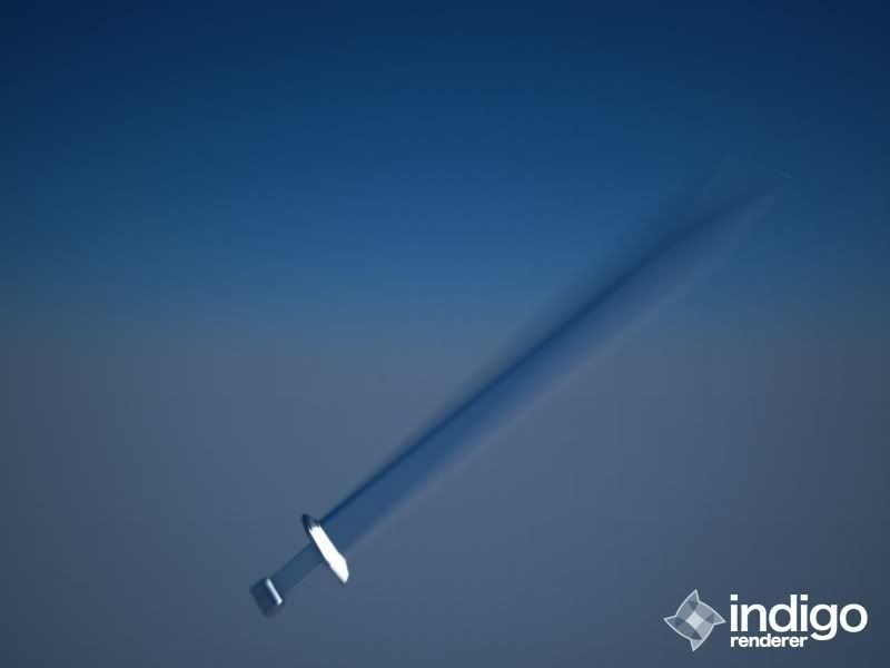

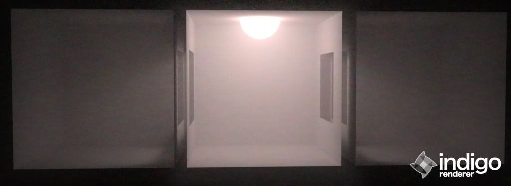

Post by Stromberg » Mon Jul 06, 2009 1:44 am
Seams like it wasnt of any help :P
Well here is a motion blur test, and one volumetric light test.

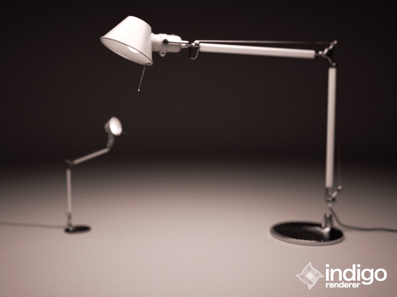

Post by Stromberg » Thu Jul 09, 2009 7:44 am
Tolas asked me if i could render he's lamp with indigo. He seamed to like it :)
Hope you will aswell :wink:
(Remember model not buy me)
Re: Render Book(Stromberg)
Post by PureSpider » Thu Jul 09, 2009 7:52 am
Advanced version of the Pixar lamps? :lol: :mrgreen:
Post by Borgleader » Thu Jul 09, 2009 8:03 am
Haha that's a cute scene :)
Stromberg
Posts: 693
Location: Norway
Post by Stromberg » Thu Jul 09, 2009 8:16 am
Thanks :)
Yeah, i was aiming for a fun/cute scene :wink:
Close Up:
