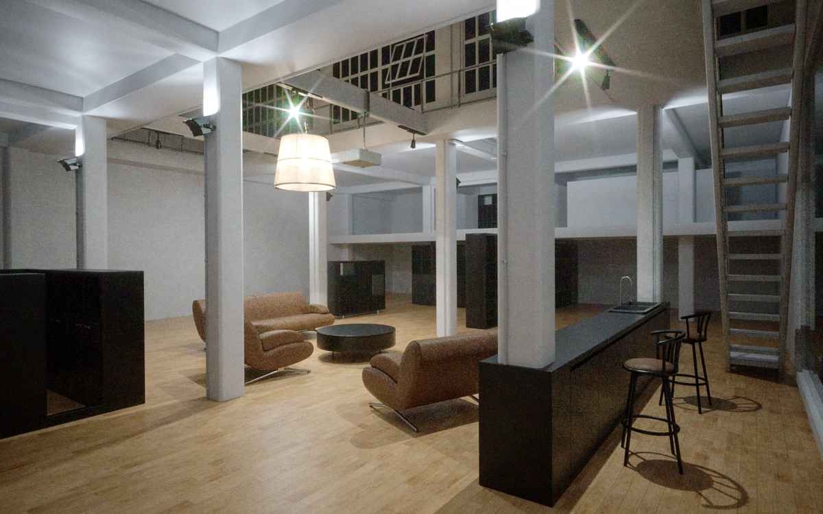

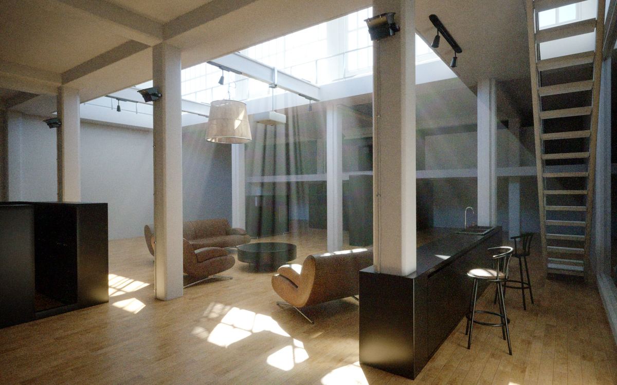

A test of mie_cumulus in an interior "architectural" shot.
The scene is Archinteriors, volume 33, scene 9. More or less apt to this test but I evacuate of accesories objects the scene. The sun and sky system for the first shot and for the second I only apllied a emitter material with IES in the polygons of the bulbs. So, for 5300 samples/pixel with metro bidir (suggested that it is better option path tracing; for other ocation) I feel is enought torture for the machine (I3 , 61 hours, downscaled from 1920 to 1200).

A bit odd, that's simulating a cloud inside your living roomyonosoy wrote:A test of mie_cumulus in an interior "architectural" shot.![]()
Interesting colour banding visible.
Re: A natural situation
Well, that's what happens in a sauna or bathroom in the other hand !
Usually, for rooms, the uniform phase function does the job of simulating dusty air. Nice experiment though !
That's true. Although i think from a sauna/bathroom the droplet size might be larger than in a cloud. Could be wrong tho.CTZn wrote:Well, that's what happens in a sauna or bathroom in the other hand !
