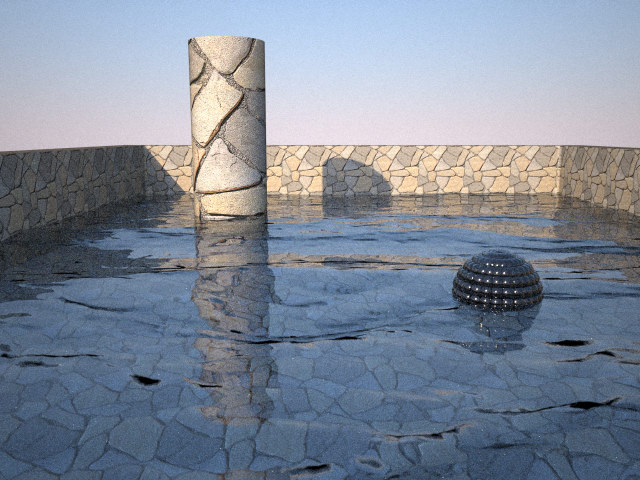

Ono - take a look at the pics below
rendered in Bidirectional MLT mode, Indigo V0.9 test 7
I wanted to point out some issue with Diffuse shading vs Phong with textures.
The cylinder with Phong+textures shades fine, but the other pic with Diffuse+textures shades with a hard edge, which I used to mistake for a smoothing error. If I remove the texture it renders like the Phong version
Is this a bug? Looks it
Apart from the bug, the Phong version seems to have more shading even with an IOR of 1. Is this more correct than using Diffuse for this type of texture?
UV mapped texture tiling in Cindigo is working nicely as you can see
I tiled the textures in cubic mapping mode and then assigned UV co-ordinates to the material to freeze this in place.

- Pool and cyclinder with diffuse + textures. Note the hard shading on the cyclinder
- im1189748972.JPG (90.61 KiB) Viewed 4132 times
- Pool and cyclinder with Phong + textures. No shading problem on cyclinder
- im1189756099.JPG (92.67 KiB) Viewed 4132 times

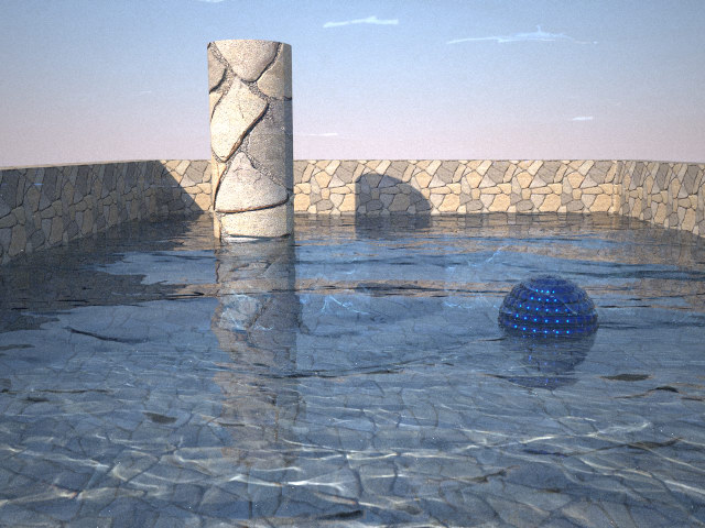

well well the caustics did show up in force around the 650 sample mark!!
With Bidirectional MLT, about 2 hours for me on my P4 3.2ghz machine. A Q6600 quad core would probably show them around the 15-20min mark
Rendered up to 900+ samples here, 3.5 hours and not quite finished yet. They are getting brighter and denser, and more showing up on the wall. They arrived in pretty dense formation even then. Not these little dots I was expecting. I used 100,000 bounces BTW
Ono - something strange though - there are caustics in the sky or maybe it's in the camera?!
A bug I suppose of the new V0.9 test 7 code?
I'm rendering up the other Phong version now and let it go for longer. I don't consider a render fully finished until it reaches at least 3000 samples, and usually I go much higher into the 5000-9000 range
I keep seeing new things all the way up there too.

Guys it's a shading bug I mentioned above....matsta wrote:wow the water looks great dude! dig the spere ball. the pat is very nice. only crit is that the mat on the cylinder is showing its mid line. perhaps rotate a bit so its not showing
greetz
Look at the Phong version with the black sphere, no shading problem there
It only happens when I use textures with diffuse material objects, when I remove the texture it shades like the Phong version. I'll make a formal bug report and show it better with a scene file as well for Ono.
Now I'm rendering the Phong version with the black sphere, which uses Inpox.nk, and the caustics haven't even started to show at the 1000 samples mark...I guess there is a lot of luck involved
Still I can't believe the speed difference, there is almost no point using plain MLT anymore, as it's not much faster sample count wise and with lots more disadvantages accuracy wise. Hybrid in either version is so slow now in comparison
I'm pretty sure it's a universal bug - but I will try sketchup to be sure
now that other render has been going for 4.5 hours more, at 2786 samples, and no sign of caustics...
I have restarted a few times to get new random numbers. If nothing showing by the time it hits 4000 samples, then something is wrong!

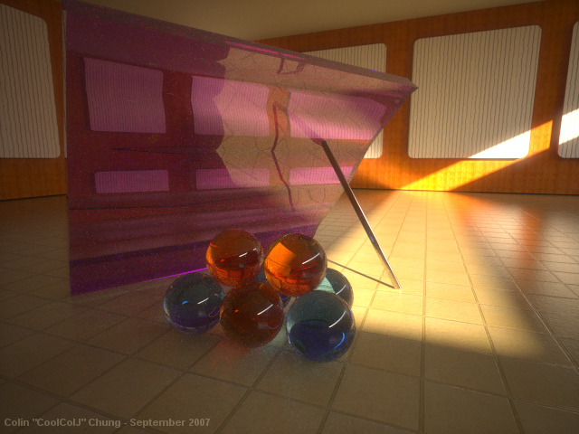

The glass spheres render after some 20+ hours!! 3000+ samples now
Very very slow, gonna re-render it in V0.9 test 7 in larger size, the speed increase and better Specular/SSS material will help
Exit portals and this much glass is always a killer
so far it looks like V0.9 test 7 is getting all the tiny details in the glass spheres, much much earlier in a larger resolution!!
