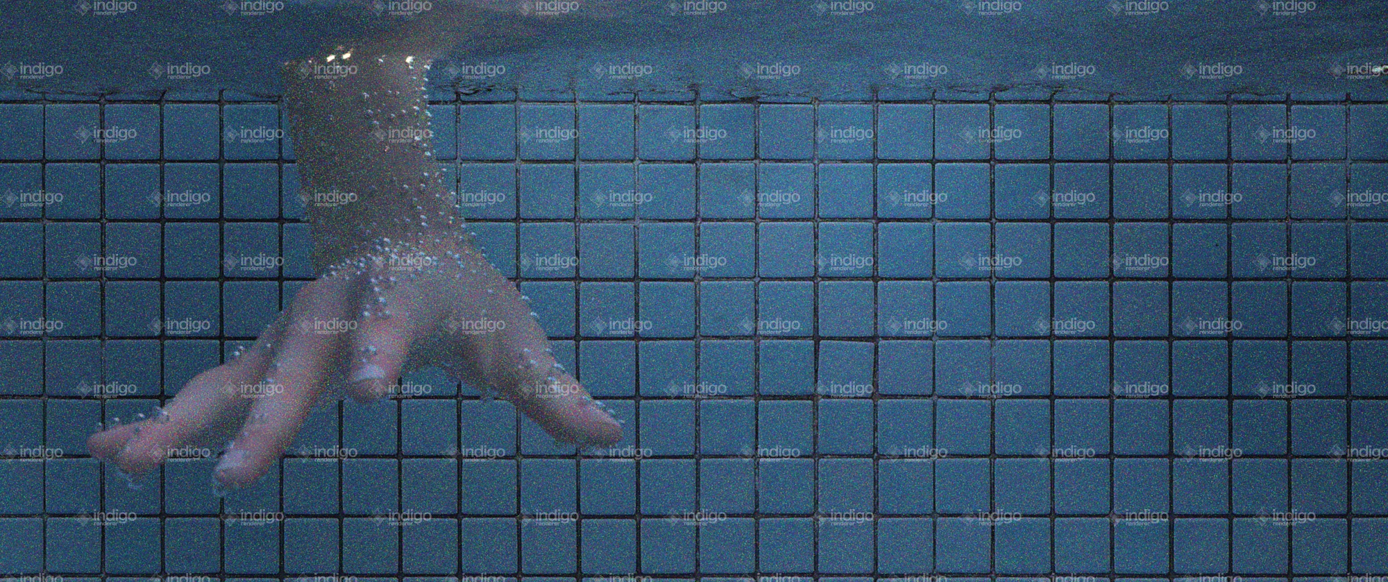

An underwater test scene. Basically, a square kilometer pool of 600 meters of depth.
Starting with it ...

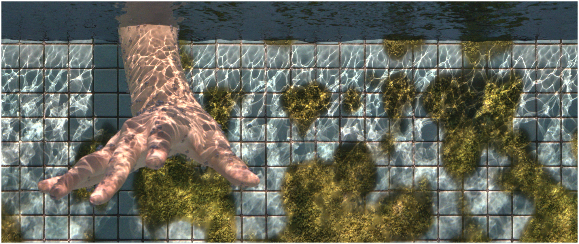

Finally the mesh resolution in "caustics over white" is fixed. The thing is that the ocean surface simulator of houdini has a resolution parameter too. Now is well balanced an looks very interesting. I will let render it till a good convergence point. Bubbles are out (they are correct but don´t has a good visualization impact).
:D Happy if you like to include it into the gallery. Technical gallery, I suppose ...
Thanks anyway. Maybe 2 days of process. See you all, thanks.

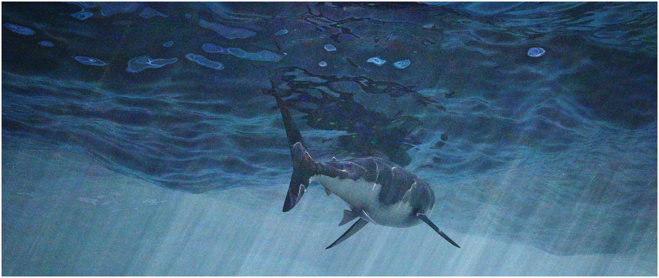

That shark looks really promising... :shock: 8)

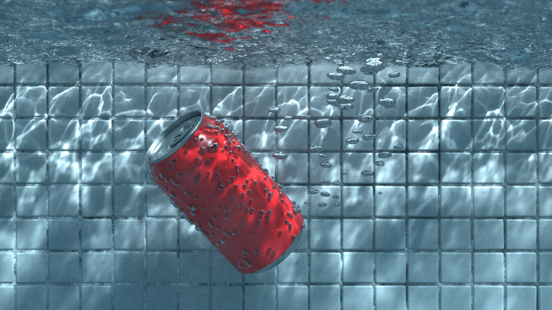

Ending up with this.
Zom-B is right about normals (was limited to 80º, but still a little odd in the top).
Oscar is right about boubbles (the shadow inside of them are not trully). For this an arch glass material was used.
A little tip for MLT. For this lasts images problems with convergence was founded raising the value of large probably of mutation. Another focus could be decrease the value for maximum rejections (with a value of 500 instead of the preseted value of 1000). No fireflies and the best convergence possible with the preseted values of 0.4 and 0.01. This one has 4.5k samples pixel instead of the one of 8k of the last day.

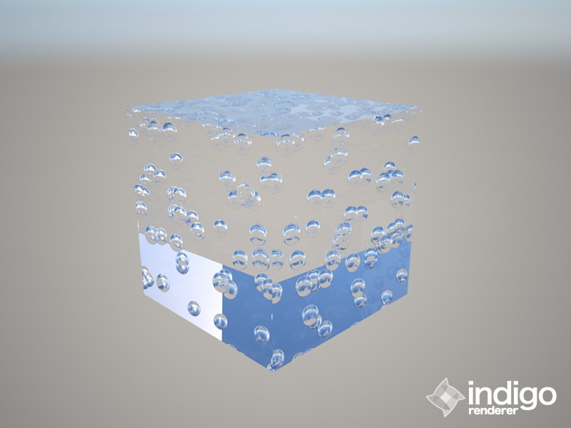

I was really curious what prevents the in my opinion realistic behavior of the air bubbles. So i also did a test. Sorry for ripping off your scene. I only will post it here :-)
Seems like its just a really really hard thing to render.
You can see caustics begin to catch on at the intersection of the bubbles and the bottle. But they would need a really ling time to clean up. So I suspect these kind of SSDSS (Specular, Specular, Diffuse, Specular, Specular) pathways are not something the render takes lightly.
Can in water
Render Method: MLT BiDir
Resolution: 1920x1080 px
Rendertime: ca. 30min

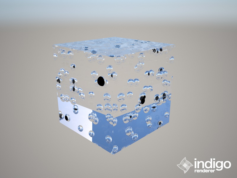

This is a shot with path tracing bidir. Surprised. Some caustics are expected...
But the bubbles look realistic. Now I`m able to recognize they...
So the resolution for this pic will rest till the 4 version is out and I`ll give it a chance with photon mapping.
Raphael, can you explain the procedence of the meshes (air-water) in your test? Seems a little simulation. I like very much the behaviour of the water surface at the top (is only a mesh?).
Thanks for all.
Oscar, thanks again. Are you sure that kklors use PT for this pool? Maybe I have a strange condition in the scene...

yonosoy wrote:Hi Silverwings.
Thanks for your curiosity, your time and your explanations.
Thanks for all.
The Water is just a cube surrounding the scene. The camera is inside.
The Cube has a Water material (Specular IOR 1.33) with some SSS and Absorption to get it a little bluish and a little foggy.
Attached to the air bubbles is a nother specular material this time with IOR 1 (for air) that also has a higher precedence then the water.
I also tried combining the mesh of the bubbles with that of the water and inverting the normals of the bubbles to the inside. It gives the same result then with a air material and a higher precedence.
The "waves" of the surface is just a mesh deformer and a highly subdivided mesh. I did not simulate anything.
I hope that answers the questions ;-)
Cheers,
Raphael
