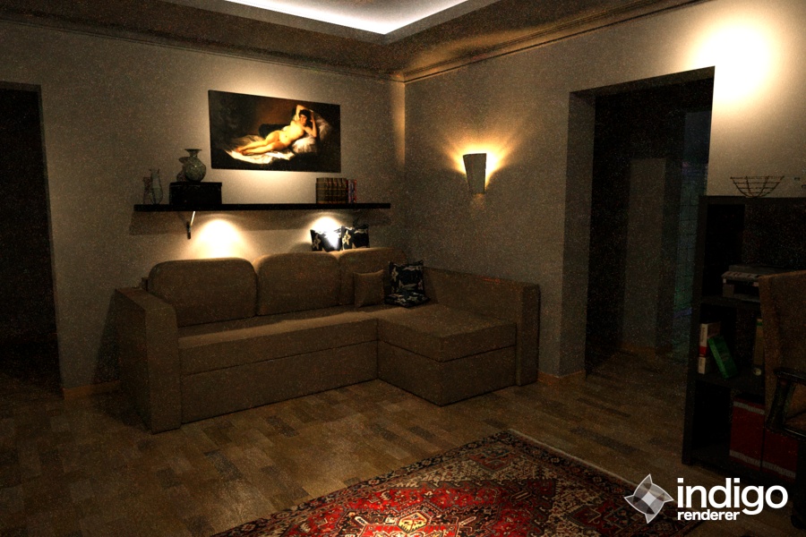

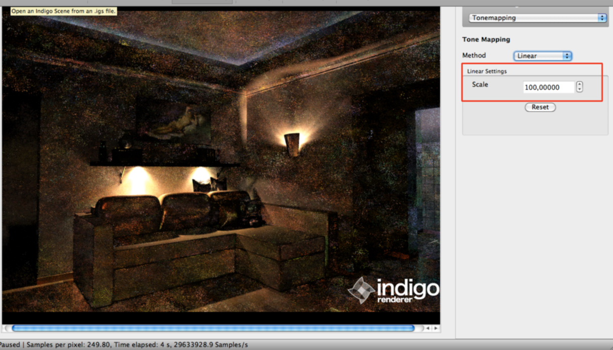

I did try MLT alone. Gave me a different result. Now I'm thinking my light setup is wrong.
It looks very right when using linear tonemapping (10x), but it's too dark. When I use Reinhard tonemapping, the result looks overpowered. Look at the nice IES lights when using linear.
I have to use linear with factor 100 to have likely the same illumination as with Reinhard.
Next I'll try to boost the gain of the lights. Any other ideas?

EDIT: Boosted the lights / no difference. But as I mentioned above, it is probably not a good sign when I have to power linear tonemapping by 100, isn't it?

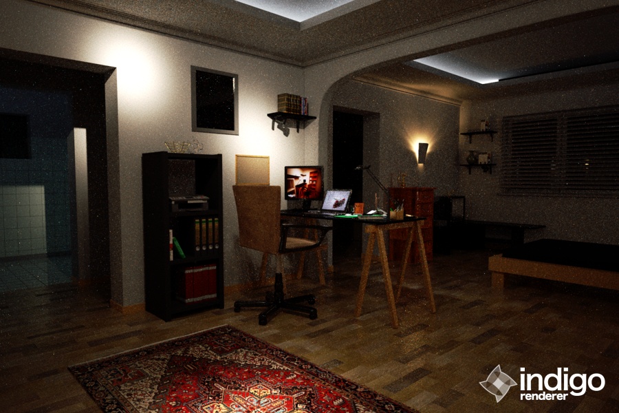

Experienced with different lamps, still MLT only (BiDir off). Tweaked 'Exposure' in Blendigo, and had some repairs on geometry.

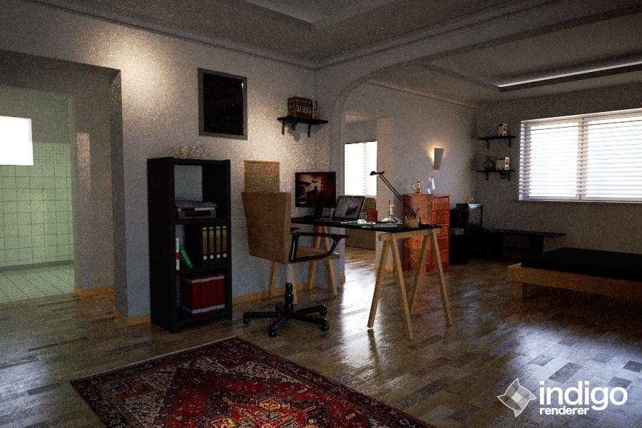

Hello,
just for completeness, here is the result. One of my major faults was to leave 'autoexposure' on. I pushed that to 1/15 and adjusted the lights, so I don't have to use that ridiculous tonemapping scale. Now the picture looks a bit boring, but anyhow, I will add some more things like a table etc.

Hey Pow,
in general I have to say that I for myself have a lot of problems getting IES light adjusted right.
For me its always way to bright and after lowering emission scale its way to noisy, so my workarround is rendering it with layers and the setting the light layer master gain down to ~20%.
With this method you can use other tonmapping settings that brightens up the room more and keep the "overburning" IES light Issue down!
This simply means that you adjust master gain in light layer, having a direct visual feedback of your lights, the you adjust your light material in the 3D application. If lowering the Light layer to 15% looks good so lower the luminace scale for the material for the render in the 3D app to 15%! By this you save time adjusting your lights, thats the whole ideaZom-B wrote:The best way here is to use LightLayers to adjust the light power, and then transfer this knowledge to the light setup and render the final without LightLayers ( => faster)
