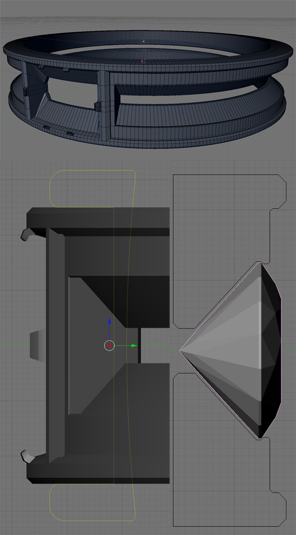

Post by WytRaven » Mon Jul 06, 2009 5:22 pm
Ok so I have completly remodeled the silver inner ring.
I decided to do some decent research of jewelry design and in particular setting design before going ahead and discovered a couple of things worth noting.
  • Faceted translucent gems of any resonable size are always mounted with open backs
  • Strips of faceted translucent gems are generally set in slots or in raised claws
So taking these things into account I completely changed the design of the inner ring. I increased the size of the diamonds and therefore went for a single strip instead of three as creating three slots would have made for a ring that couldn't really be physically made; the silver would get too thin.
Despite the open back principle above the double ring design doesn't really allow for it so I have provided plenty of room in the settings for light to get in behind the stones instead where it can reflect off the inner part of the gold outer band. I also slightly increased the radius of the bevel on the inside of the gold band, but only very slightly as when looking at my wedding ring the bevel is very small (and no it doesn't hurt me :lol:)
The one last tweak of note is with the diamonds themselves. In the test render for the floating glass setup the uniformity of the diamonds sticks out like a sore thumb so each diamond in the new design has been rotated along it's axis somewhere between -1.5 and 1.5 degrees.
I said I wasn't going to use the floating glass technique again but with a little tweaking I managed to get it to perform at a reasonable speed and the double reflection has actually grown on me so I am rendering the new ring design against floating glass.
In the meantime here are some shots of the new ring design. There is a cross section of the diamond slot, a cross section of the gold band, and total shot showing the claw mounts for the three primary stones.
I tried to keep the claws small and unobtrusive as claws and raised settings are more of a feminine thing where this ring is supposed to be masculine (I'm not sure the masculinity has been preserved unfortunately)

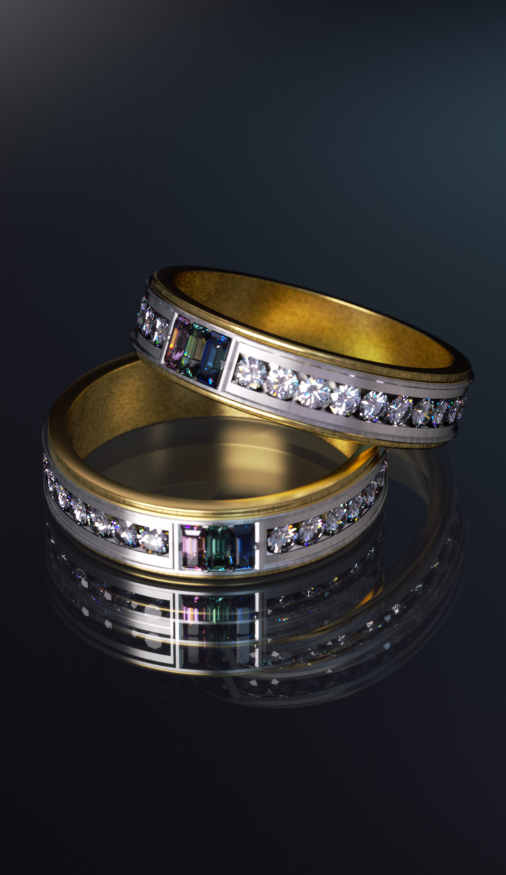

Latest test of new design. Just need to do the texture mapping and re-render and it's about done I think.

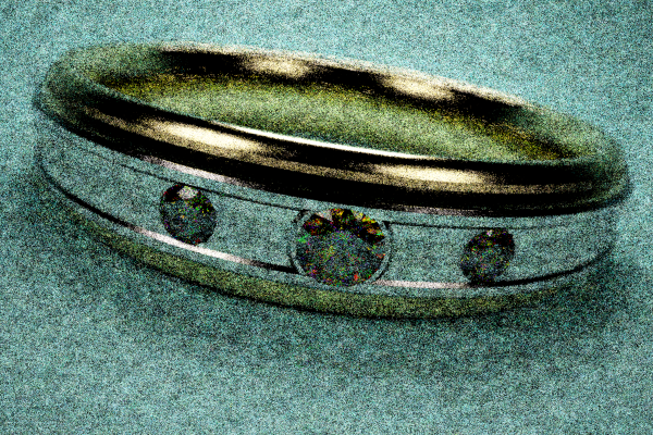

Post by suvakas » Tue Jul 07, 2009 2:24 am
Is there a texture map with a noise pattern on the inner side of the ring ? That kind of noise looks a bit like Vray rendering artifacts caused by a low irradiance map settings for glossy reflections. Brings down the visual quality for me. Has a biased feel or smth.
WytRaven
Posts: 905
Location: Dubbo, Australia
Re: The Renderer's Rings
Post by WytRaven » Tue Jul 07, 2009 2:34 am
No this is without any texture mapping. It just hasn't converged fully yet. This is at ~10K spp.
EDIT: (Well I certainly hope that's all it is and not some weird artifact....I just noticed a distinct pattern in the noise...)
