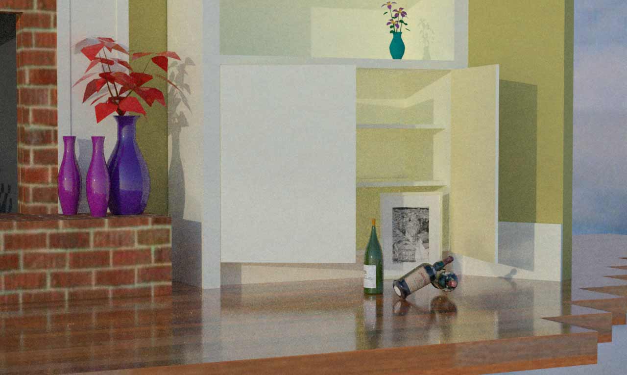

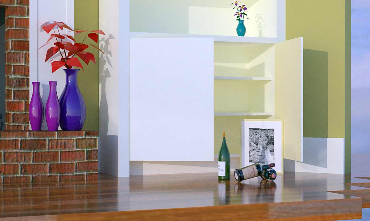

Skindigo Begin-OR
The first scene settings are identical to the last full scene above. The only thing done was to move a few things around (I see I have a bottle floating) and then zoom into a specific area. The Skindigo Render Settings Output was set to View. The render time was 3 hours.
1-Nothing done in PhotoShop except reducing size by half and Save for Web.
The second scene was of the same area with the settings shown below.
Skindigo Render Settings Output was set to Width 800, Height 600 but it jumped to “View” 1280 x 765
All SketchUP default except for the following:
1-Lightened the scene just a little
2-White Balance F2
3-Brick: SketchUP Bump .05 (is it still to much and would displacement be better)
4-Floor: Phong, IOR 1.2, Preset Car Paint, Exponent None-500 (should I use bump)
5-Glass vases: Phong, Preset Car Paint, Exponent-None-60,000
6-Picture frame: Phong, Preset Shiney Plastic, Exponent-None-30,000 (how can I get a glassy appearance)
7-Red Leafs: Defaults were left at Phong, IOR 1.22, Exponen- None-9853
8-PhotoShop: reduced size by half, did an auto-level (which did a lot), sharpened 60% with Unsharp Mask, Saved for Web, then saved as a jpeg which I saw suggested for the forum elsewhere.
9-Render Time 24 hours
2-White Balance F2
- Attachments
- CloseUP-24hrs.jpg (58.52 KiB) Viewed 6300 times
- CloseUP-3hrsA.jpg (56.25 KiB) Viewed 6302 times

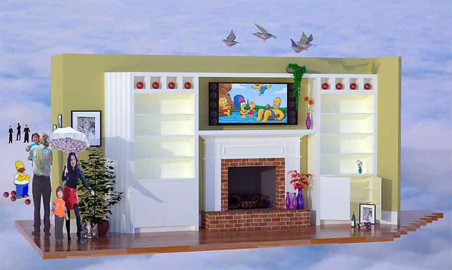

At my level of knowledge lacking just about any basic tut COULD help. I have made a list for consideration.
1-Based on what can be seen in my last +- 24 hour renders there are surely a multitude of observations that can be made regarding specific details that need serious attention. For example, until the mention of bump and IOR I had not given consideration to either. Now I have a little feel for both. I did a bump test, for brick, in the Skindigo Material editor using Bump-SketchUp-20 and whoooa the brick screams out. In the latest render I used .05 instead of 20 and the brick settles down however something less than .05 is probably even better. Based upon CTNz’s mention of displacement I can see that needs to be studied at some point. A simple suggestion (tut) for me may be nothing other than a how to showing what to do back in SketchUP for better results before even beginning a render. For those who have experience with rendering such tuts will be very elementary and boring, But, for someone like me, that knows nothing, the most basic-good start- tuts related to one scene are very helpful. I am trying to cram the learning of a little SketchUP (SU) and a little rendering into one small gob.
2- Color balance, can’t seem to get the ivory cabinets/trim right and brightness correct and image sharpness. I am not doing to well in that area either but maybe that is just naturally a PhotoShop’s job which I used this time with Auto Levels.. Some of this may be due to lighting or color back in SU. Not sure much Indigo should be expected to do. Maybe it is the lack of refined layer, white balance, tonemap slider adjustments or because aperture diffraction is not engaged. Maybe the render time is not long enough or perhaps, no matter how long the render time, a bit of work needs to be done in PhotoShop to bring a render forward a little further. I assume all of the above apply but at this point in time I can’t figure out how to get the best big picture before zooming in to maximize the details. I feel reasonably certain that my scene is probably not the best to work with. But, I am certain that Indigo can do a very good job if I give it respectable information to work with. I am not to impressed with what I have given Indigo but I am very impressed with what it was able to do with the information given.
3-I think one of my biggest problems, amongst many, right now is how to work with all the settings available. I assume that within Indigo that some settings are applicable to SU (others perhaps more applicable to Blender, Cinema 4D and such) and some are not. For those settings which are most applicable to SU (are there any?) how are they best used. Should one start with .05 or 60,000 for a specific material. I would like to add a little gloss to the trim and maybe the cabinets but Phong and car-paint just dosen’t seem right and the render wait for small changes could mean no sleep. Not sure if the floor should have a little bump or if displacement would apply here.
4-A tut regarding how to take something, for example brick starting in SU, and setting it up properly with settings there then rendering it and refining the settings in Indigo for a certain period of time then doing whatever might be considered normal in PhotoShop in order to get a reasonably good rendition of what should be expected seems like a good tut for me.
A tutorial that would take a project from SU to completion, including work in PhotoShop (if that is typically necessary), would be really good for a beginner like me and perhaps many others. It could be a very long on going post like the “Simple Rendering Thread”. A lot of folks would surely come out of that course knowing how to handle settings and render pretty good. Maybe a thread for different kinds of scenes such as interior, exterior, objects etc. Could even be one for Beginners, Intermediate and Advanced. Heck, everyone might want to just quit their day job, stock up on food/drink go on welfare and make Indigo a career. I am not suggesting that for my project but for A PROJECT of someone’s. Maybe many people working on the same PROJECT showing how they do or do not do things correctly or would do things differently is a thought. Maybe I should get out of here and write a book. Nay, don’t a naw ha ta rite ether.

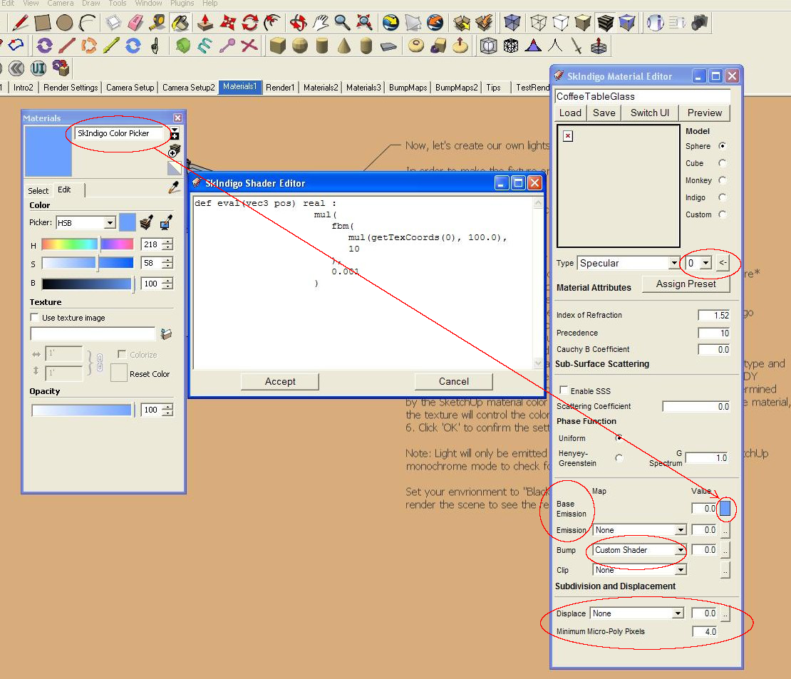

OTHER:
In my look arounds I happened upon a screen exhibited by Whaat and shown below.
http://www.indigorenderer.com/joomla/fo ... c&start=90
Is this in a current release? If so, what does one do to bring up this screen? I see controls such as Cauchy B Coefficient, Enable SSS, Base Emission etc. and I see mention (understand nothing) of such around the forums but have never seen this screen in Skindigo.

Pibuz,
Thanks for your, everyones, feedback about resume rendering. After all was done (I let it go for 40 hours straight due to fearing a wrong click) I tried the “Resume render from IGI” but I am not clicking something right. I think my slow speed was from MS loading me up with something or something going on in the background for hours later all was operating at normal speed.
You have definitely lifted my sprits with words like “luck” and so forth. I often think I should have been born knowing how to do these things. Another good suggestion from you was about “region rendering”. I have seen that option but never thought about doing what you suggested until you suggested it. I did do some tighter areas as you previously mentioned and can be seen above (but I did it by zooming in not “region rendering”) and let them go for hours to see how they would look. In a previous post you said “Good texture often means no standard/preset sketchup material. All of this given that you know that you can specify YOUR OWN TEXTURE for any SketchUp material. Please, confirm that you know that” and I finally answer. I am generally aware of that option but so far I have only used that which is in SketchUP. I now believe I understand that it takes a good bit of knowledge and testing to do it good.
You mentioned somewhere something about, I think it was, not being into Art. If there is any truth to that statement I surmise that you are and perhaps just don’t know it. That kitchen scene, considering simplicity, composition, light, texture, color and on and on is a work of Art. CTNz mentioned something about Dali-I wish! Dali and Pablo were my kind of guys. They did it their way and were rewarded handsomely, financially, during their time. Poor Vincent, others have sucked up rewards, financially, from his efforts which are not my favorites but are certainly of respectful merit. In Florence Italy (is my recall and spelling correct) some where near the Pontiviccio Bridge I once saw an exhibit of Pablo’s work at the age of about 16 and he had already mastered being able to paint like a photograph but soon choose to find his on method of expression. When I saw that exhibit I learned and really admired his true talent.
Well, it took longer to get back to this than I thought it would but that’s about it for me on this one for now. I think this scene is getting tired of me pestering it and the feeling has become mutual. If anyone has any suggestions, especially about settings, please pass them along for I am going to try another one along the same line and your suggestions will be helpful. I want to thank everyone for the very helpful suggestions offered which contributed greatly to making this scene a lot more than what it was at the beginning and could have been on my on. I have learned! This scene could certainly benefit from a masters touch and become much much better. If anyone would like to dance with this scene I will post the parts I have some where for downloading. Below is information about this latest render.
These seem to work very well together:
Indigo v1.1.18 (Really like the larger preview screen and other additions)
Skindigo v1.1.16
Other: (Settings from within SketchUP-Skindigo Material Editor unless otherwise shown left at defaults.
Render Settings: W1280, H1024
Picture frames: Type-Phong, Assign Preset-Car Paint, IOR 1.25, Albeto-SketchUP, , Exponent 5000
I wonder if more render time or a phong change would have created some shine. Maybe a chrome or gold frame would bring out such.
Picture & mat: Type-Phong, IOR 1.25, Albeto-SketchUP, , Exponent-2000
I wonder if more render time or a phong change would have created a more glassy appearance.
Brick: Type-Diffuse, Albeto-SketchUP, Bump-None .015
Does it need more bump?
Wood Floor: Type-Phong, Assign Preset-Car Paint, IOR 1.2, Albeto-SketchUP, Bump-None .0012, Exponent-1000
Does it need more bump and less gloss?
TV Screen: Type-Phong, IOR 1.25, Albeto-SketchUP, , Exponent-2000
Glass Vases: Type-Phong. Assign Preset-Car Paint, IOR 1.72, Albeto-SketchUP, Exponent-60000
Not as glossy from a distance as I thought they would be.
Ledge Planter: Type-Diffuse, Albeto-SketchUP, Bump-.015
Floor Planter: Type-Diffuse, Albeto-SketchUP, Bump-.015
Birds+Cats: Type-Phong. Assign Preset-Car Paint, IOR 1.72, Albeto-SketchUP, Bump-None .0012, Exponent-15000
Red Balls: Type-Phong. Assign Preset-Car Paint, IOR 1.72, Albeto-SketchUP, Exponent-60000
Clouds: Type-Phong. Assign Preset-Dull Plastic, IOR 1.33, Albeto-SketchUP, Exponent-300
Is phong appropriate or should anything be done
People: Type-Diuffuse, Albeto-SketchUP, Bump-.0012
Should anything be done?
Base Type-Phong, IOR 1.52, Albeto-SketchUP, , Exponent-1000
Cabinets Type-Phong, IOR 1.52, Albeto-SketchUP, , Exponent-1000
White Balance: F2
Photoshop: Added “Homer” reduced size by half, did an auto-level (which did a lot), sharpened 60% with Unsharp Mask, Saved for Web, then saved as a jpeg.
Render Time:40 hours
I wonder what another 100 hours would do.

Re: Skindigo Begin-OR
I don't think they would matter at all, Blair. This already seems to be neat, so a longer cooking wouldn't add significant details I think.blair wrote: Render Time:40 hours
If this scene hase been useful to you for the basic studies, great!
Now I suggest you try to bring realism to another level and model a "realistic" interior, with sun light, some light fixtures, etcetera. I do think that it will be very important for you. Try to model the small details too and to use nicer textures than the sketch default ones. Try mastering a little more materials, adding some bump and specular maps. I think this could be definitely your next step!
