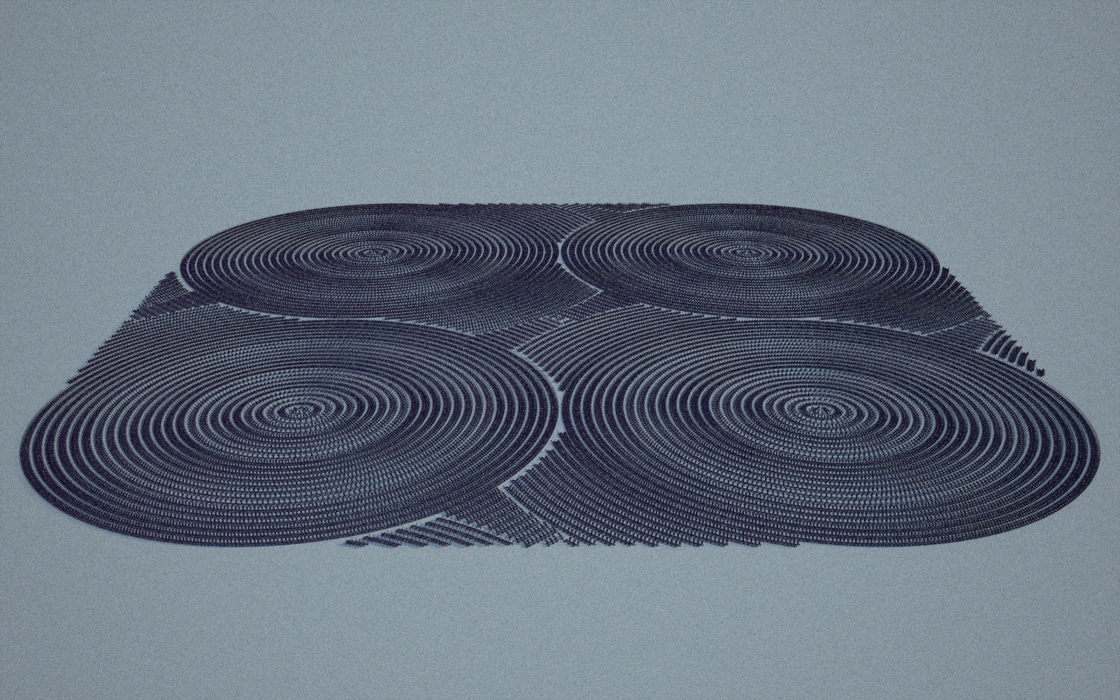

Heres another one that I put together quickly, nothing fancy, just to prove I could do it :D . 26,562 dragons, and 191.7 Billion polygons. My Blender cannot handle any more. It almost took longer to export than it did to render.
They look like crop circles

Post by alexmeyer » Fri May 09, 2008 4:38 pm
Dude..... that's sick.
Awesome render. :D
Post by CTZn » Fri May 09, 2008 5:00 pm
Totally insane.... World record or ?
