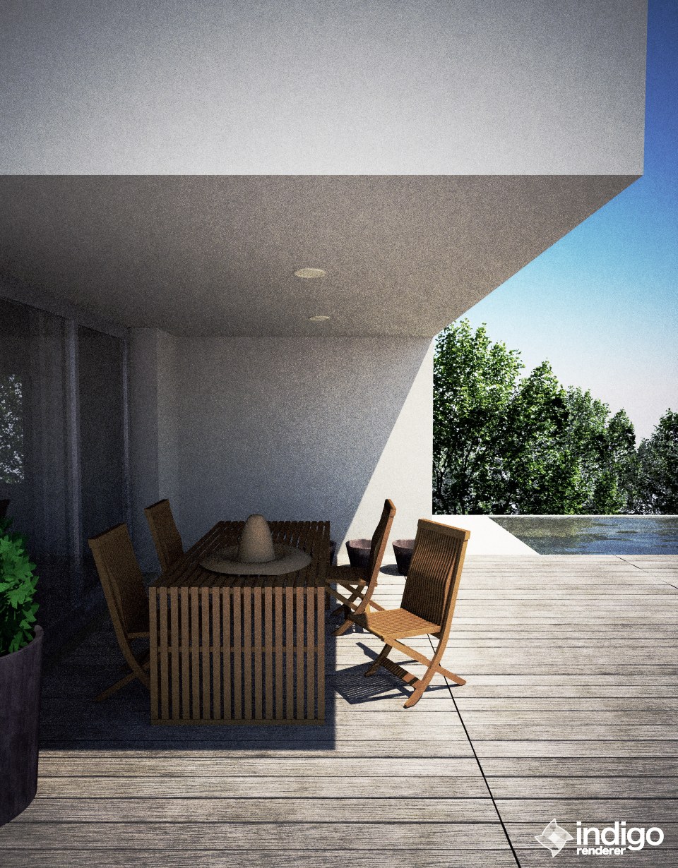

Post by slamdog » Fri Oct 26, 2007 6:34 pm
Little update
little progress in modeling... now i'm angry with the water :x
i've used a specular mat. with 1.3 IOR, Cauchy B coeff = 0, Absorb. color C3EBCD (light green) with gain=0.06 but it seems to be too dirty. :roll:
Next i will texturize and will bevel like sin.
hasta luego! :D
PS:chairs are floating, i know :lol:
Copia di im1193347952.jpg (398.31 KiB) Viewed 3889 times
CoolColJ
Posts: 1738
Post by CoolColJ » Fri Oct 26, 2007 7:54 pm
water is reflecting the sky and environment, especially at that low viewing angle
and water takes a while to clear up when rendering

Post by slamdog » Fri Oct 26, 2007 8:58 pm
you're right coolcolj :wink:
however, how can i make the water more green and bright, like in the reference image. i tried to change the absorption color, but without the desired effect.
i'm in you're hands :cry: (kidding... :P )
Post by Kram1032 » Fri Oct 26, 2007 9:02 pm
use CCJ's tabulated water :P
CCJ, you should post it in the mat thread, for easy DLing :)
CoolColJ
Posts: 1738
Post by CoolColJ » Fri Oct 26, 2007 9:15 pm
if you are using Indigo v1.01
then use this - copy and paste it in place of your current water code in the IGS scene file

if not you can try this
IOR = 1.33
absorption
red 0.36
green 0.04 to 0.1 (higher is less green, more bluish)
blue 0.0143
values are for what they would be in the IGS file, so may need red/blue flipped around inside the exporter if done from there
scattering
red 0.0007
green 0.002
blue 0.0026
Gamma = 1 for both. Gain = 1
and then don't add any bump map to the water mesh and pool surfaces - they slow rendering of caustics a lot!

Post by slamdog » Fri Oct 26, 2007 9:25 pm
ohh CCJ, my savior! :cry: :D
there was not SSS in the previous rendering...
i will post the results.
thank you Kram & CCJ
EDIT: the water surface is simply a mesh, no bump

Post by slamdog » Tue Oct 30, 2007 2:13 am
little update :D
made some texturing to chairs and table and beveled both. Added some detail and background. Added CCJ's water (not the tabulated one... a bit complicated for my knowledge of indigo :( )
Still some problem with bump maps and some materials (like the window frame).
Still have to bevel and texturize the walls.
Opinions? :D
Bye bye

Post by slamdog » Tue Oct 30, 2007 9:45 pm
hi all
new update :D
texturized the whole thing. some problems with beveling (used 1 recursion and it doesn't look like espected on the wall).
i don't know....there's something that doesn't convince me... :x
some technical questions...
i'm using these settings:
LM prob=0.1
Max Change=0.03
Max num cons rej=2000
Max Depth=600
SuperSample=3
low values of Maxnumconsrej speeds up convergence? and can affect the "realism" of the scene?
Other question: there's a way to reduce the render time per sample?
bye bye
Post by Zom-B » Wed Oct 31, 2007 12:06 am
slamdog wrote:Other question: there's a way to reduce the render time per sample?
You are using a 3x Supersample factor :shock:
SuperSample means that Indigo actually renders a picture that is 3 times as big as your output resolution, and then resizes it to your target resolution.
This costs extra time and much more RAM, so reduce it to 1 for your preview renderings to get a nice results much faster, and for your final version 2 should be enough.
You picture is really great, the only thing that "disturbs" me is the tiling on the floor, it seems way too perfect (compared to the original photo) :wink:
here a quick GIF animation about techniques to pimp your bump map:
1:original bump
2: a light wave filter, deforms the lines a bit
3: some gradiants and color changes for the desks, so they arent all perfectly the same size.
4: a light photoshop cloud filter, to generate some overall noise
5: combined with the original bump from the wood
