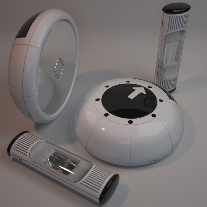

SmartDen, not a real tut, but here's how I went about this:
- Create your model in MoI
- Select the entire model and choose "Export"
- Export your model as .obj
- When the selection window appears, choose the N-gons option (which I find works best, since tris tend to product normals weirdness in Blender).
- In order for the model to look reasonably good, you need enough polys. I picked 5 as a value for this one. But be careful, lower values (meaning higher poly count) can make your object beautiful but way too heavy!
- Now open Blender, and import your .obj file.
What I did then worked for this model, but it might not work in all cases, and it might in part be a matter of taste.
- Since MoI exports every disconnected surfaces as separate objects, I've joined some objects to make the materials assignment easier.
- Once this was done, I smoothed the normals on all the separate parts and gave each of them a edge splitting modifier and reduced the angle from 30 (the default value) to 10.
- After that you only need to assign your mats, et voila!

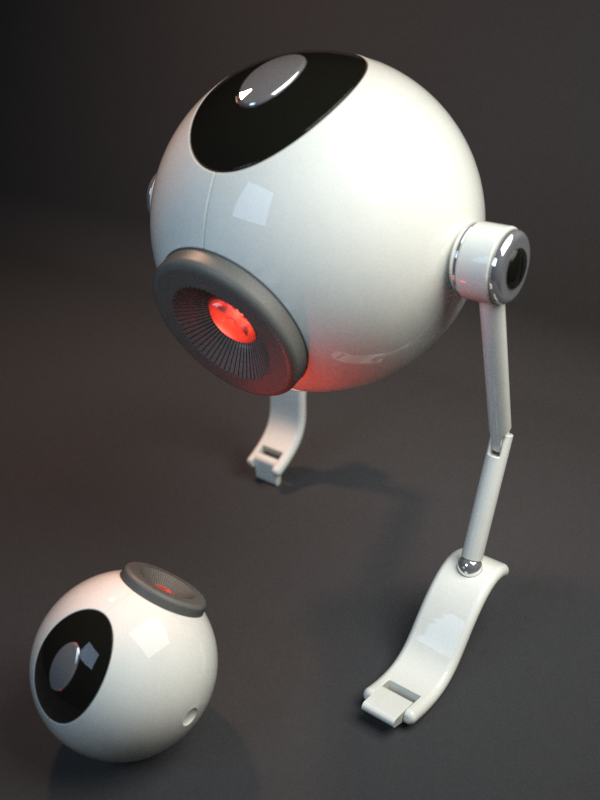

Post by BbB » Fri Aug 03, 2007 7:44 pm
Just having fun...

Post by CoolColJ » Fri Aug 03, 2007 9:04 pm
looks good

BTW how long did the above render take? what rendering mode? system specs?

Post by Stur » Fri Aug 03, 2007 9:35 pm
This last picture is very cool :D

Post by DaveC » Fri Aug 03, 2007 9:45 pm
I love how you post a fantastically composed, full of character picture like that and just say..,
...Just having fun...
:lol:
Post by BbB » Fri Aug 03, 2007 10:05 pm
Coolc: This is an overnight render on a Pentium a 2.8ghz. Quite a slow machine, hence the small format. I used Indigo 08 stable with Metropolis and Bidir and relatively low AA settings to let it clear faster. I'm rendering a bigger version on my monster at home right now (Quad core 2.4Ghz).
Thanks a lot Dave, Stur: "Just having fun" because there's so much I haven't figured out in MoI yet, such as trying to get more organic shapes. This pic is only made of symmetrical bits and primary volumes, which is the only thing I can do right now :D , but working on a new one at the moment, which should be slightly more complex.

BbB wrote:"Just having fun" because there's so much I haven't figured out in MoI yet, such as trying to get more organic shapes. This pic is only made of symmetrical bits and primary volumes, which is the only thing I can do right now :D , but working on a new one at the moment, which should be slightly more complex.
Yep, but simple pictures are often the best ones. Furthemore, your picture is telling a story, it makes people's imagination work, and that is great.

beautiful. unfort. for me, ive been in poly mode too long as well, and it baffles me how to use MoI :oops:
Post by BbB » Sun Aug 05, 2007 9:26 pm
Yes, it takes a while to get used to, and a lot of trial and error to get rid of all the funny normals artifacts when importing into Blender. But the results are so satisfying, though. I love this "manufactured" look. On this one, though, I had to actually extract all the flat surfaces from the models and make them into separate meshes to remove weird dark bands on the render (and I still forgot a few). Ultimately I think it's only worth bothering for objects that would be nearly impossible to model in polys, especially those where you need lots of booleans.
