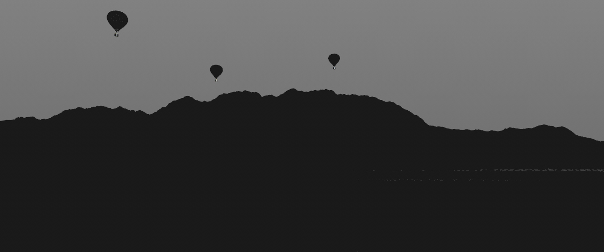

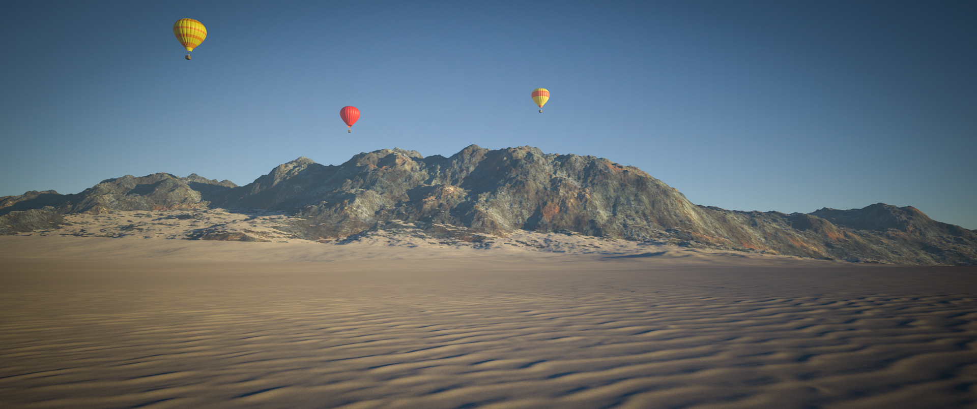

Oscar, in this moments I´m doing another isolation with a more complex cover ground.
The scene has 17.174372.952637 (more than 17 billions?) of triangles in v4.0 eating 16 GB of RAM. I brake the poly count of v3.8.
I retake the first one with Metropolis Pathtracing and performs very well. The color is subtled altered from Pathtracing to Metropolis Pathtracing.

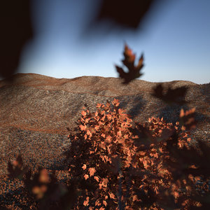

Some years ago I see a tutorial of CMIVFX called fractal terrains and clouds for houdini. Actually I´m generating some assets that could be used inside C4D containing the lessons of this tutorial. Then I´m exporting the trees with SurfaceSpread, a plugin from Laubwerk to C4d and finally I´m instancing some millions of patches of grasss with the internal scatter of infigo. All of this with indigo´s atmospheric simulation. If you need a specific answer do a specific question...
This is the landscape a new exercise, only the landscape, the lake, some trees and some clouds.
15 x 15 km patch, 4000 x 4000 poligons, 80000 trees. Overnight rendering with Metropolis pathtracing (12 hours).
The doom over the lake is supposed to be developed in the future (inflatable structures).

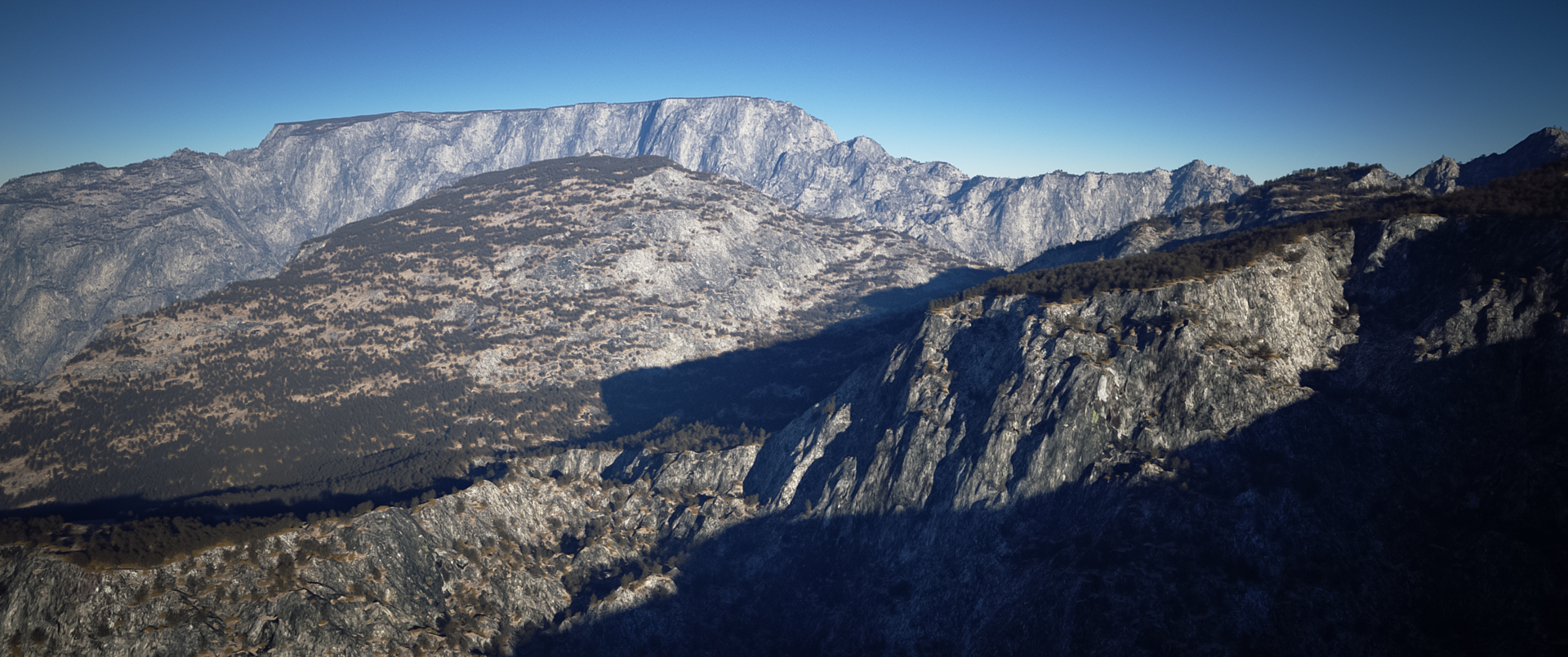

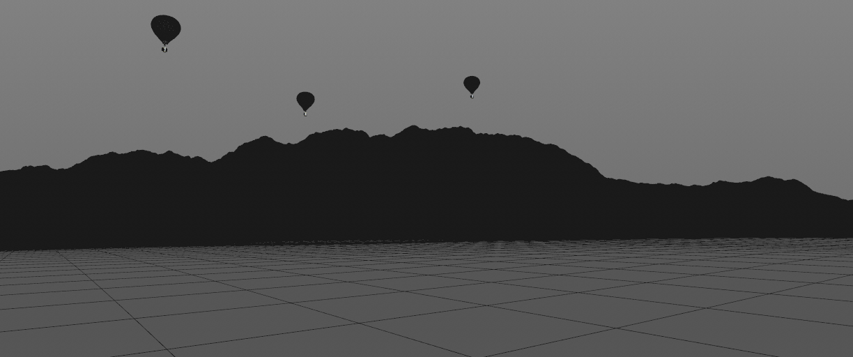

This exercise is a little bit complex. Look at the scrren captures. This is a mesh of 4000 x 4000 quads (32 Millions of unique triangles inside Indigo. As you can see I have enough polygons in the mesh except for the first plane. 7 dependent view subdivisions are enough with a total of 36 millions of unique triangles. I can´t give to the mesh a single global subdivision, so the internal subdivision of Indigo has no use for this purposes. (A new one with only dependent subdivisions is needed for landscapes.) The final take takes me too long because the displacement of the sand takes in account the meaning of slope mixing in the sand waves rock and sand. Finally this. 3h and a half of rendering for 14K spp.

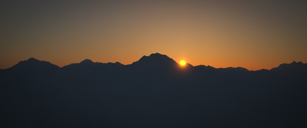

A little experiment. The goal was to iluminate the scene with the sun of the Sky and Sun indigo´s system instead of the extra atmospheric one. They are two different suns.
The sun of the Sun and Sky system is too weak in atmospheric simulation, but with the help of the Sky produces beautiful colors and a warm sensation for aperture difraction.. The true is other, we are at more than 8000 meters of altitude, there is no so much atmosphere in the horizon and the sun brights a lot. Only an experiment. I like the way sun takes yellow tint in low zenith.

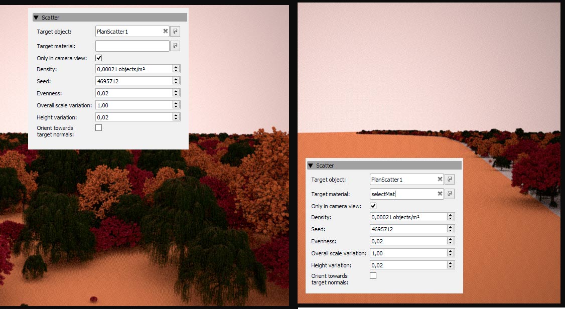

A test with Carbon Scatter. A million of trees in a minute of exportation. Can´t understand it, I figure out that the problem was the limit of Cindigo but that´s not true. There is a bottle neck of any kind with SurfaceSpread.
I will continue the experiments with Carbon Scatter waiting some info about to scatter by material in indigo.

Re: Landscapes
actually you can select a mat for restrict scattering actioninfo about to scatter by material in indigo
